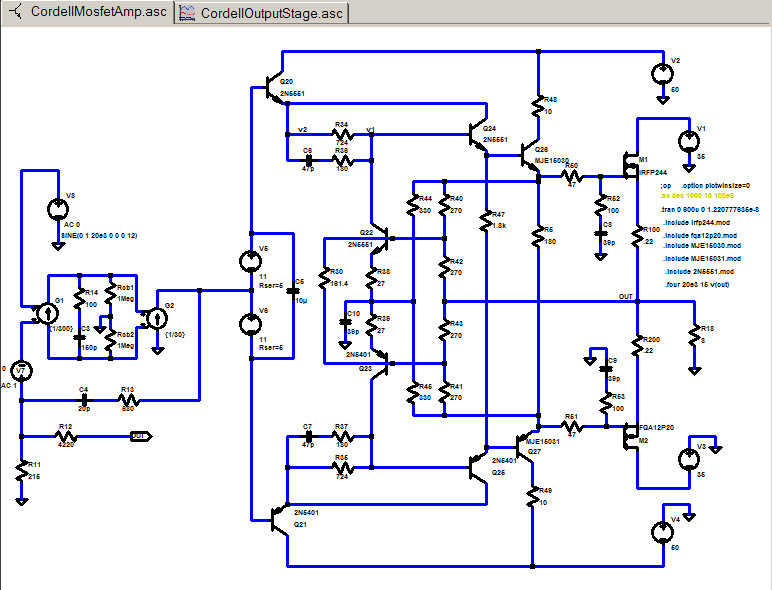

Bob Cordell said:First, notice the collector load resistors to ground on the output of the VAS. This is necessary to establish a known gain for the injected error signal to work with. The need to drive this load taxes the VAS and may cause it to have higher distortion.
Bob
True!
just ran andy_c's sim,
it needs the spice directive line:
.option plotwinsize=0
or turn off waveform compression in the tools menu
another point is that Vsource drive is not nearly the right input condition, the error amp is driven from the cascoded VAS/TIS high impedance current output, with the compensation C4, R13 in feedback around the input defining a frequency dependent source impedance for the error correction stage

Bob Cordell said:You too? You must be of my generation. I learned with Fortran G and WATFOR on an IBM 360 - with punch cards, of course. It was heaven when I graduated to an IBM 370-168 at Bell labs. BIG IRON!! But then there was the Intel 8008 with 1kbit static rams, programmed in Intel assembly language.
Probably close. I turned 50 this year. I'm the guy that was asking questions about your error correction amp article at the RMAF amplifier design Q&A.

jcx said:just ran andy_c's sim,
Ah. thanks for catching that. It was an old sim that I fixed up. I used to disable waveform compression in the dialogs until I later found out about .options plotwinsize=0. I should have caught that.
BTW, in speaking to Bob at the RMAF, I found that he measured the distortion of the output stage by itself by hooking up the global feedback loop to the VAS output. So the zero impedance should represent that condition adequately. Otherwise, some pretty intimate knowledge would be required to get the right impedance for the case when the loop is closed around the overall amp.
changed most part designators to the jaes paper #s
added a voltage dependent current source input stage "macromodel"
it runs, still needs andy's zip files
"Total Harmonic Distortion: 0.000418%"
probably will need the loopgain probe to tell much about the nested loops
more guidance on input diff pair gm is still needed

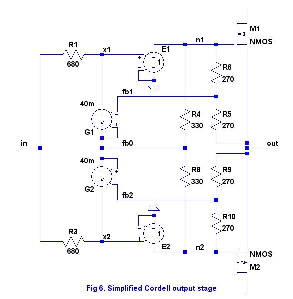

Andy_c wrote:
How about some measurements to help understand how the output stage works? For example,
- gain and phase vs f (eg: 1kHz to 100MHz), input to output with 8-ohm load
- output Z vs f, with Vin (ac) = 0
- input Z vs f, with Zout = 8-ohm
and, feedback loop gain and phase vs f.
To keep it simple, Vin and Vout dc=0.
I've created a simplified diagram (Fig 6) of the output stage to help describe the principle of how it works. The diagram omits biasing and frequency compensation.
You can see it is two mirrored circuits, each being a Hawksford EC. Looking at the positive (top) half first, the voltaged controlled current source, G1, measures the output FET gain error. The error signal is a current and this current, combined with R1, subtracts the error from the input voltage. So in fig 11 of Bob's paper, G1 does the job of S1 and R1 does the job of S2. The modified input signal, x1, is then buffered by E1 before becoming the gate drive voltage n1.
The gain equations are:
v(x1) = v(in) - gm1.[v(fb0) - v(fb1)].R1
v(x2) = v(in) + gm2.[v(fb0) - v(fb 2)].R3
v(n1) = v(x1), v(n2) = v(x2)
Thanks Andy.Okay, here is a sim of Bob's output stage.

jcx said:changed most part designators to the jaes paper #s
Hi JCX
I run your netlist, but obtained a ''multiple instances of flag'' error.
...am i doing something wrong?

Apologies, I got the signs wrong on the gain equations:
v(x1) = v(in) + gm1.[v(fb0) - v(fb1)].R1
v(x2) = v(in) - gm2.[v(fb0) - v(fb 2)].R3

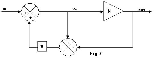

How do we calculate "correction" power? To find out, refer first to Hawksford's model in Fig 7. The idea is that Vn changes to correct error in N. In other words, Vn should change in response to a change in Vout. We make Vin = 0 for this.
In fig. 7,
Vn = a.(Vn - Vout)
Vn.(1 - a) = -a.Vout
Vn/Vout = -a/(1 - a)
When a = 1, Vn changes infinitely and out of phase with Vo. This is the maximum correction condition. It should be out of phase as it is trying to "correct" Vo. But a practical circuit will not work with infinite gain.
Next installment...how much "correction" power does Bob's circuit provide?

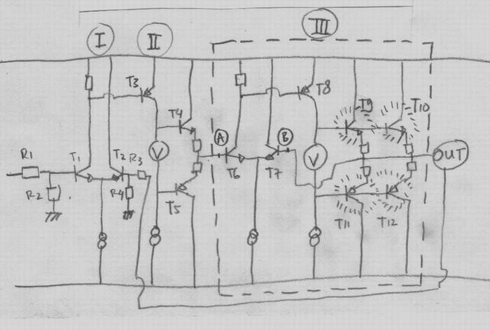

Hi, Traderbam,
Could this be called EC?
I draw a 3 stages power amp (differential, VAS, output stage).
The main function is :
R1-R2 is input resistors. R3-R4 is voltage divider (that set the whole amp gain). T1-T2 (block I) is main differential. T3 is main VAS (block II). T4-T5 is buffer.
The output stage (block III) is another 3 stages amp, consist of differential (T6-T7), VAS (T8) and output stage (T9-T10-T11-T12)
Can T6-T7-T8-T9-T10-T11-T12 considered an output stage with EC capability? The purpose of block III is only to set G=1 (setting point A = point B, no voltage divider at base of T7) ?

Hi lumanauw,
in my opinion, yes. What you have drawn is an output stage with unity-gain NFB around it. Then you've added a front end with voltage gain and put global NFB around the whole thing. In gain structure, this is the same type as Bob's amplifier.
I suppose this could be called various things...
1) An amplifier with output "EC" and global NFB (similar to Bob's)
2) A nested feedback amplifier
3) A NFB amplifier wrapped around a NFB amplifier
I notice the term "error correction" seems to be a popular replacement for the term "unity-gain feedback" when applied to an output stage. I see no reason to restrict an output stage to unity gain. You can choose to apportion the gains between the inner and outer amps to suit your purpose.
