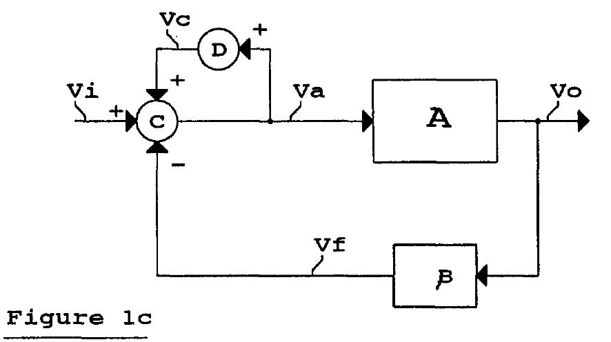

I'm not 100% sure about which topology you talk, but perfect null IS possible with an adjustment. In fact, in my circuit, you can go "throug the null', kind of overcompensate, and the distortion re-appears again but with flipped phase.
Jan Didden
Jan:
It is not really a "null" but a minimum. This is due to the fact the summing node cannot fail to include an active path, thus making for a complex (phase shifting) transfer. So we are substracting 2 non colinear vectors and cannot avoid a non zero result.
Rodolfo
Yep. Consider your fig 1c.
The forward path gain is: Gf = A/(1-D)
The closed loop gain is: Vo/Vi = A/(1 - D + B.A)
The sensitivity of CL gain to changes in A is: S = (1 - D)/[(1 - D + B.A)^2]
You see that the sensitivity to changes in A is a minimum when D = 1. It is positive when D<1 and negative when D>1. This is your "nulling" effect.
But the system has no advantage over a fixed forward gain system. All this does is make you have to adjust for maximum forward gain. Why not just build it with maximum forward gain?
Brian
Rodolfo wrote:
If you do the math, you will find an infinite OL gain because cancellation implies a division by 0, which is an alternative viewpoint. Of course this does not hold in the real world, in fact it is not even possible, which is just fine, for otherwise the concept should be of little use.
So you are saying the concept of EC cannot work in the real world because infinite gain is impossible. Then you say this is ok because otherwise the concept would be of little use. 🙄 😀
Defining "EC" as NFB with infinite gain is not just an alternative viewpoint it is a mathmatical equivalence. The fig 1c circuit IS a NFB loop with infinite loop gain when D = 1. In your real circuit you cannot achieve infinite forward gain without total instability, so you are forced to build a NFB loop with a limited and rolled-off forward gain when D=1. By adjusting D you vary both the loop gain of the NFB loop and its gain margin.
Jan Didden
Yes, the same neat thing happens with my Hawksford circuit when I use the pot. It is a great demonstration of the operation of the EC.
Brian
Brian,
The Devil is in the details of the implementation. If you try to do it topologically as in your diagram with a real piece of high gain, it will not work well, and may likely be unstable. Try it.
Bob
Hi Bob,
Before the argument degenerates into "suck it and see", will you agree with me, or offer an argument against, that your "EC" topology is, in theory, equivalent to an ordinary NFB loop?
I claim to have proven this mathmatically.
Brian

traderbam said:
Hi Bob,
Brian
Yes, I agree, and I've said that before. Just be careful with the word ordinary; some people might not see a NFB loop that encloses a PFB loop with theoretically infinite gain as ordinary. The physical/topological implementation is also not particularly ordinary, either; that is why I said the devil is in the details.
Your really need to get a hold of the Vanderkoy/Lipshitz AES preprint, circa 1984 or 1985, where they showed mathematically that the Hawksford EC could be viewed as a NFB.
What difference do the semantics make, anyway? Where are you going with this? It works, doesn't it? I'm not trying to argue with you, but would like to better understand what the burning issue is here.
