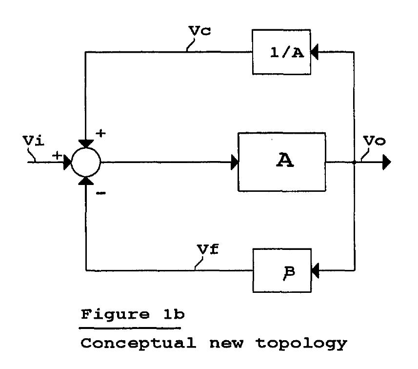

Sorry about this Rodolfo but I feel I should point something out before you publish. Just in case. 🙂 I have thought of a possible disadvantage of Jan's technique over conventional NFB in a practical circuit.
In a normal NFB loop the OL gain is generated linearly before the device being "corrected". In Hawksford's system the forward gain is generated by a positive loop before the distorting device. However, in Jan's topology the forward gain is generated by positive feedback taken AFTER the distorting device.
This matters because any error appearing at the output, which is not conjugated away by the 1/A block, is fed back regeneratively. Distortion is added positively to the input summer. In other words the OL forward gain is polluted by the output distortion.
You need to do the maths, but I suspect that for the same OL gain, a conventional NFB loop will show significantly better distortion rejection and rejection of external noise at the output.
Brian
Brian:
I am not quite sure about what you are talking for I do not have right now at hand Jan's schematics. Anyway the concept is basically to start with a non-ideal plant, and to feed back as error the difference among its input and its (scaled down) output. It is assumed the summing node is at least perfectly linear, though this is not the only constraint and this is the study subject.
Rodolfo
Rodolfo,
To understand you have to think of the circuit as a high NFB system whose forward gain is derived from the 1/A loop. The 1/A loop feeds the output back to the input positively.
In negative feedback the output error is subtracted from the input and this reduces the error at the output (if the system is stable). If the feedback is positive the output error will be increased.
Since the forward gain for this system is created by positive feedback, any error at the output will be bigger than it would have been if the forward gain had been generated cleanly.
I suspect this will also show up as a higher output Z than a conventional NFB system, when both have identical forward gain.
Brian

Ok I see.
Fig 2b is not the same system as fig 1b. Jan has put a positive feedback loop ahead of A to generate the forward gain. Yes, that ought to reduce the problem I spotted in fig 1b. I should have read ahead, sorry.
This is error correction it its pure form
It is also regular NFB in its purest form. Don't take my word for it...measure your circuit's forward path gain. Then you will see.
Brian
Brian
If you do the math, you will find an infinite OL gain because cancellation implies a division by 0, which is an alternative viewpoint. Of course this does not hold in the real world, in fact it is not even possible, which is just fine, for otherwise the concept should be of little use.
Rodolfo
Rodolfo
Rodolfo,
I'm not 100% sure about which topology you talk, but perfect null IS possible with an adjustment. In fact, in my circuit, you can go "throug the null', kind of overcompensate, and the distortion re-appears again but with flipped phase.
Jan Didden
