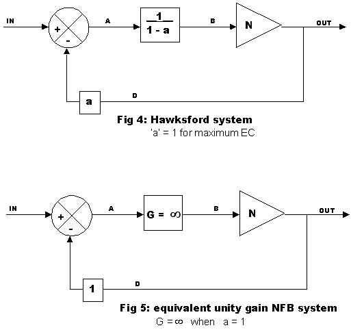

Ok, I'll risk veering on to the pavement with the next diagram. Fig. 4 is Fig 2 with the "null" factor "a" included and I have expressed the positive feedback loop gain as an equation. When "a" is set to 1, as Hawsford EC requires, you get fig 5. I claim the resulting effective feedback is infinite.
Hi Brian,
I agree that figs 4 & 5 are 'infinite feedback'. Fig 4 is in effect the circuit I described in the aes preprint. There is a lot of excess gain in these two circuits. In practical experiments, building an amp according to fig 4, all looks well until clipping. At that point the nfb becomes inoperative, but the pos fb inner loop is still active, so what you see is enormous gain making the output stick to one of the rails... Actually fried a couple of speakers that way.
But, when I agreed that your initial fig 1 and fig 2 are equivalent, that is in terms of results, black-box-wise so to say. I'm not sure whether they internally achieve that result by the same means, or that fig 2 (and therefore figs 4 & 5) are actually equivalent to Hawksford. I'm not trying to split hairs; this is pretty complex for me.

The key thing I want to show is that the functional result is identical to a simple NFB loop. Hence, it is my opinion that implementing the Hawksford diagram node for node is unecessarily complex: it creates the need for 3 inputs rather than 2 and requires "tuning". I don't yet see any point in this.
Brian
You are missing one point:
Classic 'infinite' loop gain negative feedback works with infenitesimal difference signal, which in reality may mean not much higher than noise floor or any disturbace (e.g. RFI?) to differencial signal will matter.
In contrary feedback error correction works with higher level signals and relies on matching.

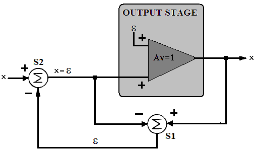

Yokoyama is a similar thing in a different arrangement. He claims that his circuit's output is only dependent on Vi and B and has no sensitivity to the output transistors. That is patently impossible :clown: unless there is infinite feedback involved (eg: perfect pre-distortion) or perfect feed-forward.
Actually, i didn't even bother to read the man's prose: i reckoned, in this case, that the schematics should do all the talking, and they did. :nod:
While Hawksford uses differentially driven single BJTs for error extraction, Yokoyama et al use a much simpler, heavily degenerated and, consequently, far more linear differential pair.
Further, with greatly reduced component count, the later drives the TIS's current source in phase opposition to the TIS, thereby effecting the required invasion of the extracted error signal ''e'' shown below.
This eliminates the low impedance drive required by the Hawksford scheme to properly and resistively define the collector loads in his error amplifiers.
Indeed, Yokoyama et al could be readily improved by, for instance, using independent voltage rails of greater modulus than those of the output stage; this would accommodate the compliance of an active current sink in place of the capacitively bootstrapped resistive tail for the error extractor.
Even so, this arrangement is significantly more supply rail-efficient than Hawksford's arrangement.

Can you show me this in the equations? You see, when I look at the Hawksford equations they reduce to a simple NFB system, with high gain. When Andy c and I measure the "difference signal" loop gain in his Spice circuit we get high gain: meaning a small difference signal will cause a large output change.

I beg to differ. In Hawksford ec, you are seeing small differences (the difference between as-is and should-be Vout); the resulting (small) error results in small output changes (to bring the as-is to the should-be).
I am still wrestling with this: in H.ec the small error component gets a gain of approximately (to first order) 1, so where is the high difference gain?

In H.ec you also work with small signals: the difference between the actual Vout and the required Vout for zero distortion. In practise you also at a certain point hit the noise level as a limitation to how exact you can null the error.
