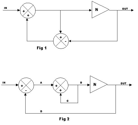

Not sure about this folks: looking at fig. 11, it would appear that the algebraic sum of the error signal ''e'' and the input ''x'' drives the output stage.
In other words, this is negative feedback applied to the output stage's input. Loop gain cannot be very high since it is largely generated by a single transistor.

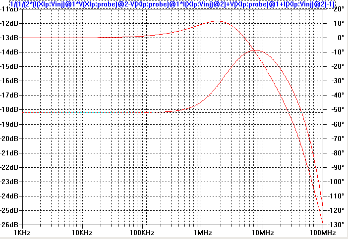

Hi all,
Wow, I was getting some very high loop gain numbers too. I started to question my own sanity. After all, if the attenuations of the voltage divider and MOSFETs are nearly the same (as they are by design), the error signal at the diff amp output should almost cancel, giving a very low loop gain.
Then I realized that there's really two feedback paths - one from the divder and one from the MOSFET output. Unless the loop gain probe is in the innermost loop, some strange results will happen. So I moved the loop gain probe so it's in the innermost loop and got the expected results.

Okay, here is the plot of loop gain. The upper plot is the phase and the lower plot is the magnitude. You can repeat this yourself with the previously posted project by editing the comment field with the loop gain expression and copying the loop gain formula into the output expression for the plot.
You can see at low frequencies that the loop gain is a little less than -18 dB in magnitude. I think this could be made much lower by better matching of the voltage divider ratio to the small-signal MOSFET gain.

andy_c said:[snip]You can see at low frequencies that the loop gain is a little less than -18 dB in magnitude. I think this could be made much lower by better matching of the voltage divider ratio to the small-signal MOSFET gain.
If the divider ratio and forward gain match exactly, the loop gain for the main signal (carrier?) goes to zero. That's what I meant by saying that the apparent huge loop gain (due to pos fb) is divided by the cancellation ratio. My experience is that the closer the forward gain is to the ec return gain, the more stable the circuit is.

Try this. Fig.1 is the Hawksford/BC system. Fig. 2 is the exact same system drawn in a different way. The two are equivalent. That "strange result" you see is not strange at all...your sanity is not in question. You were measuring the loop gain in path D. This is the path that includes the output device - the device that we are trying to "correct".
