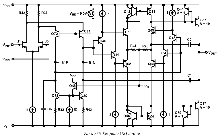

scott wurcer said:FWIW, I think there's some irony to the fact that Edmond's output stage (left one) is almost device for device identical to one used in some popular line drivers for DSL (millions installed).
So some of you might have it right under your noses (so to speak). 🙂
BTW there are passive error neutralization techniques that work and can be shown to not use/be NFB and are "invisible" to the main loop frequency response.
Edit - Of course the bi-polar line drivers do not use MOSFETs, but same circuit with power NPN's and PNP's. Power in this case still smallish but the modulation of quiescent current to peak current is >200x.
Hi Scott,
Indeed, the similarity is striking. If we just add MOSFET source followers behind the output stage of the AD823, we get essentially the same circuit.
Cheers, Edmond.
KSTR said:Edmond,
Not being an expert I can't see the similarities to the AD823. There I see two buffers driving current (push-pull) into resistors and those currents are mirrored into the bases of the output trannies...
- Klaus

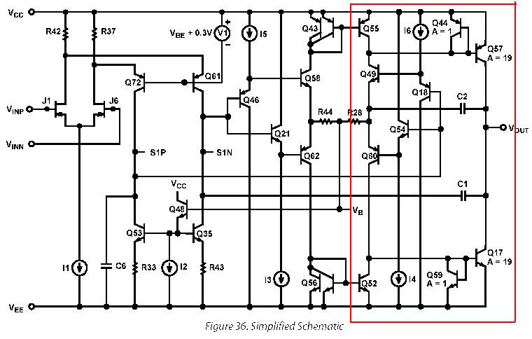

Hi Klaus,
I presume that Scott was only referring to the right part of the circuit, see below.
Cheers, Edmond.
Actually not quite, but you get the idea. I found my AES preprint 1992 #3231 where I show passive (a single capacitor) neutralization of output stage dynamic Vbe error. Real scope photos on a real circuit. At the time I didn't know what a pit of vipers I was getting into. This EC stuff already had a long history and I was challenging the hegemony. I'm convinced it would work on a power amp just as well as either NFB or the HEC circuits. Someone here encouraged me and I might just build one when my plate is cleaner.

http://www.eeproductcenter.com/rf-micro/brief/showArticle.jhtml?articleID=202802714
enough dsp horsepower could run a good model w/online identification and multiple measured inputs - Vds,gs, Is, Vps, case,heatsink temps and calculate a predistortion V for the output stage of audio amps too
everybody talks about linearizing before applying feedback
how about Real error correction:
- Bob Cordell Interview: Error Correction
