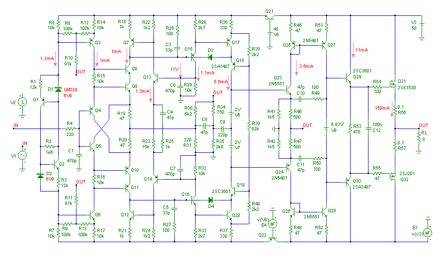

Non-HEC-amp
Hi Bob,
Is it really that hard to get my point? It doesn't matter what you know, the point is what the EC point of view (without any knowledge of other points of view and practical experience) has to offer. Never mind, so let's go to business.
Here's the simplified schematic of my amp with the NFB output stage. As you can see, the input stage as well as the output stage utilizes current feedback and the bias of the symmetrical VAS is stabilized by a common mode control loop (Q7,12,13,14)
Just as in your design, the 'Miller' compensation is applied between the VAS output and the inverting input of the IPS.
Despite the fact that a CFB IPS is faster than a LTP, also in this design it was necessary to add one more pole and zero (C3,R26, resp. C5,R27) to get the front-end stable.
As we all know, the Early effect isn't accurately modeled by most simulators. So, to be on the safe side, I've eliminated this effect completely by bootstrapping (R10,11,etc,) and by using CF cascodes (Q8,11,18,19), Maybe it's superfluous. OTOH, the added cost is virtual nihil. BTW, the THD20 of the front-end with this arrangement is only 10ppb.
The TMC network consists of C9, R35 and R35.
And here are some key figures, where Fc is the unity gain frequency of a loop, PM the phase margin and GM the gain margin.
Output stage: Fc = 2.9MHz, PM = 76 deg., GM = 26dB
Global FB loop: Fc = 900kHz, PM = 87 deg., GM = 21dB
Miller loop: Fc = 9MHz, PM = 73 deg., GM = 6dB
CMCL: Fc = 350kHz, PM = 64 deg., GM = 45 dB
TMC: Fc = 1MHz.
Slew rate: 200V/us.
THD20 at 50W: 0.65ppm, at 100W: 0.9ppm (into 8 Ohm, BW=100kHz)

Hi Bob,
TMC: Fc = 1MHz.
Slew rate: 200V/us.
In the next posts I'll show the distortion spectra and the (slightly) improved step response.
