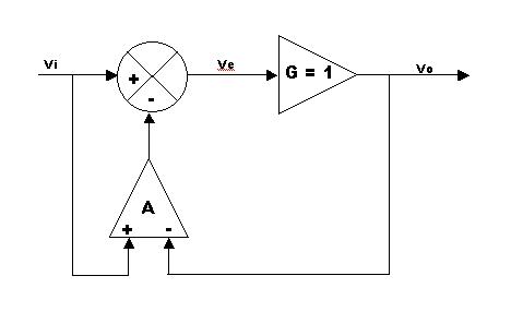

Andy, I misunderstood your original point. In your example, I think what you are saying is that you want the OS NFB loop to become benign above 1MHz leaving the original follower to operate up to 10MHz unity-gain bandwidth. Ok.
But I don't see why this cannot be accomplished in a single-loop NFB system. Again, imagine a unity gain follower with bandwidth 10MHz. You insert a gain element A in front of it. A has dc gain 40dB and rolls off to unity gain at 1MHz. A has unity gain above 1MHz. Subtract the output from the input signal and feed the result into A in the conventional way.
Erratum: that's not quite right. The output of A should be the input plus the difference between input and output put through a rolled-off gain function. So that above 1MHz the output of A is primarily the input signal. Same number of feedback loops: one.
I'm only understanding part of what you're saying. You have a gain block A (presumably with differential inputs?) with a DC gain of 100x and a pole at 10 kHz, such that its magnitude would approach 1 at 1 MHz in the absence of other poles or zeros. But you then introduce a zero at 1 MHz into A, such that the asymptotic gain as frequency becomes large is equal to 1. Then the output stage contributes a pole at 10 MHz. So as frequency increases from DC, you have pole at 10 kHz, then a zero at 1 MHz, then the output stage pole at 10 MHz. Okay so far?
Assuming that's what you intended, I'm a bit confused by the final hookup you proposed. Could you sketch something and scan and post it to clarify?
Andy,
Something like this. "A" has a low pass filter response just like a standard single pole op-amp whose unity gain f = 1MHz. G represents the output follower transistor(s) with 10MHz BW.
Would this produce the sort of response you were talking about?
Edit: Oops...sorry, the summer should have + signs on both inputs.
Andy, you might have noticed that if you were to connect the + input of A to Ve instead of Vi you end up with the familiar HEC topology, provided A = 1. You can see HEC as being an alternative way to generate the gain of A by using a regenerative loop.
I've mentioned in past posts that using a PFB loop to produce forward gain has pros and cons. One pro is that you can generate very large gains at low frequencies. One con is the amplification of any distortion within the loop.
Brian

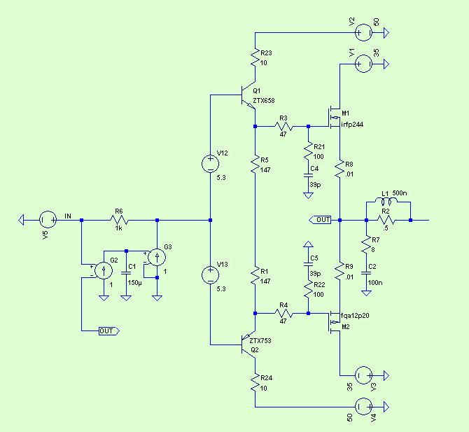

Re: Re: Re: Re: Re: hec != hoax ?
Edmond Stuart said:
Hi Ovidiu,
Admittedly, for an accurate bias generator we need more components, but the same applies to the Hawksford scheme. His simple temperature compensation is only valid in combination with Darlingtons. In case of separate drivers and/or MOSFET output devices, each stage needs their own compensation as they are operating at different temperatures and have (most likely) different temperature coefficients.
Cheers, Edmond.
Hi Edmond,
In referring to "his" temperature compensation above, are you referring to Hawksford's version or mine?
Mine works fine, as shown in Figure 12 of my original paper. The Q22-23 error amplifier transistors set the bias voltage across the emitters of the Q26-27 drivers of the MOSFET gates, so no other junctions are involved here. This is accomplished by feedback action.
In practice, for thermal feedback, I mounted Q22 on the heatsink. This gave just about the right coefficient of thermal compensation. See Figure 4. In doing so, I used an MPS-U06 transistor with a tab for convenient mounting.
There are, admittedly, two things that are sub-optimal about this approach. The first is that often transistors with mounting tabs are medium power transistors with a lower ft that can be gotten otherwise. Secondly, this mounting arrangement on the heatsink tends to increase the lead lengths on Q22 in the error amplifier. Ideally, other means can be used to introduce the desired heat sink temperature dependence, but they will tend to add some complexity.
Bob
