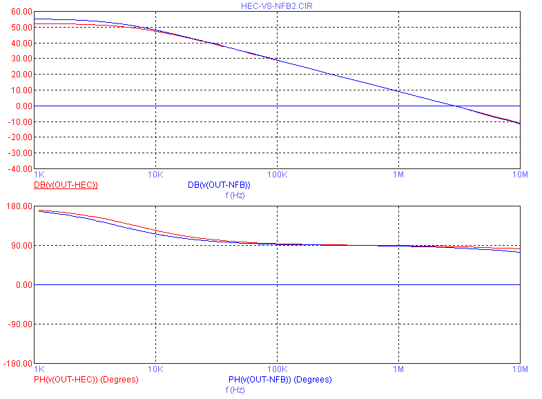

Hi Jan,
No, the amount of correction is not limited by the input transistors (I've checked that), but by the limited bandwidth of the EC respectively NFB circuit. See also:

Thanks. Hmmm...
Jan Didden

Hi Jan,
As I have told already, not all distortion is removed as a result of limited bandwidth of the NFB loop. I would like to elaborate on this subject. Suppose that the THD20 mainly consist of the 2nd and 3rd harmonic, then we could see from the plot below, that the loop gain at 40kHz is 37dB and at 60kHz 33dB (far less than at 1kHz, btw). No matter how accurately the EC circuitry is engineered, mainly these figures determine how far the distortion will be reduced.
Bob reported a 45 fold reduction at 20kHz, that's more than 33 or 37dB. But taken into account that his simulated circuit has 27% more bandwidth, then above figures are reasonable in accordance with his findings.
Cheers, Edmond.

Hi Edmond,
would the anwer to this problem be, in theory, to have a constant loop-gain reserve, that is, adapt noise gain to open-loop gain over a certain bandwidth, for a constant distance? That would through away useful Aol at low frequencies, though... but assumed we had plenty of it?
- Klaus
- Klaus

Hi Jan,
I was referring to output stages in isolation. The schematics can be found here:
http://www.diyaudio.com/forums/attachment.php?s=&postid=1356927&stamp=1195651662
Cheers, Edmond.

Yes, but these 'output stages in isolation' are really more than the usual ops, as they have considerable excess loop gain. In that case, the EC 'automagically' turns into a high-nfb loop (view 3). So, in this case, both ops's performance is largely depending on the nfb which depends on the excess loop gain. Would you not actually *expect* similar performance here?
A more usefull comparison would be an ops with excess loop gain and nfb versus an ops with no excess loop gain and EC.
Jan Didden

Hi Jan,
Just because you don't believe that HEC is NFB in disguise and don't have NFB loop gain, you are telling me that "these 'output stages in isolation' are really more than the usual ops". You really make me angry. I've spent a lot of time to make my point clear, and you didn't even bother to look at the schematics. The ops at the right is exactly Bob's HEC output stage and the ops at the left is the equivalent based on ordinary NFB .
That IS a very useful comparison, don't you think so?

Edmond,
Yes, I stand corrected. I hadn't noted that the circuit on the right has no excess gain. Indeed, it IS a usefull comparison. Apologies.
Jan Didden
