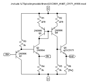

Originally posted by Edmond Stuart
Here is already the schematic:

Hi Ovidiu,
It's pretty funny how many times I've looked at that buffer and didn't get how it applies to what I'm doing. Duh!
There is the answer to limiting current. It is one of the last things I think about in a design - but I still should have recognized this.

Hi Chris,
That's not a current limiter. It's actually a "current supercharger". When the difference between input and output voltage becomes large enough, one of the inner devices will turn on, supplying an increased base current to the appropriate output device, allowing it to drive even harder.

Re: Re: Re: Re: Re: Re: hec != hoax ?
Hi Ovidiu,
I'm sorry to say so, but the internals of the OPA633 don't inspire me towards an even better output stage. As Andy and Chris have already pointed out, The OPA633 is nothing more than a simple diamond buffer and "supercharged" with some additional circuitry, which kicks in if the difference between Vo and Vi exceeds ~0.65V (=Vbe).
As of distortion, this IC performs equally well (or worse) as any other double emitter follower configuration.

Oh, thank you very much for the encouragement. Well, the THS6012/TPA6120A already has some audio reputation (Rod Elliott, e.g.), the inductor "trick" is also known to improve precision of cfb amps (makes a section of 2nd order Aol roll-off with another pole&zero so we have high Aol at LF), and bjt aren't that slow, after all (but a bit more fault tolerant). The main trick that "does it" (and the only thing special a in certain sense) is the floating supplies, after all.traderbam said:I like it 😀😀😀😀 or rather I like the sheer audacity of it. 🙂
Whether or not this circuit can be tamed in practice to avert it form causing a permanent tear in the space-time continuum is another matter entirely, but I like your ideas Klaus. You are using BJTs for a high speed circuit, you are using ICs designed for an entirely different application and you have won me over completely by daring to use discrete inductors in the fb path. Nice.
I now tried discrete driver circuits and even with a very crude cfb "op-amp" design I could manage to get THD20 below 2ppm without much tweaking. The trick was to use the correct polarities, which took odd harmonics down. Re in the schematic (shown is the side for the PNP output) are 620R, a bit unbalanced to tweak the THD, as are the main emitter Rs.
I will open a new thread on this, after writing a nice intro and doing some more real world sims (parasitics, PSU stuff etc)
- Klaus

KSTR said:Hi Edmond,
this last OS looks nice. I tend to interpret it as (sort of) a unity gain current feedback op-amp.
I simmed a somewhat similar stage with current feedback, but it's class A. In your schem one would need to add complementary EF's ahead and tap off the feedback from the output's sources, directly feeding into the emitters of Q2/Q3 via a gain set (closed loop) resistor. Thus, standing current would be set by the voltage offsets divided through the source R's, and no other biasing would be necessary. The source R's would be outside the loop, as I'm not the maximum damping factor camp, but they could be quite low, depending on bias currenz.
Actually I tried that with current feedback op-amps (and using bootstrapped supplies on these, which is a key point besides the cascodes) and got extremly low THD/IMD, sub ppm THD20 levels at full load and almost unmeasurable with LTspice at low drive and/or freq conditions (OK, class A is cheating). Quite successfully with different cfb op-amps and different bjt outputs I tried, now I'm about to replace the op-amps by simplified discrete circuitry
Should I start a new thread and elaborate on this? It's heavy feedback, after all...
- Klaus
Hi Klaus,
First, thank you, and indeed it's a kind of CFB amp, just like yours.
Your amp seems to perform extremely well, proficiat!
The crux is bootstrapping. As you probably know, we also have used that trick in our PGP amp.
Without being picky, are you sure it's sufficient stable with the coils and without compensating caps? I guess you will soon find out when simulating the output stage with discrete components. Please let us know.
The way you control the bias of the output devices is clever, but I'm afraid it's only feasible with class-heat, not class-AB. Did you try the latter?
Regarding a new thread, why should we? This one is sticky, besides, EC is a special form of heavy feedback, so no need for a separate thread.
Anyhow, keep us informed with your interesting approach.
Cheers, Edmond.
