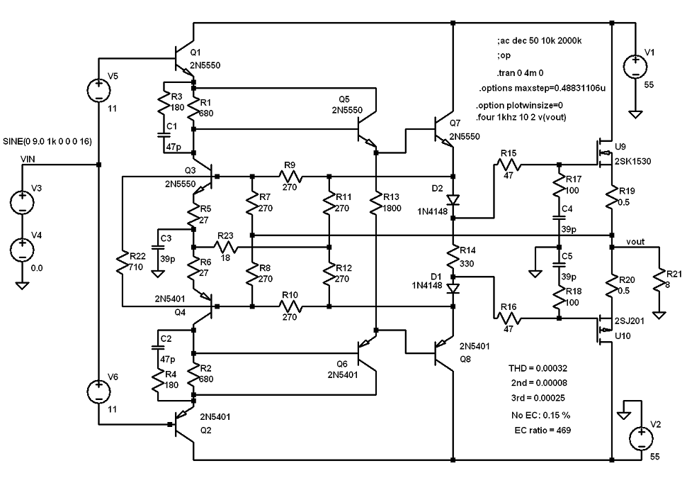

Ovidiu,
We are apparently talking about three different things here.
First is the amount in dB of improvement to be gained from EC. In that respect, we seem to be in agreement.
Secondly, we are talking about the EC balance condition and precision needed to get there, and the definition of percentage error in the balance condition.
Third, we are talking about the absolute percentage THD achievable in a given EC implementation.
The schematic below of the simulation I used in my earlier post may be helpful. It is a straightforward implementation of my original EC design, with D1 and D2 added to help accomodate the lower gate turn-on voltage required for the Toshiba MOSFETs to achieve the 150 mA idle current.
This circuit also shows the EC balance tweak resistor explicitly as R23. That is what to focus on. The total resistance in R23's circuit is re/2 of Q3-4, plus R5/2, plus R23, plus R11/2, ignoring any source resistance effects at the emitters of Q7 and Q8. This resistance, with re of Q3-4 about 5 ohms, adds up as follows:
2.5 + 13.5 + 18 + 135 = 169 ohms
The balance condition is that this circuit resistance wants to be one-fourth the value of R1 = 680 / 4 = 170 ohms.
As you can see, we have come very close here.
A 1% error in the balance condition is the same as a 1% error in this 170 ohm circuit resistance in the emitter circuit of Q3-4.
I was also pleasantly surprized that the EC could drop the distortion by such a large amount to such a very small value. In this case, the THD-1 of the output stage without EC was 0.15%. YMMV. Note that the sim shows an astonsihing reduction of a factor of 469 to a value of 0.00032% under the perfect balance condition. Bear in mind we are at 9 V peak into 8 ohms here and that we are at 1 kHz.
Do I believe this will happen in practice? No. But we may get closer than you think. Don't forget, your friend Edmond places a very high value on simulation results, as evidenced by his simulation-based claims about his NFB-only approach to the output stage. What is good for the goose is good for the gander.
Bob

Bob Cordell said:Forgot the schematic.
Here it is.
Bob
Bob,
One of the reasons you got such great results on the THD reduction is the use of 2N5550/2N5401 in the driver stage. Due to power dissipation reasons, this will never fly in the real world. You may want to select a pair of good TO220 devices and see how the circuit behaves.

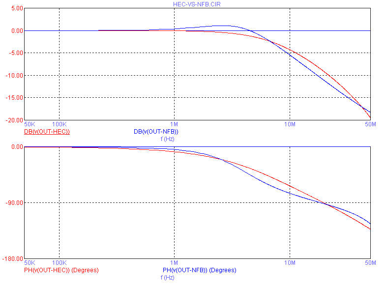

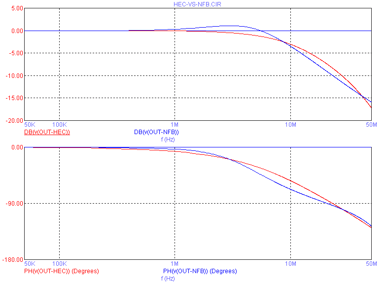

Hi Edmond,
You may get some surprizes when you simulate the whole amplifier, that's all I'm saying.
It looks like I've either missed a post or two or you've changed your NFB version of the output stage again. If I'm reading your chart right, it looks like you have moved your 3 dB bandwidth out to about 8 MHz, and you are now actually at about +1 dB peak at 2 MHz. Ultimately, you appear to have about a 1.5 dB peak at about 3 MHz.
It looks like you sacrificed some stability to catch up to my speed. Your phase lag at 10 MHz is about 70 degrees, while mine, shown below, is only 43 degrees. Frankly, I don't think yours looks all that good in comparison. The one I'm showing below is the same circuit I used earlier, but with the 2SC3601/2SA1407 and 2SC5171/2SA1930 transistors in it.
One of the nice subtleties about the EC circuit is that the compensation provided by C1 and C2 rolls off the EC feedback while providing a feedforward effect to the forward path, minimizing bandwidth loss and excess phase introduction by the compensation.
Bob

Hi Edmond,
Bob

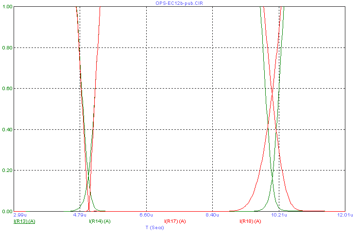

Hi Bob
The rationale behind different gate stopper resistors is quite simple. We don't need equal resistor values, rather equal time constants.
Generally, the effective gate capacitance of a p-channel mosfet is about 2.3 times higher than its n-channel counterpart, that is, if they both have the same trans-conductance, on-resistance etc. Why this is, I don't know exactly, but, considering that the mobility of the majority carriers in a p-channel mosfet (i.e. holes) is two to three times lower, I guess that the size of the chip is much larger, hence larger capacitances. (Ovidiu, please correct me if I'm talking utter nonsense)
With equal gate stoppers we get unequal common mode currents at the positive respectively negative going zero crossing transitions. At low frequencies this is not much of a concern, but at 20kHz it may increase the cross-over distortion and in case of a square wave it may even lead to a dangerous cross conduction of the two output devices.
In the picture below, I've exaggerated this effect just for clarity by using an unrealistic high frequency, i.e. 100kHz.
Red curves: equal gate stoppers, 150 Ohm.
Green curves: unequal gate stoppers, 100 and 240 Ohm.

Hi Bob

Hi Bob,
I can't find your schematic. Please, would you be so kind to drop it again, together with your latest mods?
Cheers, Edmond.
[snip
Bob [/B]
Hi Bob,
Cheers, Edmond.
