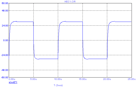

Hi Glen,
I don't think you have to worry about the stability, as the overshoot I was talking about has nothing to with violation of Bode's rules for stability. It was obviously caused by another mechanism. How else would you explain that the overshoot has gone in my 3rd version with the Schottky diodes?
BTW, have a look at the square wave response of HEC and compare that one with the figure in post 2695.
Cheers, Edmond.

Hi Glen,
Cheers, Edmond.

Re: hec != hoax ?
OK, but I saw your Schottky diode version after. How do you explain it?

Re: Re: hec != hoax ?
Hi Glen,
I can't explain it. Actually, I was fooled by the simulator. When I applied a square wave with non-zero rise and fall times, the overshoot (about 5%) was back. So, if that little overshoot is really a problem, one can use the compensation as shown in post #2694.
BTW, this time I have spiced a HEC OPS with the same trannies and the same Fc of the compensation and, surprisingly, the phase lag at 2MHz is 18 deg. opposed to 15 deg. of the NFB OPS.
Cheers, Edmond.
