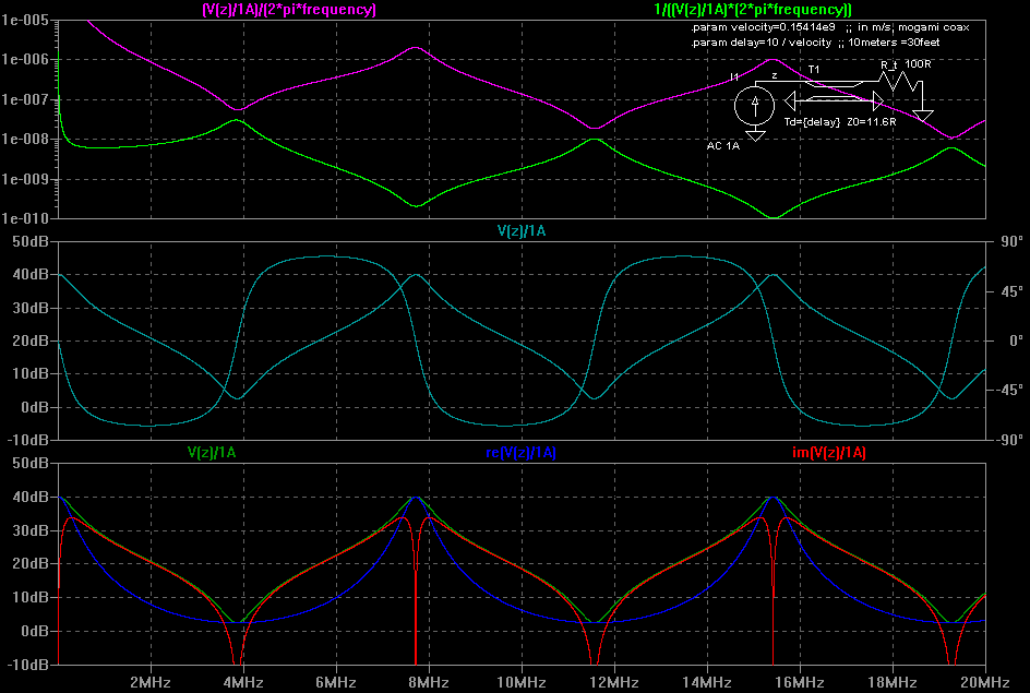

Well, I can't just let go of the cable propagation thing until
I see some reconciliation between my experience and the
observations by Syn08. Inductance and capacitance of a cable
have to be the electromagnetic properties in question.
So if you'll bear with me...
I went to Horowitz and Hill, and confirmed that propagation
for a coaxial cable having an insulator with ordinary dielectric
values is on the order of .66 times the speed of light in a
vacuum.
The speed of light is 186,000 miles/sec, or (rounding slightly)
1 foot per nanosecond. Down a length of coax we could reasonably
expect .66 ft/ns.
For a 40 foot length of coax we get 61 nanoseconds, which corresponds
to a frequency of about 16 megaHertz.
So we would not be surprised at a 1/4 wave resonance at 16 Mz down a
10 foot length of coax.
The Mogami wire I tested in 1980 is in fact a coaxial cable, and ought
to conform to this. I had measured it as .0042 ohms/ft, 170 pF/ft, and
.023 uH per foot.
I used Microcap :) to simulate 10 ft of this, and saw a 1/4 wave resonance
at 12 megaHertz. The phase response down the line also fit, with a 90
degree delay at that frequency.
That's about a 25% error. Maybe the dielectric of Mogami was particularly
crappy, maybe it's not a good coax construction, maybe my figures are off
a bit, maybe all those things.
With the simulation of 18 gauge zip cord at .014 ohm/ft, 28 pf/ft, and
.21 uH/ft, I got 10 megaHertz. That's slower propagation, but then it's
not coax construction.
Polk's "Cobra" cable with .0075 ohm/ft, 500 pf/ft, and .026 uH/ft has a
10 ft resonance at 6.7 megaHertz. It's construction is of the fine
interwoven strand variety similar to Litz wire, and it appears to have
1/2 the propagation velocity.
I can't help but conclude that the "0.66 * C" figure applies to coax
cable only.
30 feet of the Polk cable definitely puts us in the ballpark for having
a serious effect on a wide bandwidth power amp, and that has been observed
historically.
This still leaves us with the mystery of why the Mogami cable drove
amplifiers crazy in the 70's. It's resonant frequency would have been
higher than the other products on the market.
Have I made any errors here?
:cool:

Nelson,
My only problem was with that 1MHz resonance :) This time I have no issues with your calculations and conclusions, except for this one:
I can't help but conclude that the "0.66 * C" figure applies to coax cable only.
The value of 0.66 has nothing magic in it. Disregarding the transmission line type and geometry (coax, parallel, microstrip, waveguide, etc...) the wave propagation velocity in an homogenous dielectric is only a function of the dielectric relative permittivity k. To be more rigurous, the relative propagation velocity is exactly v/c=1/SQRT(k*u) where u is the relative magnetic permeability (which is approximately 1 for dielectrics) and c is, of course, the speed of light. This being said, v is 0.66*c for a dieletric permittivity of about 2.3 which is typical for a large range of plastics used in cable construction. A lower propagation velocity would translate in a higher permittivity, which in turn translates to a higher specific capacitance, hence (in an equivalent RLC distributed model) a lower resonance. Most likely the coax you measured is built using a high(er) k dielectric material.

Like Nelson did, I modelled that mogami coax, taking the tml values that andy_c provided as derived from Nelson's data.
I modelled, with LTSpice's "lossless tline" part (very "first order" ;-), 10m (30feet) mis-terminated x10 with 100R, looking into what an amp would see...
Bottom plot:
Green: impedance magnitude
Blue: real (resistive) part thereof
Red: imaginary (reactive) part thereof
Unit dB ref. 1Ohm
Center plot:
Impedance magnitude ("sawtooth") and phase ("square")
Unit dB ref. 1Ohm
Top plot:
Purple: equivalent "inductance"
Green: equivalent "capacitance"
Units: Henrys and Farads, per meter (unit length)
I checked with the terminated case and found those L=68nH/m(22nH/ft), C=511pF/m(170pF/ft) values when I "measure" at ~26MHz, which sounds reasonable and matches the data (as it should be, being the sanity check for the sim). Plotted Z_char also matched. Still I'm not sure about that "per meter" stuff. It is per some unit length (doesn't change with cable length), but why meters?
Looking at the top plot, shortly below the first resonance at 4Mhz, say at 3Mhz, the cable "capacitance" will be ~"100nF" with -70deg phase, compared to the 5nF of DC capacitance. Between 8Mhz and 12Mhz the next capacitive area (-90deg) shows up, with load "capacitances" ranging from ~4nF to ~60nF.
I hope this sim illustrates the topic in a helpful way (and I hope I didn't overlook or grossly misinterpret something, I never did that equivalent L/C stuff with transmission lines so far, with regular networks it works pretty well ).
- Klaus
