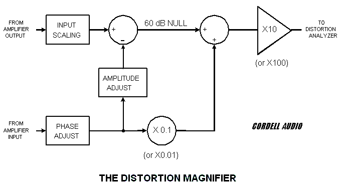

Any chance you'd post anytime soon some details (schematics, etc...) on your distortion magnifier and protection circuit?
Ovidiu,
Thanks for these models.
Yes, I'm working on getting both the Distortion Magnifier and protection circuit into electronic format (most of the stuff is hand-drawn on graph paper, I must admit).
For now, here's a peek at the DM block diagram. As you can see, it is not very complicated, but makes a lot of things very convenient. The differential input for the signal from the amplifier under test sometimes helps in keeping noise and pickup down.
Bob

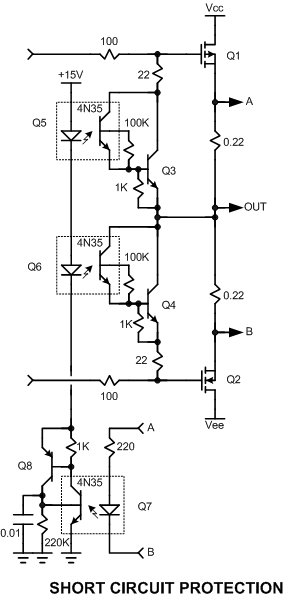

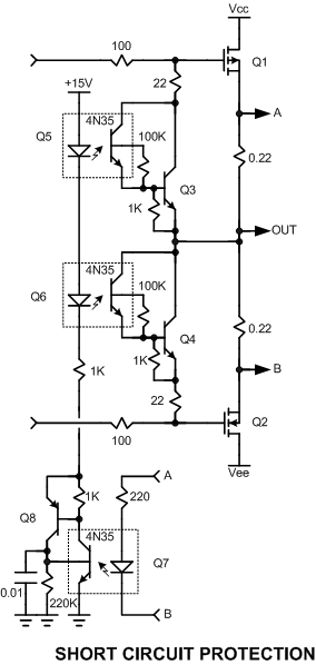

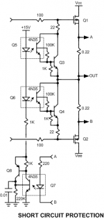

Short Circuit protection circuit
I've posted below a version of the MOSFET short circuit protection that I used in a prototype about a year and a half ago.
Let me first say that the most important thing is the functionality. It is definitely NOT an SOA protection circuit or a current limiter. It is only there to act in the evnt of a short circuit or an event that causes extreme output currents to flow. It is not designed to allow the amplifier to play through the event. Once triggered, it immediately disables the output stage and the amplifier will not operate until the power is cycled. It is intended to be completely non-intrusive during normal operation. Its just a binary thing.
Q1 and Q2 are vertical output MOSFETs with a typical forward gate voltage bias on the order of 3.5 to 4.5 V at idle. Q3 and Q4, once turned on, largely ground the gates to the sources, depriving them of gate drive and shutting the output transistors down. Q3 and Q4 are driven in Darlinton fashion by phototransistors Q5 and Q6.
The protection action is triggered when a large enough voltage appears across the output source resistors. That will turn on the LED in phototransistor Q7. Q7 and Q8 are connected as a positive feedback latch. Once Q7 turns on, it will turn on Q8, which in turn will further turn on and keep on Q7. The current drawn by the Q7-Q8 latch illuminates the phototransistors Q5 and Q6 so as to deprive the output transistors of gate drive.
This circuit, as shown, would need to probably be modified to work with lower-threshold V MOSFETs and may not be suitable without considerable modification for lateral MOSFETs. I like this circuit because of its isolation with phototransistors, as the latch/control circuit is referenced to circuit ground, rather than floating with the audio signal. This allows for other interesting control possibilities.
This circuit does not have a particularly high precision triggering threshold, as it depends a little bit on the current transfer ratio of the phototransistors. As shown, the size of the output source resistors, combined with the forward drop of the LED in phototransistor Q7 largely determines the trigger point. This can obviously be revised and elaborated upon to suit other arrangements.
This circuit has saved me from a couple of disasters. Once again, I must emphasize that it presumes that the amplifier has been designed with enough SOA in the output stage to handle any anticipated legitimate loads.
Bob

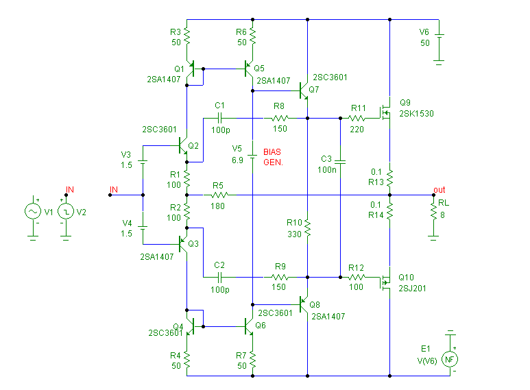

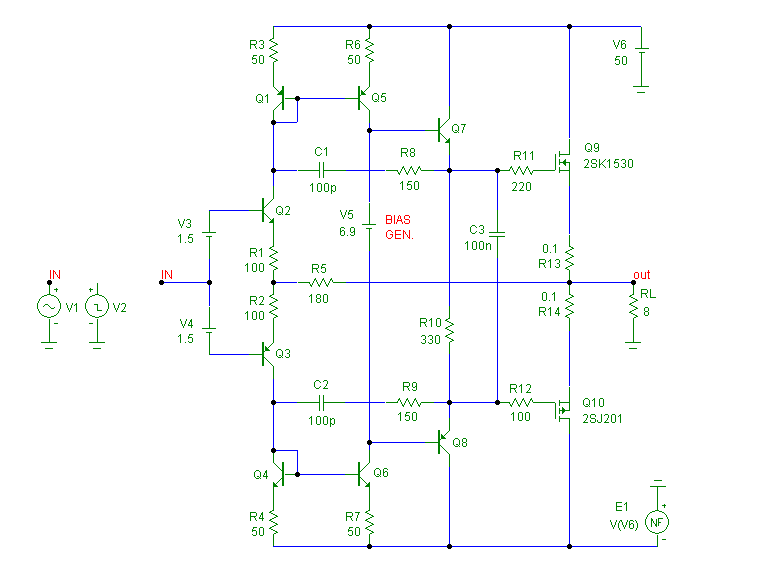

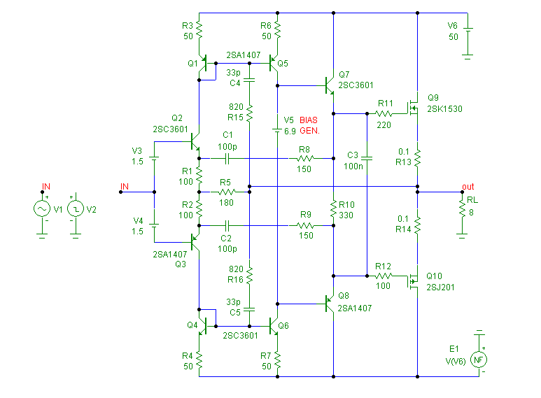

Hi Pete,
In order to prove that HEC is equivalent to traditional NFB, I've simulated this simple output stage. It not only has the same performance in terms of distortion and stability, but the step response is much cleaner and there ain't no EC circuitry running out of steam under heavy loads. Furthermore, no large bias voltage (e.g 22V) is stolen from the VAS, so no need for a boosted power supply for the front end.
Some specs: THD20=50ppm at 100W into 8 Ohm, Iq = 150mA.
Cheers, Edmond.

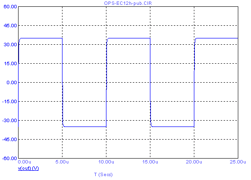

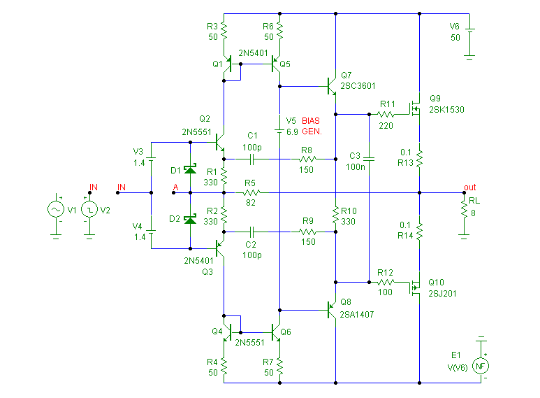

G.Kleinschmidt said:
Hi Edmond
Hmmmm....... very pretty, but the -3dB bandwidth is only 2.6MHz (30 deg lag at 2MHz), so there is a greater limitation now on how much HF global NFB such an output stage can be wrapped up in???
Glen
Hi Glen,
That's right, 2.6MHz. Fc is set rather conservatively. As for the 30 deg lag at 2MHz, if it's too much, you can reduce it to the same level as in HEC, i.e. 11deg, by moving the Miller compensation to the emitter of Q2 and Q3 respectively (see figure). However, this configuration gives a little bit of overshoot, although it is masked in a complete amp.
Cheers, Edmond.

I'm not sure that you've proven it, however I do like your circuit and think it is good if my challenge was the push to produce this new topology. It is new I take it, I'm sure you or one of the brains here will correct me if not, LOL! You do in a sense have a VAS or gain stage in Q2, Q3, which is fine since HEC can be viewed as providing gain.
I see a similarity with the old Tiger output stage, perhaps simply with Q2-Q3 being CE and the local feedback. This circuit could provide some gain in order to reduce the swing requirement on the front end, so that it could be regulated, or use cascodes without the need for another supply.
I wonder if Bob might combine this with HEC, include some gain, and then not need the second supply for the front end. I've not looked close enough to determine if this is even possible, just throwing it out there.
I've been meaning to suggest the investigation of output stages with gain for some time now.

Still, it seems to me as others have commented, there is no reason that Bob could not add NDFL, or other techniques discussed to his design.
I agree with you and mentioned from the start that Bob's design is complex, however I do respect the fact that he had an ultra low distortion goal and used much older parts available at the time. I also do not like the requirement for boosted front end supplies. Just my preferences.

Hi Pete,
Thanks for your comments.
The "proof" is that, with the same amount of NFB and the same roll-off, the performance is also the same. OK, it's not a rock solid proof, so let's call it "strong evidence". 🙂
Whether it's new, I really don't know. Perhaps it is a re-invention, as happens to me so many times. :sad:
The VASes consists of Q5 and Q6 (not Q2 and Q3). As they are part of the current mirrors, the current gain is of course rather low, in fact unity.
I had a quick look at the Tiger OPS, but I don't think there are many similarities, as it asymmetric and the output trannies are put in a CE configuration for example.
As for some gain, yes, it's possible. Put a 1kOhm resistor between node A and ground.
I've dropped here another version with Schottky diodes, which also eliminates the overshoot. Also the quiescent of the input stage and current mirrors has been lowered, so that cheaper trannies can be used.
BTW, the slew rate is 1GV/s 😀
Cheers, Edmond.
Re: hec != hoax ?
Edmond Stuart said:
Hi Pete,
Cheers, Edmond.
PS: All PNPs are 2SA1407 and all NPNs are 2SC3601
Hi Edmond,
Nice work. I always like it when someone shows that there is more than one way to skin a cat.
Why didn't you use this circuit in your PGP instead of EC? 🙂. I assume you came up with this afterwards.
I do have to take issue with a couple of things you said about EC.
The EC circuit does not run out of steam under heavy loads. Just look at my Figure 20 in my MOSFET amplifier paper, where I drove over 22 Amps into a 1 ohm load at 20 kHz with a 2-cycle burst, using only a single pair of output devices.
I do recall that you showed a simulation of that where the error difference transistors were clipping, but in that simulation you were taking liberties with the design and using faulty MOSFET models. You added 0.22 ohm source resistors without accounting for their 4V drop at 20 amps. You also used an IRFP244 with a wimpy model that only put out 8.8 amps with a forward gate voltage of 7V. The IRFP240 data sheet shows 21 Amps at 7V.
The original EC circuit was designed to put out between 8 and 9V of turn-on voltage with respect to the output rail. As long as that capability is properly matched with the output devices, the EC circuit will not run out of steam.
In your circuit you are also taking advantage of the lower turn-on voltage of the Toshiba MOSFETs.
In more recent designs I use folded emitter followers to drive the EC, with the voltage spreading taking place after the folded EF, so the bias voltage is not stolen from the VAS. Moreover, no matter what you do, you need to have enough drive voltage ultimately to adequately forward bias the output MOSFETs. If you choose not to use a boosted supply anywhere, you are certainly free to do so, but you may be putting an unnecessarily large main high current power supply voltage on the output devices, dissipating more than need be. If one wishes to make such a compromise, it can be done with EC as well.
Nevertheless, your interesting design is about efficeint as one can get as long as you don't want to be able to swing the gate beyond the supply voltage. The use of the Toshibas makes this less of an issue anyway.
I generally like boosted supplies, and if you use one, a difference of a couple of volts one way or the other is no big deal. The boosted supplies are relatively inexpensive due to the low current needs, and the bit of extra headroom they give the VAS can help performance. Just a matter of choice. But in a truly high-performance amplifier a boosted supply is no big deal.
Bob
Edmond,
This isn't a new topology but it is an effective alternative way to apply NFB to the FETs using 8 transistors. There are pros and cons. I agree with your hypothesis that similar performance is caused by similar NFB; implying HEC is not doing any error cancelling or other hocus pocus.
Brian
