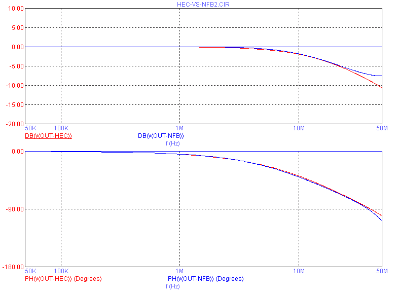

Hi Bob,
Thanks!
Now the last hurdle, i.e. the discrepancy of the THD figures. As Jan Didden has pointed out, "the ec loop encloses only the output devices", that is, not the drivers (see: http://www.diyaudio.com/forums/showthread.php?postid=1310822#post1310822 ), I wonder whether the THD figures come closer to each other, if I manage to enclose the drivers too inside the EC loop.
Of course it'll take some time to figure that out, but I'll let you know about the results ASAP.
Cheers, Edmond.
Bob Cordell said:Very good, Edmond. Looks like we are converging. Each of us looking at what the other is doing is improving the results on both sides. That's part of what DIY is all about.
Although we don't have exactly the same distortion numbers, it does look like your results are largely confirming the kind of open-loop distortion performance of the Toshiba output MOSFETs that I have been seeing.
Bob [/B]
Hi Bob,
Thanks!
Cheers, Edmond.

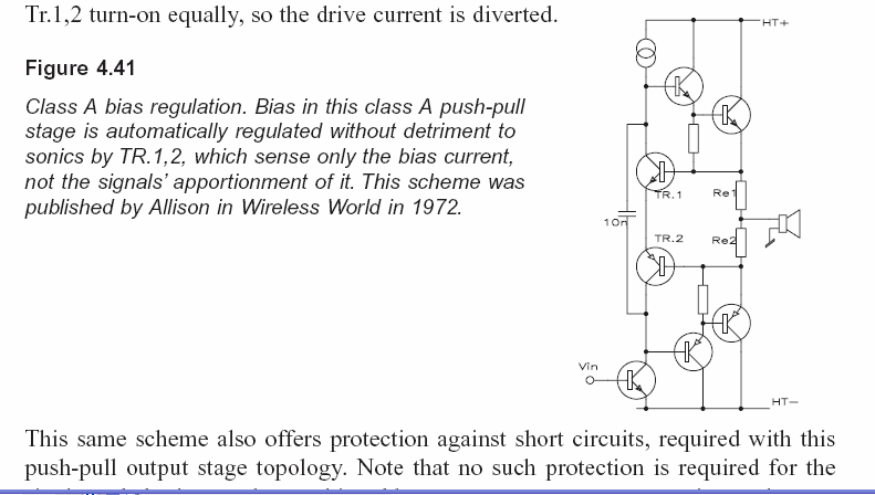

I'm on a different track than you guys. My aim is to have an amp with EC but no global NFB. So, it's two parts, the OPS and the Vas, each with their own EC loop. The performance is not as good as your and Bob's design, but comparable to 'a pretty good poweramp' of 'classical' design. I do get two zeros after the comma for THD over most of the freq and load range.
It's playing, and now I am cleaning up de pcb and some other stuff. I'd like to publish it but have not decided where....

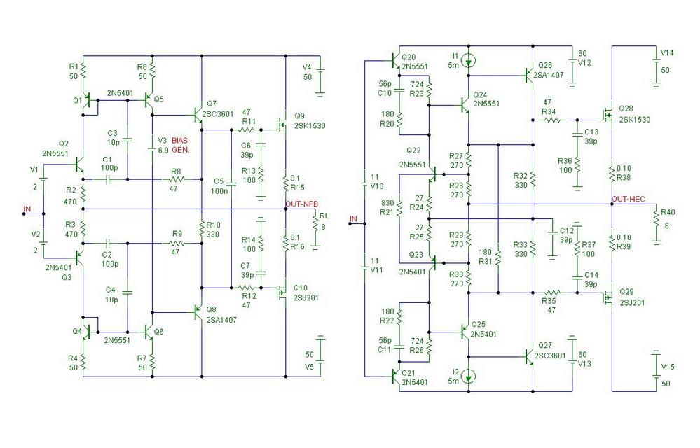

Hi Edmond,
- Klaus
Originally posted by Edmond Stuart
Your amp seems to perform extremely well, proficiat!
The crux is bootstrapping. As you probably know, we also have used that trick in our PGP amp.
I'd actually wouldn't use bootstrapped driver supplies which are derived in any form from the main supply. I'd rather use completely independent supplies, full floating (less than 50pF Cstray is doable with a little thought). One xformer with two independent secondaries would do, for single/paralleled push-pull stage (hence two xfromers for a bridge amp -- I strongly prefer bridges when using class-A) and seperate regulated voltages for the individual drivers and cascodes can be derived from that which still could be made isolated enough from each other.
Without being picky, are you sure it's sufficient stable with the coils and without compensating caps? I guess you will soon find out when simulating the output stage with discrete components. Please let us know.
I sim'd it already with that simple discrete driver stages shown in the previous post and now I added/updated some (more or less) reasonable parasitics, still it performs quite well, had to change only little of the compensation -- Rfb and the snubber --, but well, the ss step response is far from the aperiodic ideal, and certain loads fail (which didn't when sim'd without parasitics). Also, the compensation will surely grow more complex the more I dig into the details. Inductance in the supplies is critical -- 20nH...40nH is OK, which would require a good HF layout and SOTA bypassing.
The coil parasitics are also critical, currently they are ~200uH and should have less than 20pF Cpar. The inductance itself is not a problem per se because the parallel R overides it. I set the resulting zero at 1MHz, that is about a decade lower than the bandwidth, so it doesn't add much phase shift at the point where it matters, the resistor Rfb dominates the Z at that point. Likewise, the zero from the subber/zobel is also set at 1Mhz. And then we have the infamous L//R output isolator. In general I'm aware of the stability issues of NFB designs and I know it's a long way from a succesful sim to reliable real-world circuit. And right now I'd say I'm still quite far away from a complete sucessful sim... so you are some two steps ahead of me, with the PGP, as well as the other senior designers here. I didn't do too much discrete power audio stages so far, I'm constantly learning in this exiting EE field (I'm EE)... thanks to all of you for sharing your hands-on experience!
The way you control the bias of the output devices is clever, but I'm afraid it's only feasible with class-heat, not class-AB. Did you try the latter?
This problem is quite challenging. Right now the driver's feedback goes open-loop when the current starves (and without clamping they'd kill the outputs with reverse Vbe, with the current driver supplies of +-30V). I already tried some variations along the lines of dynamic re-biasing either the whole stage or only the starving side to maintain both outputs biased at all times, but it's not easy, especially without compromising distortion, and raises stability issues -- just another feedback loop. Another thing I tried is a "fallback" AB-stage, that is, each output has it's own local class-AB complementary, biased in the conventional way (preferably the ONS ThermalTraks).
That's a point I will have to try hard (no good solution yet), as some current-on-demand scheme would be very practical to have, at least when we want to have peak output powers in the 100W++ regions. And I might allow high power peaks to be comprimised in distortion perfomance if it saved a few hundred Watts and $$$ on heatsinks etc. OTOH, a true and non-compromised class A low power design (~50W), for effcient speakers (also considering active speakers, the MF/HF sections), looks still very appealing to me if I manage it to get stable and failsafe. Or for headphone/line output stages...
PS: If you can't 'measure' the distortion with LTSpice, just use Micro-Cap.
OK, so does Micro-Cap go lower than the 0.01ppm display limit of LTSpice? That is -160dB, and I found the sine generator THD to be no better than -165dB. I ought to give it a try (and should do that anyway, to check the sims for consistency). Probably file formats and user front end are quite different, aarrgghh!

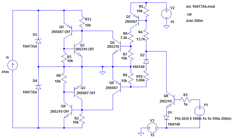

Here's a variation of Bob's switching circuit concept that uses no optos. This is just a conceptual idea - not shown is how to OR the detector outputs together to get a single trigger signal.
The zeners represent the amp's shunt reg, and ground corresponds to the amp's output node. As suggested by Bob earlier, the positive and negative sides of the shunt reg would each be shorted to the amp's output. In this case, there are two latches arranged in such a way that they can be triggered by complementary BJTs.
To simulate this in SPICE, the OFF keyword needs to be used with the latch transistors because of the bistable nature of the circuit.

andy_c said:Here's a variation of Bob's switching circuit concept that uses no optos. This is just a conceptual idea - not shown is how to OR the detector outputs together to get a single trigger signal.
Hi Andy,
Cool! I've also wondered about doing it with some kind of arrangement using triacs, but have not done it.
Bob

Regarding my output stage idea, this morning I now see something that uses the same concept, a feedback loop that just holds the added voltage drop across both output emitter resistors constant. Nobody less than Bruno "UcD" Putzeys designed it (together with Sander Sassen), a really straight design:
http://www.diyaudio.com/forums/showthread.php?threadid=96853
I need to study that in detail.

KSTR said:Regarding my output stage idea, this morning I now see something that uses the same concept, a feedback loop that just holds the added voltage drop across both output emitter resistors constant. Nobody less than Bruno "UcD" Putzeys designed it (together with Sander Sassen), a really straight design:
Hi Klaus,
that particular idea is quite old and was published by Allison in 1972 according to Ben Duncan's book:
Cheers
Alex
[snip]
- Klaus

Re: Re: Re: Re: Re: Re: hec != hoax ?
Hi Bob,
See below how I've eliminated the distortion of the drivers. Admittedly, it's a quick and dirty solution by using CFP stages and current sources, but nevertheless it gives optimal results.
Also notice that I've slightly adjusted the compensating caps so that the NFB loop in both circuits has the same Ft, 2.8MHz.
For results, see next post.
Cheers, Edmond.
Hi Edmond,
That's a good point and I have already considered doing that by just using an extra set of emitter followers as the drivers instead of the diodes I show to get the voltages comfortably close to those that the Toshiba devices want. Not much difference between a diode and an emitter follower. The existing driver devices could then be run at a bit lower current, so the net disspation cost might not be that much. There are a couple of variations on how to do it, but that is the essence of it.
Bob
Hi Bob,
Cheers, Edmond.
hec != hoax ?
(continuation)
The THD20 in ppm at various power levels into 8 Ohm
1.0W : HEC: 22.28 NFB: 22.17
10 W : HEC: 54.55 NFB: 54.88
100W: HEC: 60.27 NFB: 54.00
As one can see, not only the THD figures are almost identical, but also the gain and phase plots of both amplifiers (see below) closely match each other.
I hope that these figures provide enough evidence that HEC is nothing more (or less) than NFB in disguise.
Cheers, Edmond.
