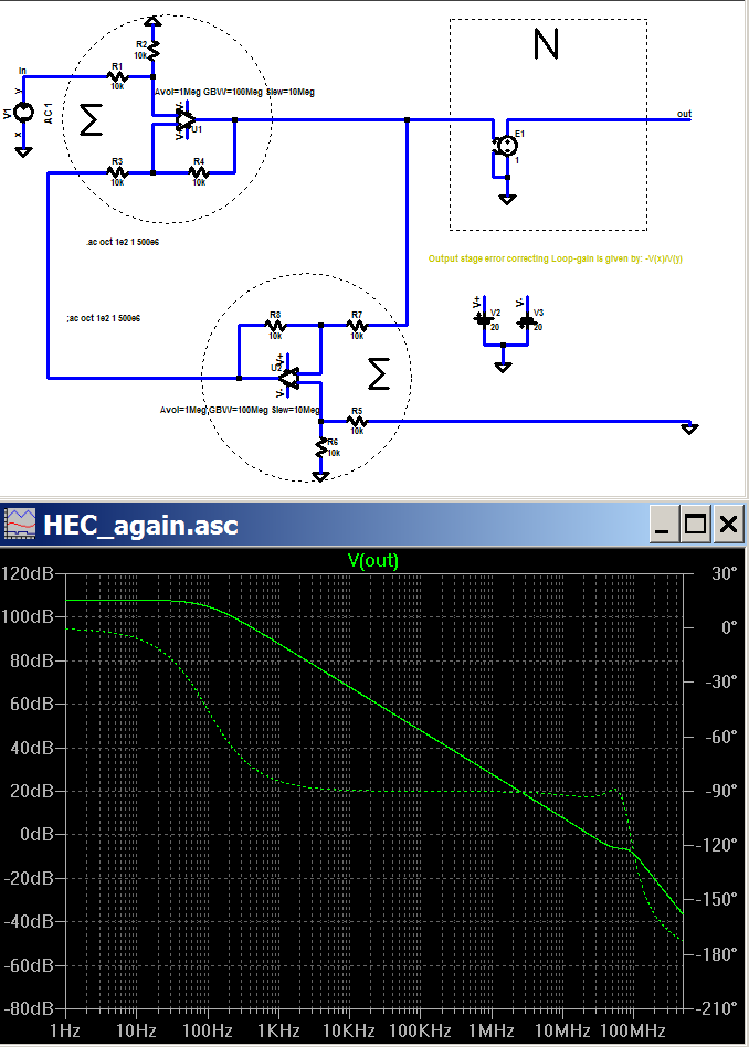

PB2 said:I do not read every post here, and I am a bit surprised if the discussion here now applies to the disagreement that started back around post 555 as it would seem that people were talking about different problems. OK ... well ... I'm not surprised.
Hi Pete,
Right from post 555, the subject is where to break the loop and, closely related to this "...that the difference between output and input is driven to zero by virtue of the enormous forward gain that is generated by a positive feedback loop" (Brian)
First off, this discussion is about the local feedback loop of the output stage alone, and therefore comments about loop stability as if it was the major loop make stability concerns
Bob's real design works and is stable, yet some here are claiming such designs will not be stable.
To the best of knowledge, nobody has said that. But I'm convinced that EC has a negative influence on the stability margin. Why else would Bob say: "I think that one would have to be borderline suicidal to use this circuit without any output HF isolating inductor at all"
What traditional negative feedback design has a null control?
If the NFB loop gain approaches infinity, then the distortion drops to almost 'null'
Cheers, Edmond.
(sorry, had to edit this as I made a blunder)
Jan wrote:
I believe the contention is that you keep denying C as the correct place to measure the feedback. This is so self-evident to me that I cannot conceive of why you think otherwise.
Jan wrote:
Yes.With the switch in the lower position, we can break the loop at A, B or C, always measuring the same value for the loop gain. Obviously, when we put the switch in the upper position, the loop gain measurements at A and B will not change, but at C will, because we now measure a different 'loop' at C than before.
Yes, as I agreed before. In this mathmatical model.The transfer function from input to output doesn't change with the switch position.
No. When you change the swicth they are no longer the same loop as before, they are no longer just the NFB loop.The loop gain measurement at A or B doesn't change with the switch postion. Thus the loop gain measurements at A, B give a correct value.
Yes we do...so please listen. The loop gain at C is ALWAYS the correct NFB loop gain, regardless of switch position. With the switch in the upper position the loop gain at A or B is no longer the NFB loop alone, it now includes the nested PFB loop, so it is not valid.That would mean that measuring the loop gain at C, with the switch in the upper position, is incorrect. Yet both you and jcx maintain it IS correct, and you guys obviously know what you are talking about.

traderbam said:[B[snip]Yes we do...so please listen. The loop gain at C is ALWAYS the correct NFB loop gain, regardless of switch position. With the switch in the upper position the loop gain at A or B is no longer the NFB loop alone, it now includes the nested PFB loop, so it is not valid.[snip][/B]
Sorry, but it seems self-evident from simple inspection of the circuit that switching does not in any way change the loop going through either A or B. In either switch position, the loop gain in A or B is a result of both the pos fb part as well as the neg fb part. Only the loop gain at C changes with the switch position because with the switch up it no longer includes the pos fb part but only the neg fb part.
That indeed is the crux of our discussion.
If we built this circuit in a black box, there is no way from measuring the amp I/O transfer curve to find out in which position the switch is. Measuring the loop gain at C DOES give a clear indication of the switch position, because that measurement is different in each switch position. But since the switch position doesn NOT change the amp transfer curve, it seems a logical contradiction to consider the loop gain at C as the correct loop gain measurement.
Jan Didden
Edmond Stuart said:
Hi Jan,
You are right. I'm sorry I've overlooked that. On the other hand, you changed to a complete different scheme that has little to do with Hawksford EC. Not the most obvious way to clarify our different points of view. 😀
Cheers, Edmond.
Not at all! My circuit is exactly the conceptual approach from Hawksford with b=0, a=1. In these types of discussions it is often necessary to try to dig down to the very fundament and toss out everything that is not essential, like a and b. Once the fundament is thoroughly understood, implementation becomes straightforward.
In the sim circuit you send me, the N^-1 input to the error summer is at the emitters of Q52,54 (through the 27 ohms resistors). The -1 input is at their bases through the resistor network, attenuated. Actually, it is a +1 term that is later inverted at the collectors.
Jan Didden

PB2 wrote:
Hi Pete. I don't know of any. I don't know why anyone would want one.traderbam you have suggested so many times that your viewpoint is so obvious, and so correct. Let me ask you, show me a traditional NFB design with a null pot that is physically realizable.
PB2 wrote:
What are you claiming has been proven? Bob's design reduces the error by 30db at 20kHz. There is no null in the sense of eliminating errors.So, yes, I have a problem with this, a null in HEC is a physically realizable design, within reason, as has been proven by Bob's and several other designs.
EC
Hi Pete,
I said approaches infinity, not is infinity, meaning in real life that a max. NFB loop gain in a HEC circuit of say 60dB is realizable. As a result, the distortion will approach zero, but never exactly zero.
As for Bob's design, what do you mean: exactly zero or almost zero?
Cheers, Edmond.

Hi Jan,
Although the final result may be the same, i.e. (almost) zero distortion, that does not imply that the conceptual approach is equal.
Further, the signal at the input of the error summer is not N^-1, but 1-N. That makes a big difference, sorry.
Cheers, Edmond.
