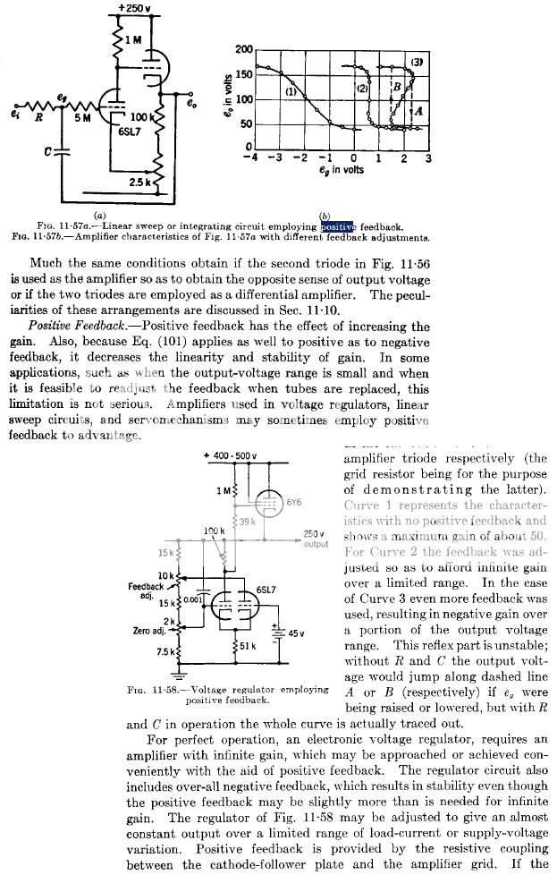

I believe we still have an outstanding objection that no one has ever seen an amplifier with a (positive feedback) gain adjustment?
I hope this qualifies as "fair use" - from the MIT Radiation Lab V18 "Vacuum tube Amplifiers" (the pdf gives 174 text search hits for "positive feedback"):

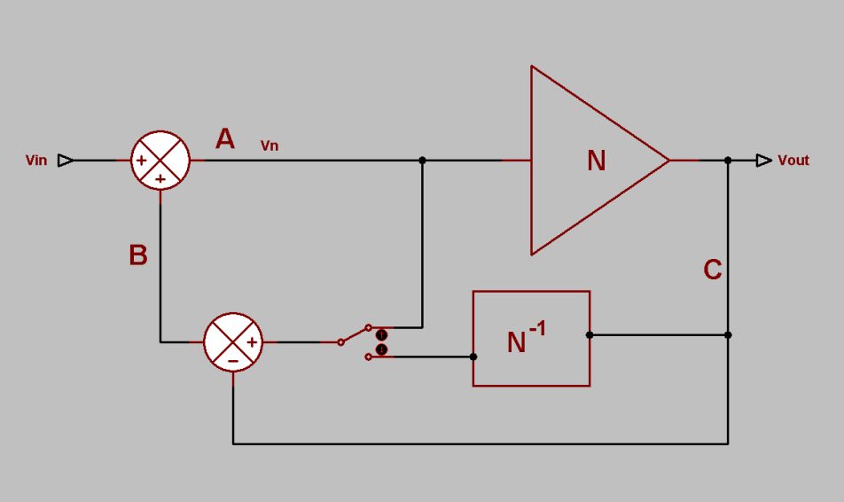

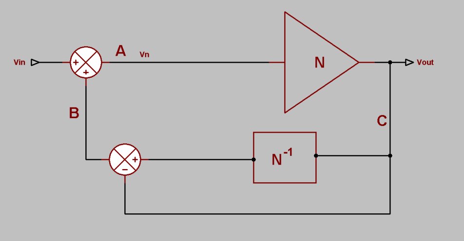

I am sorry that I was not able to participate inthe discussions yesterday. I have the feeling that the focus has shifted. The focus was whether the breaking of *only* the neg feedback sub-loop of the H.EC circuit, and using that break point to measure loop gain, was the right way to do. I don't think it is. If indeed it isn't, we must re-evaluate the conclusion we drew from it.
Let me back-up to the point where we agreed that measuring the loop gain at points A, B and C in the below circuit all gave the same and correct loop gain:
Jan Didden
Jan Didden
I now take this same circuit but with a switch where you can pick off a part of the feedback signal from two different point, without in any way changing the circuit transfer function.
It is self-evident that with the switch in the down position, measuring the loop gain at A, B or C again, as before, gives identical, correct, results. It is also evident that with the switch in the upper position, measuring the loop gain at C gives a different result. Since a circuit cannot have two different loop gains at the same time, at least one of the two measurements at C is incorrect. Which one?
We see that in either switch position, the loop gain measurements in A and B remain the same. We have also agreed earlier that at one position, all three equal measurements were the correct one. Therefore, the loop gain measured at C with the switch in the upper position is incorrect.

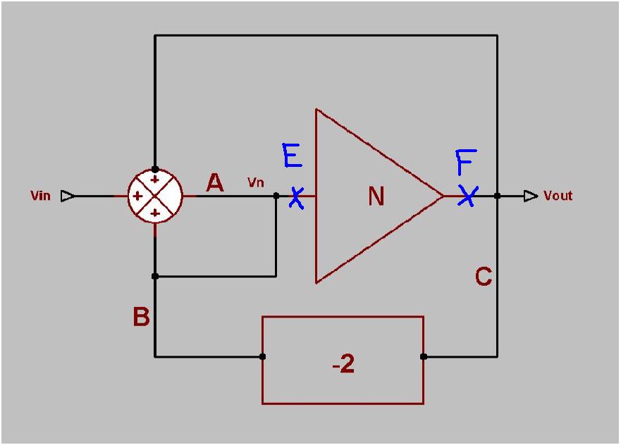

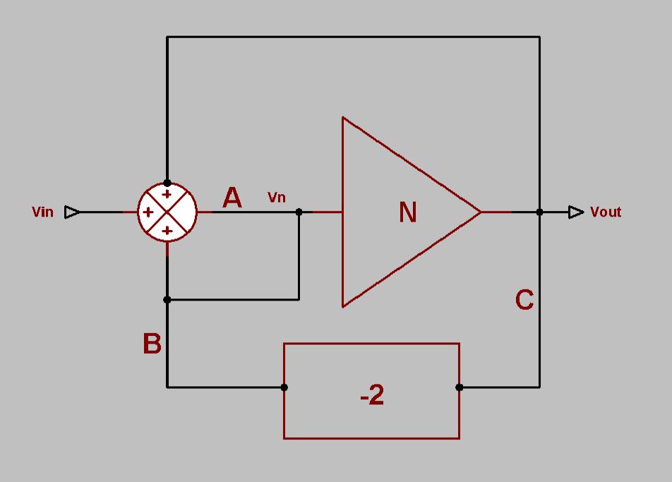

This circuit can again be rearranged without changing the circuit characteristics in any way as shown below.
Where, in this circuit, would you cut the loop to measure the circuit loop gain?
In this circuit each of the measurements in A, B or C would yield a different loop gain result. Again, a circuit can only have one loop gain at the time, so (some of) the measurements are wrong here.
I can repeat this with different circuits ad nauseatum, in each case showing that breaking ONLY the one identified direct nfb connection from the output terminal to measure loop gain gives inconsistent results.
It appears we stumbled on a rule of the game that wasn't evident in this discussion, namely that if you want to measure the loop gain you must break the circuit in such a way that you break ALL separate feedback paths, positive or negative, at the same time.
If you do that, you can take any transformed configuration of a particular circuit and in each case come up with the same consistent loop gain result.
If you don't do it, you can have different incarnations of a circuit, all have identical transfer functions, with identical forward path elements, yet seemingly having different loop gains, and clearly this is not possible.
Jan Didden
Jan Didden
Hi Jan, how are you doing today?
I would submit that the circuit does not have two different loop gains at the same time because the circuit is not the same. The transfer function, Vout/Vin, is the same but the feedback loop gain is different. This is because when the switch is down, the output error is nulled (truely nulled this time) by the inverse N block, so no feedback is needed. A sort of feedforward backwards. When the switch is up the inverse N block is replaced by a PFB loop and this creates an infinite feedback loop gain...this time reducing the output error to zero, if you will, rather than cancelling it.Since a circuit cannot have two different loop gains at the same time, at least one of the two measurements at C is incorrect. Which one?
At E or F. Again, the principle is to measure the gain in the single loop around the output device.Where, in this circuit, would you cut the loop to measure the circuit loop gain?
What does this mean for the present discussion? It means you cannot break just the nfb part of the loop and say, see, it's pos feedback giving infinite gain. Of course that is true if you break only the nfb path. It is however NOT a correct characterisation of the circuit because the loop gain you measure is not correct, UNLESS you break ALL feedback loops at the same time.

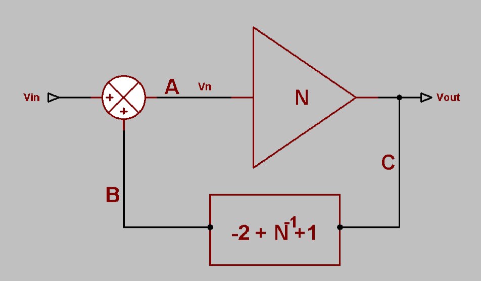

traderbam said:Hi Jan, how are you doing today?
The circuit IS the same. The N^-1 block is a pfb loop, the same pfb value as taking it from N's input. If I built this in a black box, there's no measurement you can do to find out in what position the switch is. The same forward path elements, the same transfer function, measured and calculated.
Can you show me two circuits that have the same forward path elements and the same transfer function but different loop gains?
