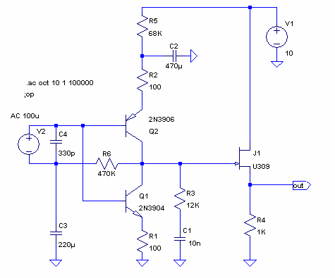

john curl said:
You will find that my patented input circuit is quieter than almost any other, direct coupled at both input and output
It was most interesting to have a look at this circuit as it is almost exactly what I did for a tape PB preamp circuit about 1980 without any knowledge of your patent. Unfortunately available for me at the time soviet types of transistors were pretty poor quality. Here is a fair representaion of that old circuit
Cheers
Alex
Don't worry, you are in good company. By 1980, Ortofon had ripped me off bigtime, Michaelson and Austin made a unit in GB, and even Quad had some sort of version. Etc, etc. No more patents! Waste of my time. However, it might be more understandable why I don't publish here my detailed schematics, more often.
