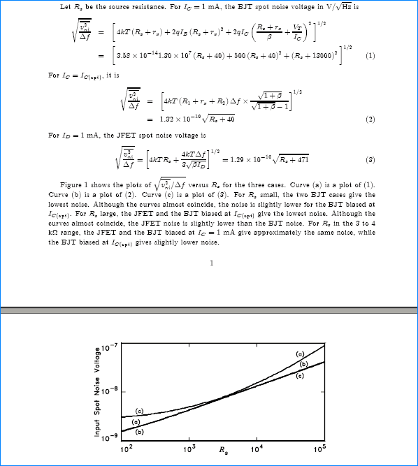

john curl said:Yes Edmond, I read the same thing 35 years ago, BUT it is not true today.
Let us quickly look at the REAL difference between an ideal bipolar transistor and a JFET. The fundamental noise for a bipolar transistor is .5(1/Gm), the fundamental noise for a JFET is 2/pi (1/Gm). With nearly ideal devices, the difference is small, especially if you operate the JFET at higher currents, such at 5-15ma.
Still, you might think that the bipolar transistor has a slight advantage, BUT NO! Not in Glen's design example that I specifically referred to, because the inputs (bases) are not effectively shorted to ground (from a noise point of view). This makes the bipolar transistor's base CURRENT noise generator dominant and you might as well forget about the ideal noise.
Linear systems makes OK to good fets, BUT they are somewhat overpriced, and not as good in some ways as the original Toshiba parts. However, they will do in small scale production, or amateur efforts.
Erno Borbley is still a good way to buy critical parts. I know that they 'seem' expensive, but that is all that is left in the world, so to speak, and Erno, like the rest of us, needs to make a profit from his forsight in purchasing jfets in the easy times, and storing them for future projects.
Good day Mr Curl,
First, do you really mean that the laws of physics, discovered some 35 years ago, are no longer valid?
Second, it was far from clear which of the two designs of Glen you was referring to. The 500W version, published in part on this forum with unspecified input circuitry around the LTP's, or the 12W version, which is published on his own website?
Indeed, the latter has unnecessary high resistors at the inputs, which should be lowered by a factor of ten (sorry Glen) to reduce the Johnson noise. Why didn't you tell him this? Only after this has been done (lowering the resistors), one should ask whether to use BJTs or JFETs.
Third, the input transistors in his 12W design are operating at 2.5mA. So it's unfair to compare them with noise figures of JFETs operating at a much higher current, that is, 5-15mA.
Cheers, Edmond.
Originally posted by anatech Hi Edmond,
You are comparing noise performance due to source resistance. This has merit, but you need to look at the actual system noise performance of both and also the low frequency corner of the noise.
From what I've seen, Jfets have lower noise. You also can not allow bias currents to flow through a phono cartridge or tape head. Correcting this may blow the noise figure out of the water for BJT's.
-Chris
Hi Chris,
Sure, in this respect, your are quite right!
Cheers, Edmond.
QUOTEOriginally posted by estuart
Whether jfets produce less noise than bjts
depends on the source resistance of system
...normally in the order of 100..1000 Ohms.
Under these conditions BJTs are the preferred choice as input devices. Please also see the attachment.
Cheers, Edmond. /QUOTE

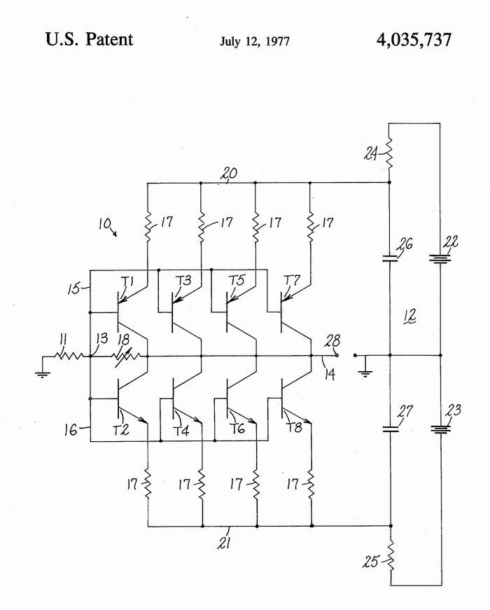

In this patent (John Curl's), the MC catridge's impedance is used as a part of voltage divider (11). MC's impedance is low, below 5ohm.
I see this is smart. Mr. Curl, why you abandoned this approach? Isn't that this approach makes full use of the current generated by MC catridge?

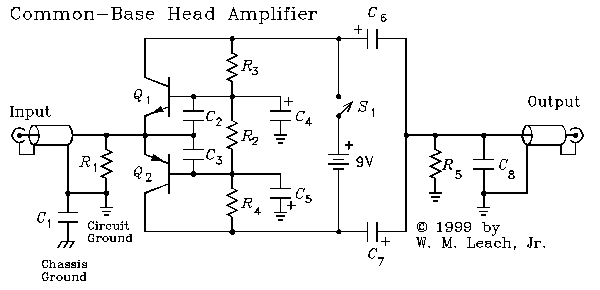

My MC stage from 1977 was a common-base design, similar
in concept to Leach's except that it was single-ended.
It ran the bias through the cartridge, and works just fine,
although it will expose any bad connection ruthlessly.
I personally found that common base does not work as well as common emitter, because most MC cartridges don't really like to be loaded down that much.
We (Levinson and I) made a common base version of the JC-1 and called it the JC-1 AC and JC-1 DC. It sounded worse than the original JC-1 with many cartridges. In fact I took a JC-1 AC and put a switch to change it from common base to common emitter. It was obvious in the comparison.
