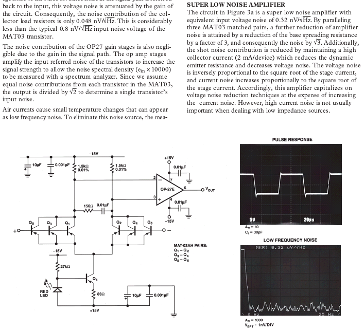

To shorten discussion: My Vendetta input stage made of jfets, has a self noise of 0.4nV/rt-Hz. That is 10 ohms noise folks!
Good day Mr Curl,
Wow, that's fantastic! :bigeyes:
But still, you haven't convinced me. :sorry:
With 3XMAT03 you get 0.32nV/rtHz :lickface:
see application note below.
Cheers, Edmond.

2SK369 for as low as 2 quarters, and that's about 15 times cheaper than the price of an MAT03 or an MAT02 cost (me) two decades ago, some folks even bothered to build phono stages with MAT03/MAT02 in parallel back then.(The A versions as listed on the AD schematic)
Maybe Mr Curl can estimate what the cost of the Vendetta phono would have amounted to if he had gone for low noise matched AD parts.

I wasn't aware of the existence of these devices. So probably, they are the winners, that is, if you don't mind a max. offset of 100mV. Any idea how much they cost?
