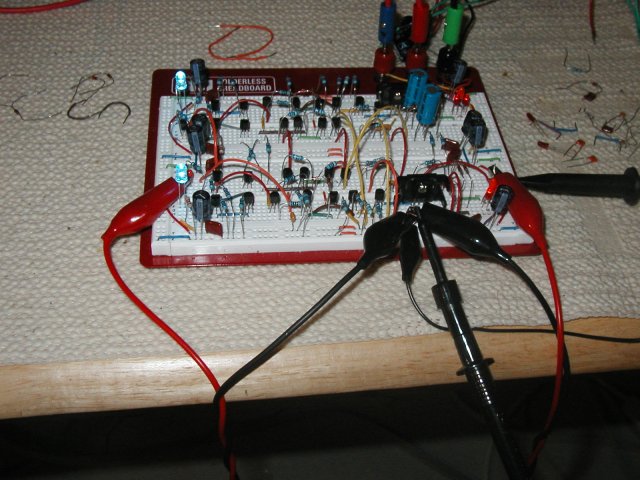

I have just completed the preliminary evaluation of your design as in #1207 and I am quite dissapointed on the distortion performance. While the circuit simulates amazingly well in PSPICE, I have a breadboarded version here (with all precautions, star ground circuit, etc...) using 2N5401/2N5551 and 2SB649/2SD669 that I can't get a THD-20 under 0.01%. I have experimented with the multitude of poles and zeroes in your design, from marginally stable to a large phase margin, withouth much success in terms of THD-20.
Using the same breadboarding approach and the same bipolar devices I was able to easily bring Glen's design to a THD-20 under 10ppm, by adjusting the two pole compensation.
Things are still under evaluation, however it seems to me that, for whatever reason, your circuit has a "fighting VAS" issue. Have you implemented your design? Any special issues I should take care of?

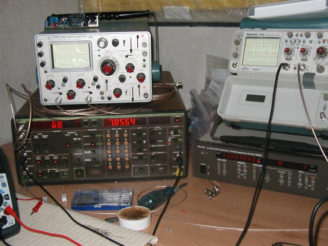

That is precisely how I clamped the thing. The schematic is on Glen's web site, unfortunately it seems to be down now. What is strange is the combination of latchup and low frequency oscillation.
I've found this morning Glen's input stage and VAS on a breadbord, removed the clamp diodes, quickly wired and powered it up at +/- 30V and got a few shots (to follow) to illustrate the latchup/oscillation effect.
syn08

It was almost independent on the signal level, but was frequency dependent, and 0.01% was at 1KHz. At 20KHz it was almost 0.08%. Yes, I'm comparing with Glen's 12W design.
I would expect a cascoded VAS to occasionally oscillate, but not at 3KHz...

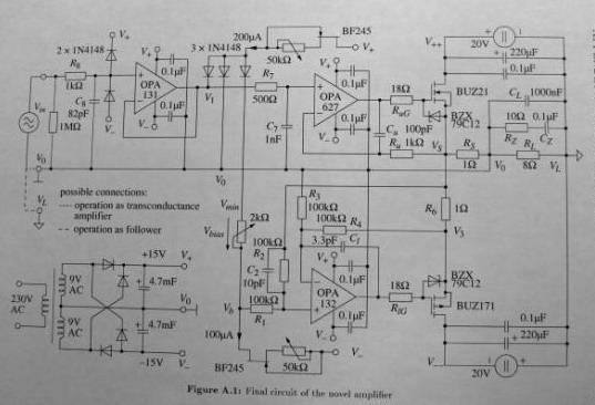

Why is this method not popular? 1 transistor (bipolar/mosfet) is driven by 1 opamp, we can get very high impedance input of output stage with very low output impedance. (won't load the VAS so much that the loading will cause distortion of VAS output while the emitor/source node will be corrected by the opamp towards the input of the opamp)
Look at the upper OPA627 driving BUZ21 in follower mode.
Floating +/-15V can be made by simple bootstrapping towards the output node.

Do not believe simulations much. THD simulations sometimes fit, sometimes absolutely not.
syn08, I am sure you have checked PCB or breadboarding, especially NFB return point (physical placement).
