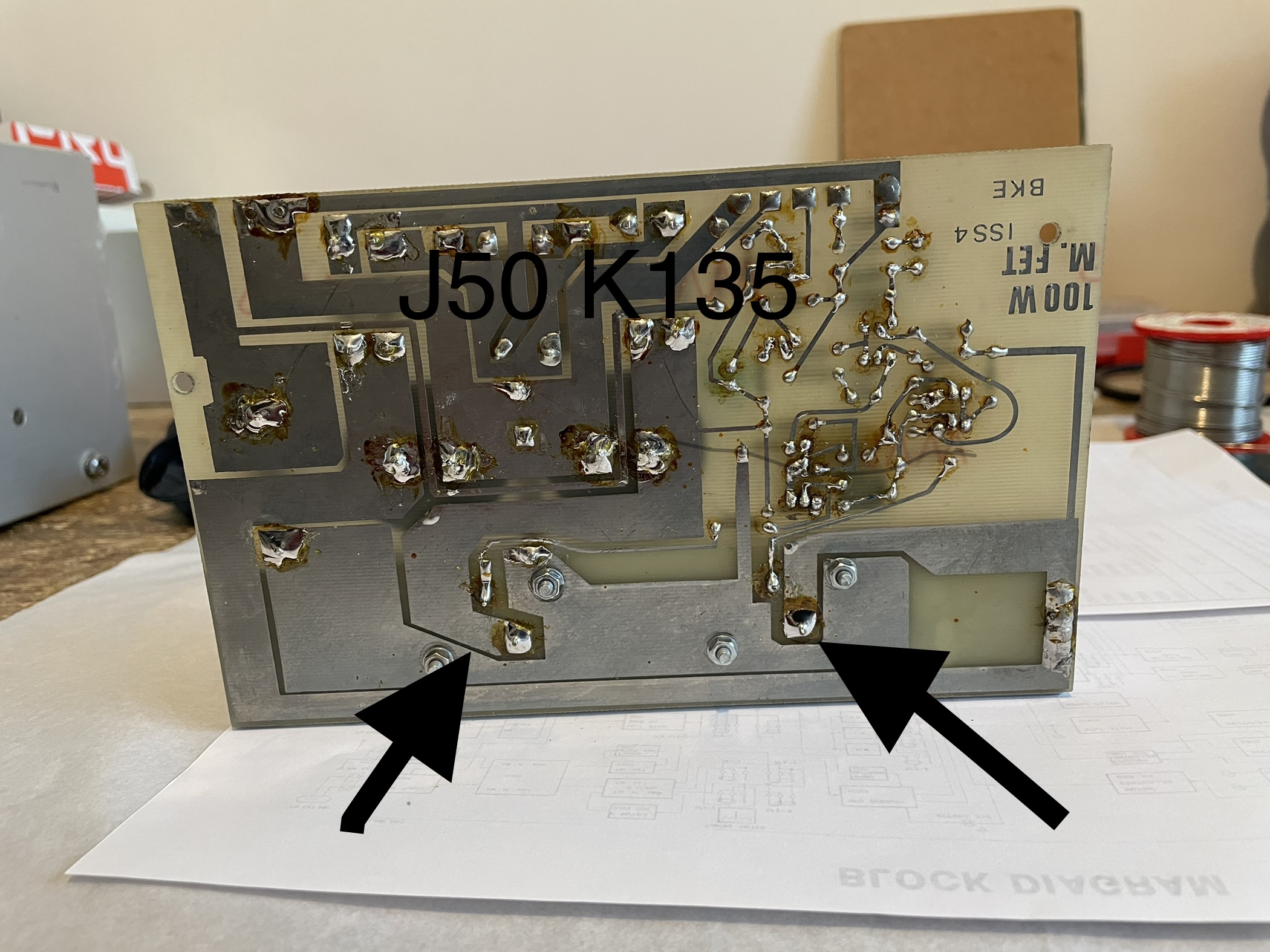

Did notice k135 one side is lifted not sure how that’s happened so it’s not sitting on mica or pressed against heat sink. Like say when tapped tends to drop right down otherwise it’s sitting at 38v now and 6.8k resistor got 50v on one side. Obviously drops as output drops.
So maybe new j50 k135 by loooks of it. Everything else is bang on with other module.

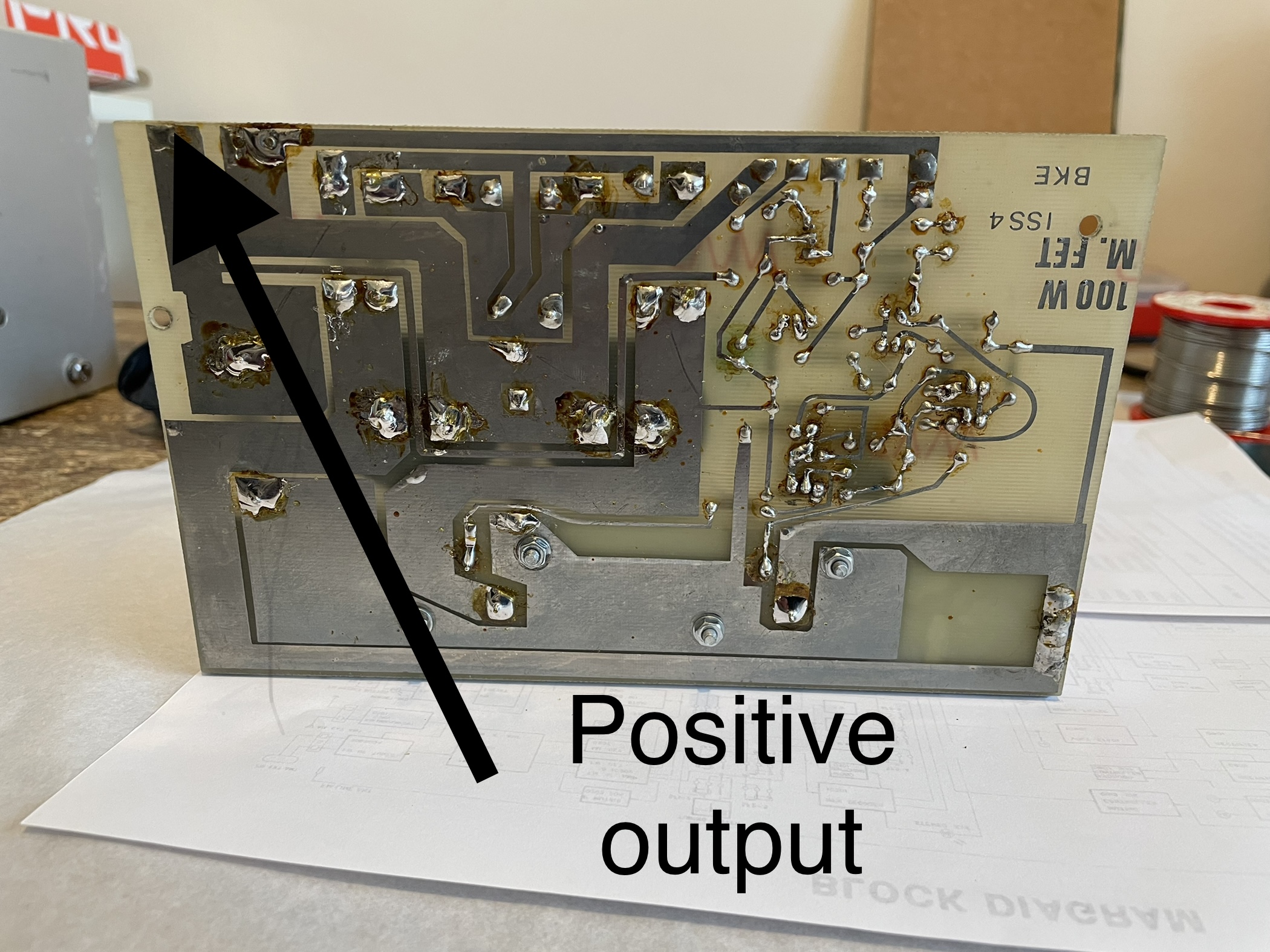

Do you mean the output voltage drops from 38Vdc to 1.5mV when you apply pressure?
If one side is lifted you may well have a connection problem.
Tighten the mounting screws, resolder the pins then check that the transistor case is isolated from the heatsink.
Take a picture of the solder side of the board.
Once you've done that check the output voltage again.

Already did all that. No difference. I'll take picture of board underneath later. Bit fed up with it don't make any sense.
Yes if you tap j50 or k135 or move the +,ve pin around it all drops to 1.6mV which is more or less perfect 0mV. But the k135 is isolated from the heatsink via mica washers and compound but one side has a good 1mm gap from bottom of case to the mics washer. If that s gonna make any difference not sure but then it does not explain why itssame for J50 which is flat against heatsink. Screw legs also insulated. Nut obviously touching track on base of board.
Yes it drops from 38v now to 1.6mV when tapped or the output positive pin moved around lasts about 30 seconds then volts up again. Must be a connection problem in the transistors. There's nothing loosen at all. All connections fine.

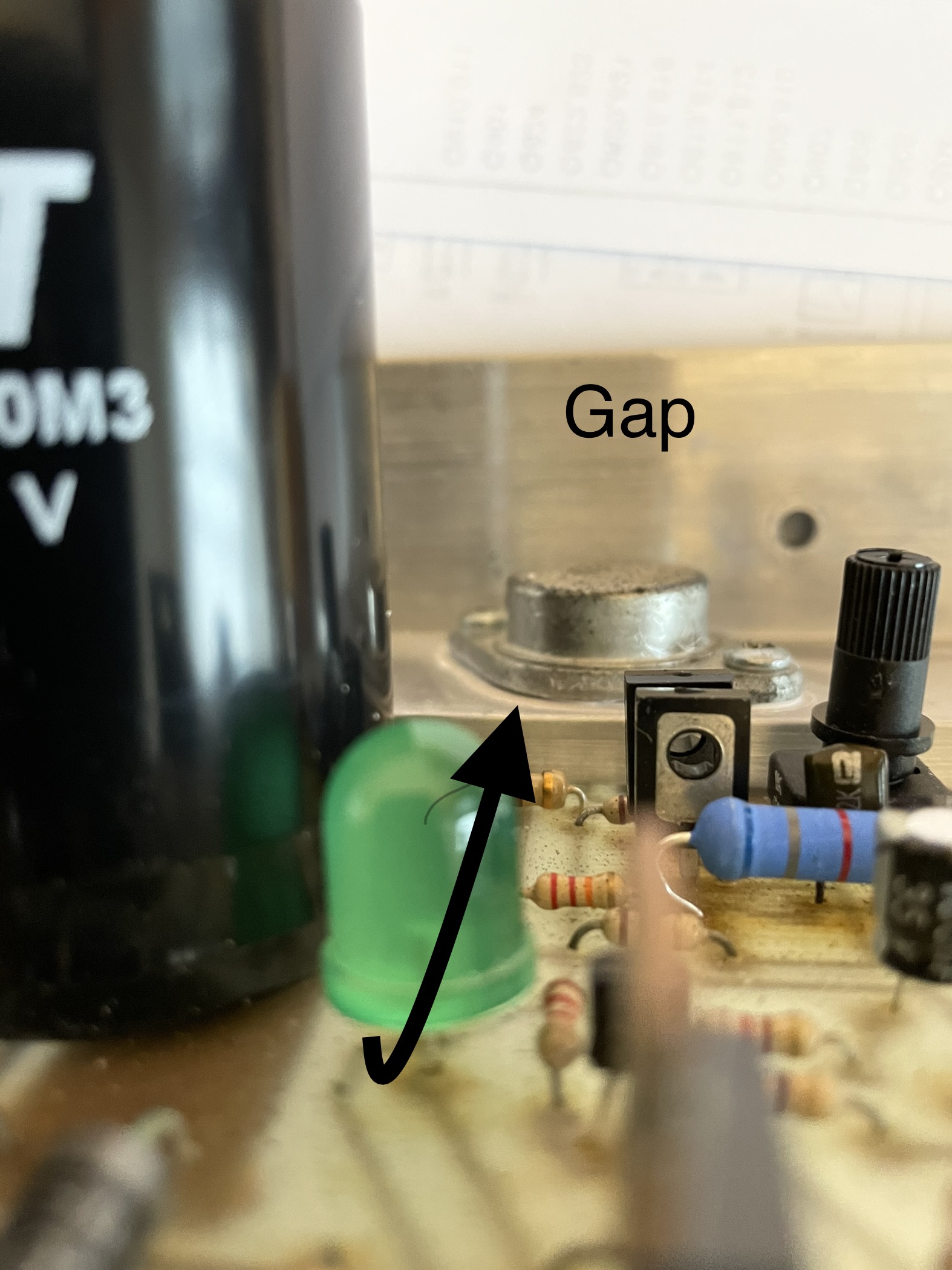

You can't have any "gaps" on the base of the Mosfet it has to be perfectly flat against the aluminium surface (insulated with mica and goo) the correct procedure to attach this type of device is without the pins soldered to the board underneath and yes you can put "sleeves" in the pins but not necessary if enough clearance is observed in the holes.
Like I mentioned before dessolder the 2 pins from the cans, bolt it down properly and only then solder them back.
Yes as mentioned I did not just tighten up I desoldered undone wiggled and re tightened then soldered. Obviously tighten up with pins still soldered to board not gonna make any difference. But although I can’t stand this compound I’ll physically remove it from heat sink and try to re position and hopefully it will sit flat. Either that or it’s somehow got bent up!!!!!
Right the j50 obviously got a slight lift on one side. So no matter how tight you tighten it up it’s not gonna sit flush. All I can do is pack the compound on and all that will do is basically fill the gap. So will that work? I can’t see it being the actual heat sink as it’s 6mm thick.
So what I'm trying to work out is if it's cupped and the edges are not flush that's going to cause the high voltage readings on the output?
I thought these where designed convex so the centre would be flush with the heatsink? As the design flaw was the sides where flush but by tightening up the case caused a concave effect from the middle so the sides where flush but the important part the middle was not flush.
So does that mean it's more important that the middle makes contact as opposed to the sides?

Remove the transistor that's not sitting flat and examine the mounting faces.
I suspect there is something trapped between the device and the heatsink.
