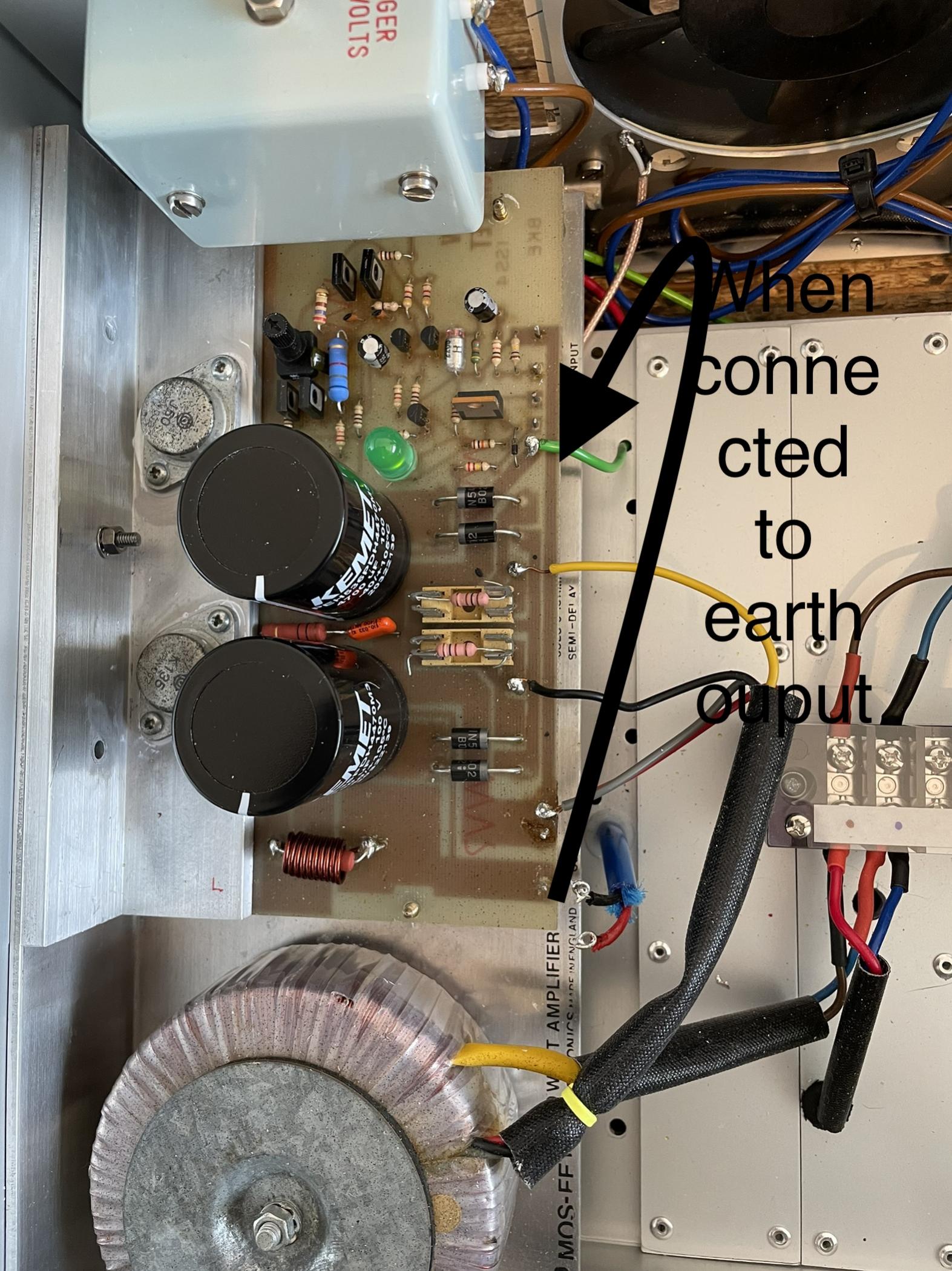

Proper ground ??
Did you made a chassi ground connection or earthed the power lead ?
I checked all the pictures you posted and can't find one with any ground/chassi point but...
You have 3 or 4 ground points on that circuit board so where exactly are you taking the reading from ?
I'm starting to wonder if there is anything wrong with the module or it's just operator error.
They all go to a star ground point on chassis typical valve setup. Less earthing points the better. Yes the mains is earthed pretty critical.
But the other module is also grounded exactly the same so that does not explain why that module is on spec but the other is not. Plus I'm used to taking VAC readings as opposed to VDC readings across a whole circuit. The problem is definitely at the input end and I think the other 100uf cap is bad as again on tapping that the reading shot down to around 6 mV plus again I'm getting a negative reading on it as opposed to positive as per the working module. Plus its at 30mV but the bad side -187.8mV on 100uf cap well out. Plus negative.
Yes readings are taken properly. On output its reference is from 0v rail not grounding point. You don't ground the output on these it goes to 0v. Unless I've got that wrong!
Yeah I think that’s what it is. Re did the transistors all same voltages as other board this time apart from one which is on the leg of the cap.
It's time to start measuring *drop*, when you're measuring *drop*!😉 Instead of measuring each to ground and then subtracting, put one probe on each end of the part to be measured -- one measurement / no arithmetic. If you need something logical to site for a rationale, try 'the meter gives higher resolution'. And stick to DCV exclusively on power amps (except for the inlet fuses, of course).

Got it all VDC good. Yeah re drawn all 0v around the schematic linking what to what as they say now I know where I am on the tracks.
Grounding pretty happy with that and basically use only one spot for that due to having a plate separating the underside from topside the earth bolt in on the side of chassis so I can just clip on forget about it. Otherwise I’d be flipping it over all time. Yeah could just touch any part of chassis but I like to work from the source.

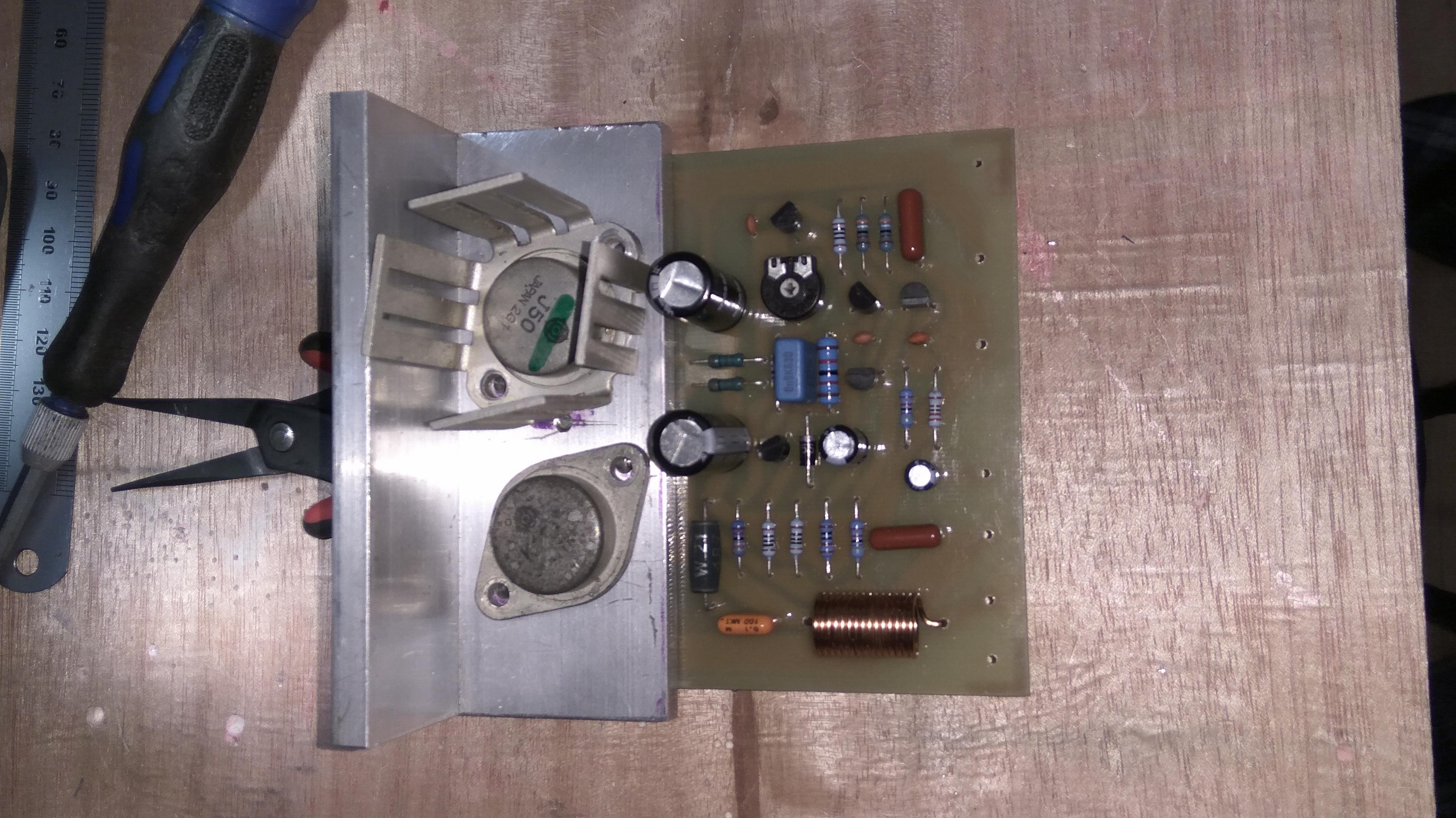

Well re soldered some solder joints bit to close using loupe. The zener the hole and track around it missing just been bridged with the leg so new bit copper track in there. Quite a few cold solder joints all re done. Noticed the track with just the big lumps solder on nothing attached to them had also been bridged but you can see the track is not meant to be soldered over as both tracks have a defined stop line between them. So it was connecting to the psu and other psu definitely not meant to be that way otherwise the track would be just one length. So that’s why it was soldered when it did not need to be.
Oh acetone and clean off flux. Quite a bit there as I still use lead solder flows better plus don’t need as much heat less chance damage to components. So will see if done trick or not.
J50/K135
Almost there just need to install the output pair and look for a suitable power supply.
Before someone mentions the transistor yoga, yes it's a budget build and if I'm happy with it I may buy the original transistor critters but for now will have to do.
