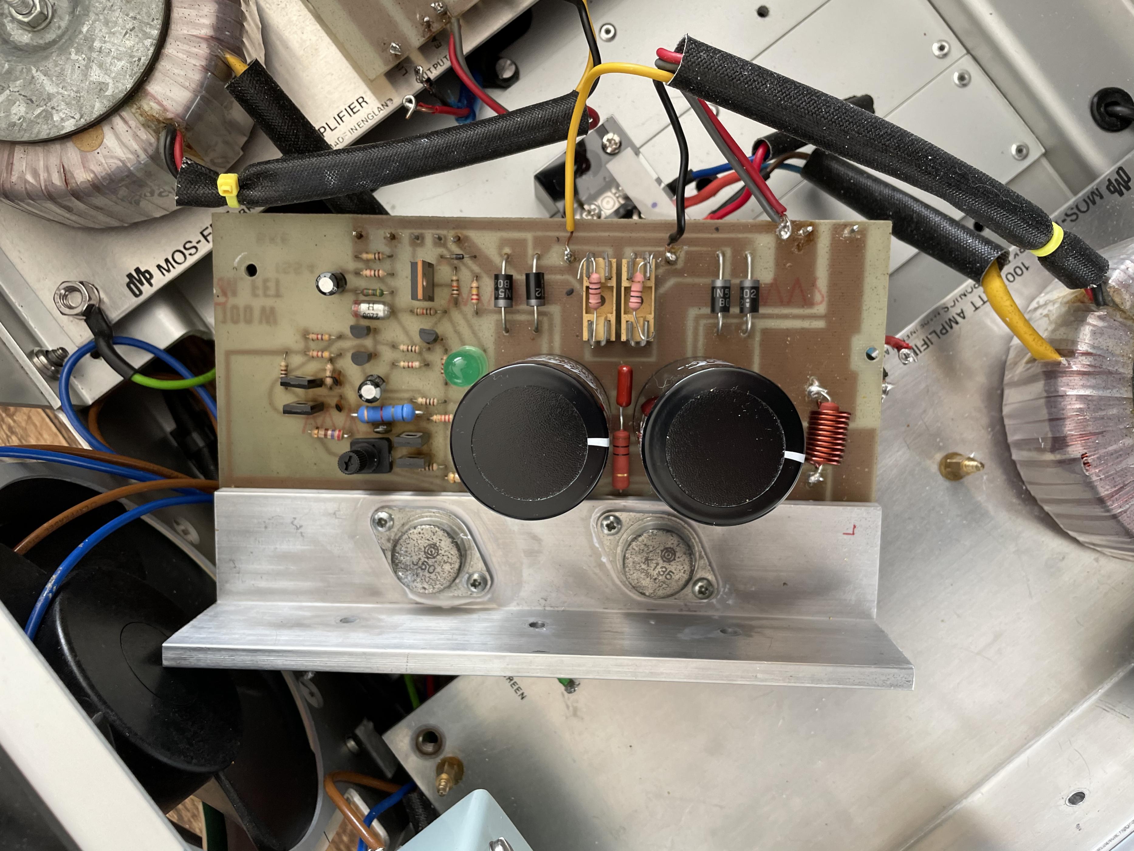

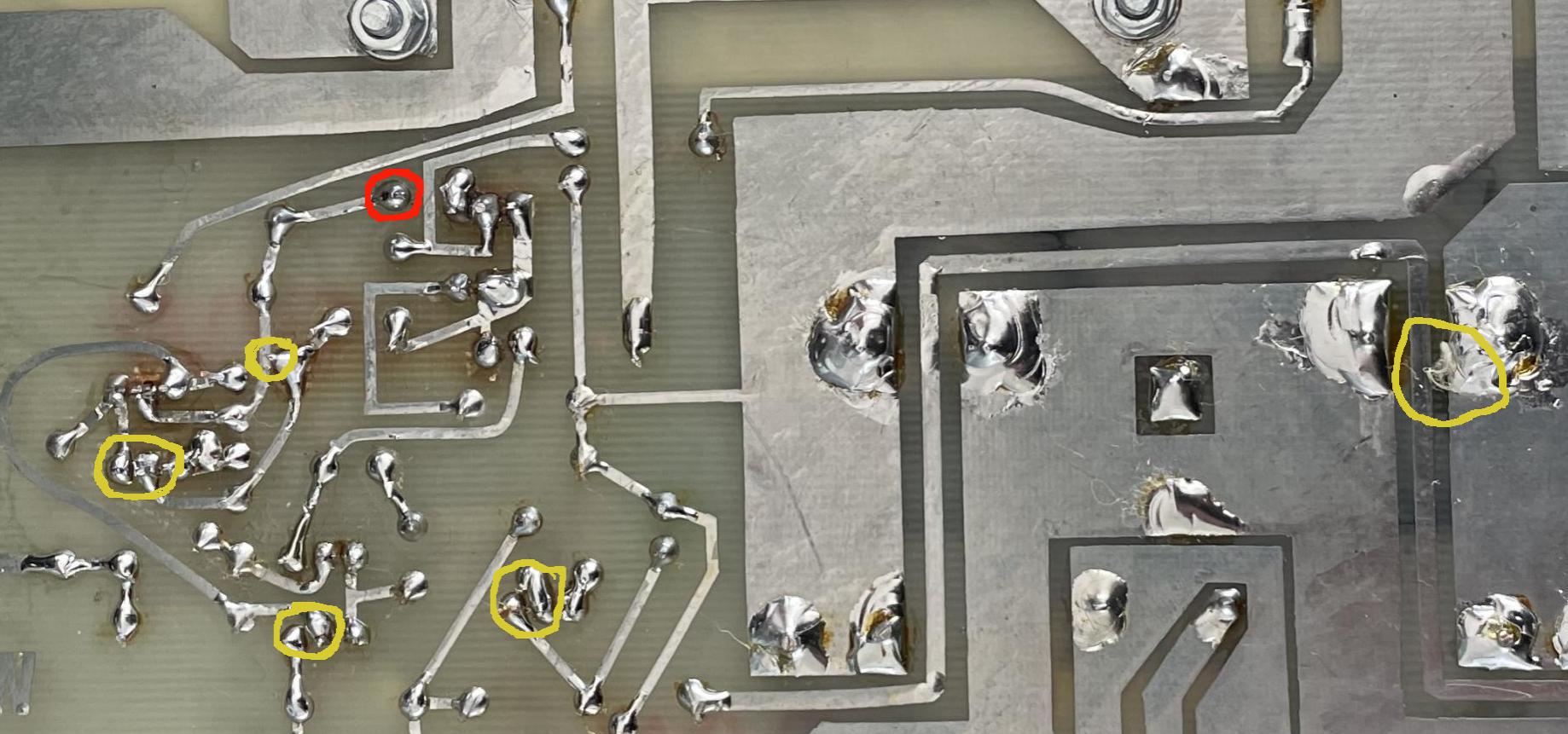

Fingers crossed that’s done trick went over the entire tracks with a C10 & X 15 loupe no cracks some of the board is bulging but has not affect the tracks where they are.
All I have not done is put new pins in.
The zener tested out of circuit that’s fine. I think it’s the old geranium type but the code on it is not very comprehensible. C52 55x I’ve found no reference to that code.
That zener (12v) is only a voltage reference for the TIP29C transistor and that part of the circuit doesn't affect the workings of the power stage ( R19, ZD1 and TR10 are just a power supply for the VU Meter)
Yeah I knew that after posting.
Anyhow got the output down to 9.6v from 40v large drop but still no where it should be. I'll set the trimmer exact to other see what happens.
Then I'll measure across the resistors already did couple but all seem to be at the input end where readings are not tallying up with the other module. So trimmer in a minute then have another measure. I'm convinced it's that other 100uf cap bad batch as they where cheapies don't usually skimp on price. Or that 2200pf foil cracked internally. Or it is the J50 not making proper contact. Still see in a minute.

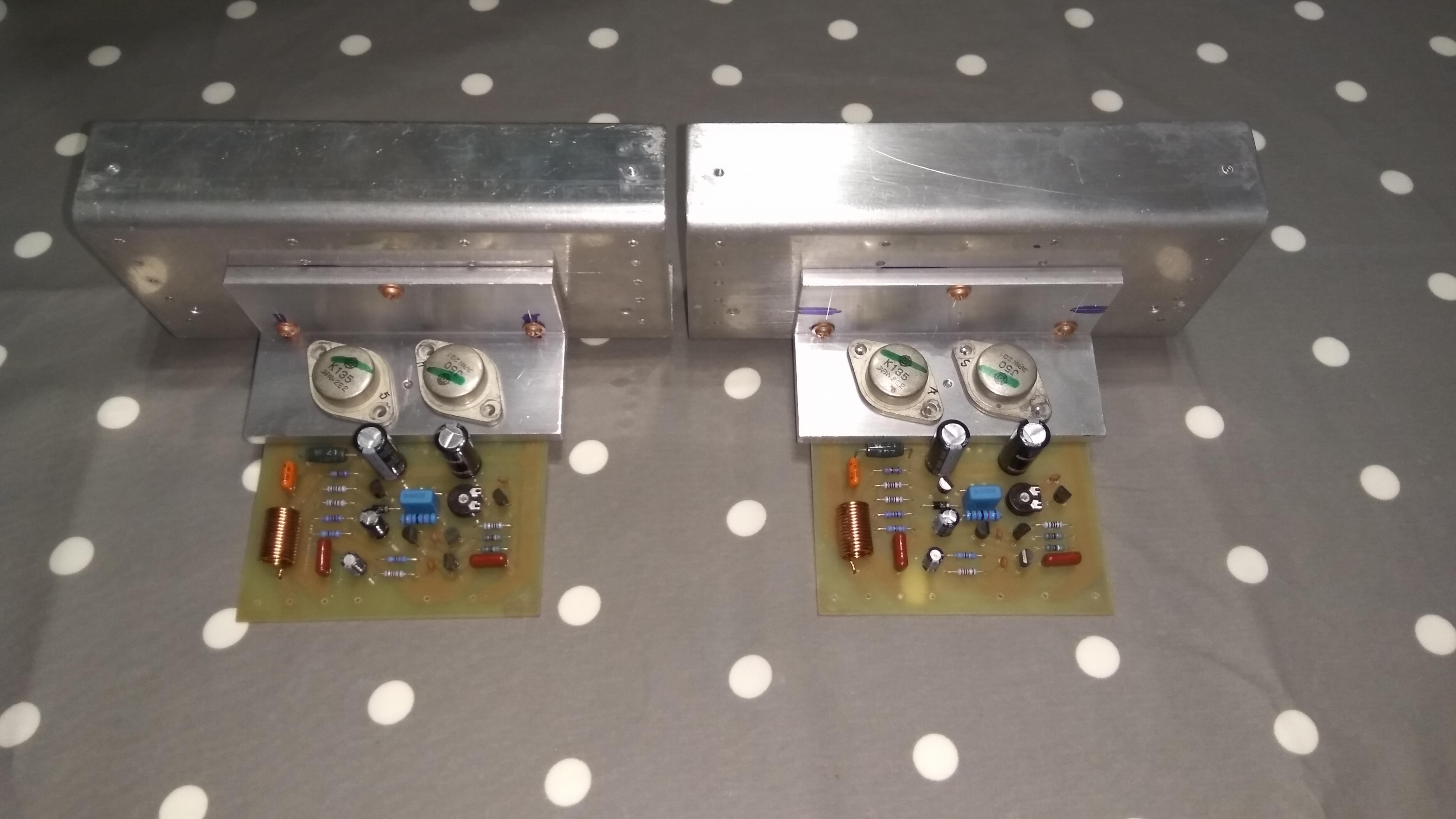

(mirror board in the bin)
In my warped mind I was thinking all the components except the TO3s could be flipped.
TO3s gate and drain would be reversed but then if they were rotated 180deg the pins would be the right way round but offset.
Hence my comment drill 4 new holes.
I think it would have looked cool (weird but cool) having mirror imaged left and right boards in an amp.
Totally understand your approach to having them correct though.

I give up on this one never known anything like it.
C3 C1 R18 across to C7 R15 R17(L1) all either too high or too low. So think it’s leading to the mosfets. Plus readings jumping all over the place I’m assuming the current is swinging back and forth causing that. Definitely nothing broke on track unless it’s a hairline crack but all been checked. Everything else seems to be sitting the same.
Got sil pad coming tomorrow so I’ll clean of that crap put them on then swap round the mosfets and see what happens. But for now had enough. Don’t usually give up but none of it makes any sense to me at all. How on earth can linked components be fine then the other is way off.

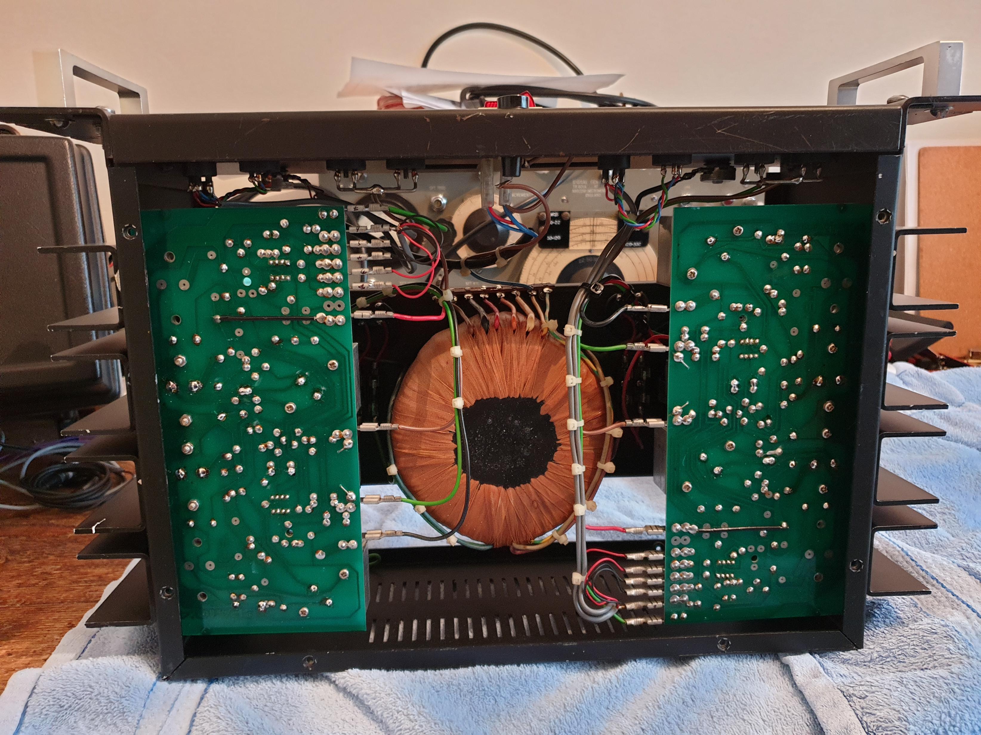

Cheers guys yeah definitely need break from it. Ha ha I’ll take a picture of underside for ya tomorrow as I’ve gotta unbolt it remove couple leads so I can flip it. Here’s a good pic I was given for free good old Millard. I re done the frame though was bit tatty.

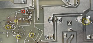

Yep will do. Yeah cleaned up okay definitely no hairline cracks in it. Had a bloody good look even slightly bent the board just to see if anything separated.
Can see that solder joint not completely covered the lead out bit of an air bubble. Well what it looks like. Still see tomorrow. Me sil pad came blimey pretty thick could put that on back of the transistors and main heatsink and the mosfets on heatsink. Nice and soft so it will definitely fill any gaps.

Skimmed the thread but not carefully. Is the problem transient loud crackles & pops? If so, I've looked at 6 MF100 amps with this problem: two mine and four belonging to a friend, all bought in the 90s IIRC, all ended up crackling with large, fast transients 5-10 years later - I forget exactly.
I never managed to locate the problem. It wasn't poor soldering or PCB cracks, for sure, as I resoldered a couple and checked continuity everywhere. Interestingly, similar problems did not manifest in some MF200/300models bought around the same time.
I suspect it was due to overheating somehow: In the 00s sometime, BK said they'd not had any reports of this problem, which surprised me due to there being 6/6 failures. I guess therefore it was how they were deployed rather than the design. We probably didn't have enough heatsinking. I focused on the voltage amplifier stage (MJE340?, I forget) as that was too hot, but changing the transistor didn't help.
Sorry that's not encouraging, but I thought it might be of interest.
