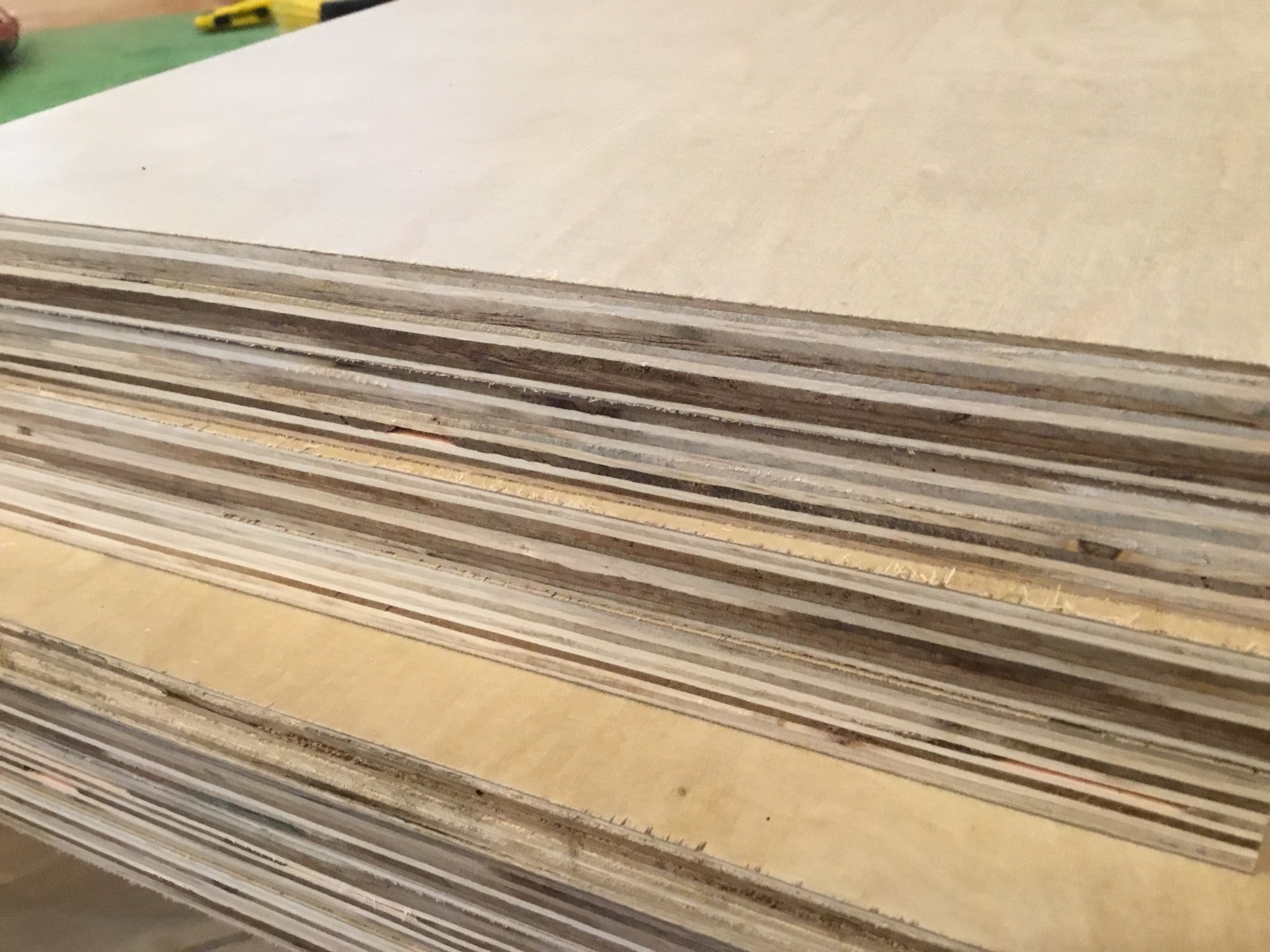

I picked up a few sheets of 3/4” birch ply that my supplier just got in, its made in Taiwan is about all I know about it besides it looks/feels pretty decent for the money ($48/sheet) i‘ll do some forensics on it tomorrow when I break it down.
Going to use it to build some proto-types…….its nowhere near baltic birch quality but we‘ll see how it goes.
Well upon further inspection its 13 ply and seems well glued with minimal voids, BUT……it‘s a very very thin outer layer of birch that is paper backed! First glance at the supplier looked like 1/32” or so of veneer…….nope. Good enough for prototypes at less than half the cost of marine grade fir but not end game.
13 layers should make it stiff and well damped. It will be better to know the wood(s) variety. But imo if above 700kg/m3 you are good not only for the proto.
HumbleHomeMadeHifi use that thickness for its last 105 liters bass cabinet with a 12" . If you use some bracing inside with CLD technique it should be more than enough I surmise.

Upon dissection the white wood is definately poplar (can see the green heart wood) but that brown stuff is a hard heavy wood almost like teak but surely not? I’m not too familiar with Vietnamese woods, but they did a pretty good job manufacturing it.

Perhaps Mahogany red wood that has the same spec than poplar...Quite comon when made in China for instance.
If you feel it is too ligth when knocking it. Doubling with 1 cm OSB (very stiff, heavy and damped) behind or 0.5 mm HDF on the front baffle is surely ok. Also 3/4 hdf for the front baffle standalone too. Use CLD bracing technic for bracing to avoid coupling vibrations between the cabinets sides.
