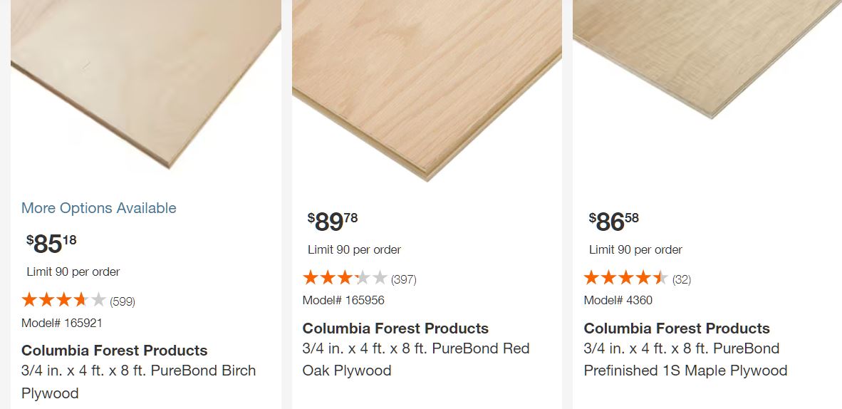

Sorry, I got the brand confused with another name. The plywood I am taking about is called “Purebond”
From mfg: “Veneered construction gives these decorative PureBond Birch Plywood Project Panels the strength, flatness and rigidity to satisfy the most discerning craftsman. Each 7-ply sheet is assembled with a soy-based PureBond technology to fortify its structural integrity, with the added benefit of being formaldehyde-free so it wills not off-gas toxic fumes over time as UF-constructed plywood is known to do. The decorative veneers are precision-cut from domestically grown, sustainably harvested birch trees, producing visually alluring wood grains on the face and back of the panel that exhibit the warmth, beauty and timeless quality of natural hardwood. Featuring real timber throughout, the core veneer consists of natural yellow poplar substrate laid in alternating cross bands for utmost stability and ruggedness. It's a cost-competitive alternative to urea formaldehyde-laden plywood and will not contribute to air-quality degradation like composite panels. For extraordinary results on your next carpentry or woodworking project, add this 3/4 in. x 4 ft. x 8 ft. panel to your arsenal for construction of cabinets, entertainment centers, wall panels, coffee tables, bookcases, toy chests, benches, desks, shelves and more. The decorative veneers have a smooth finish that allows painting or staining to make it uniquely yours.”
3/4in x 8ft x 4ft and made by Columbia Forest Products. Can be bought at HD.
Purebond is in stock at Home Depot.

The Purebond is less expensive than traditional Baltic birch ply (5x5 ft x 3/4in) and feels lighter. But for speaker building, I think it’s a fine alternative and the surface finish seems more blemish free.

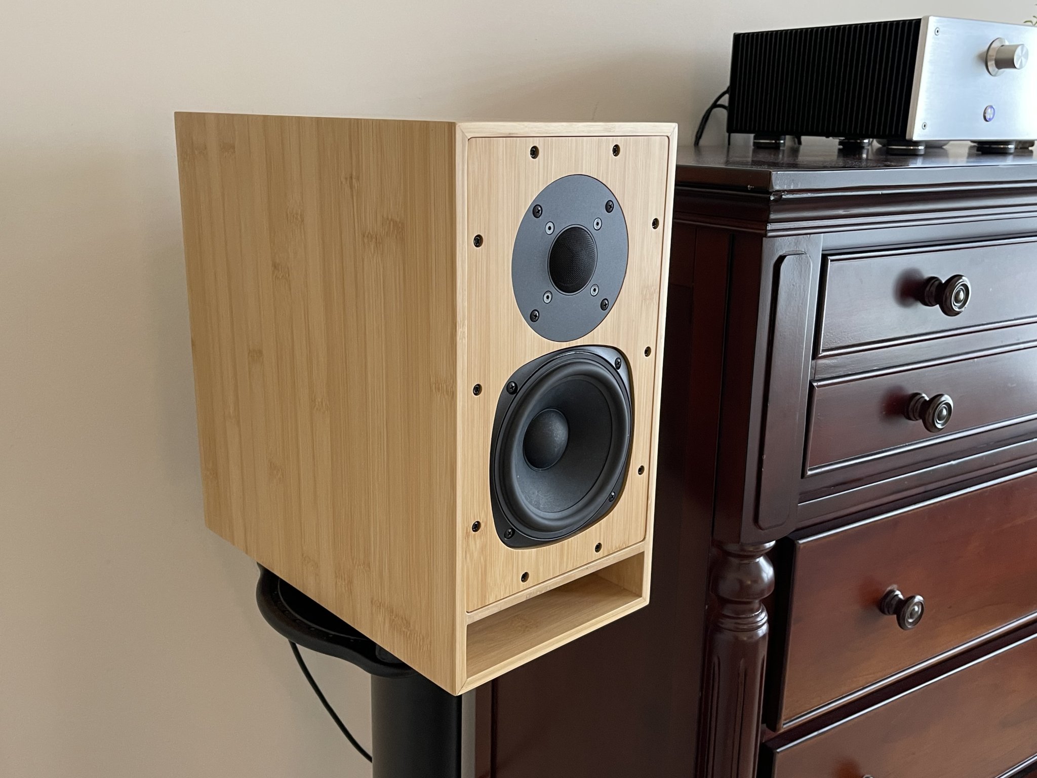

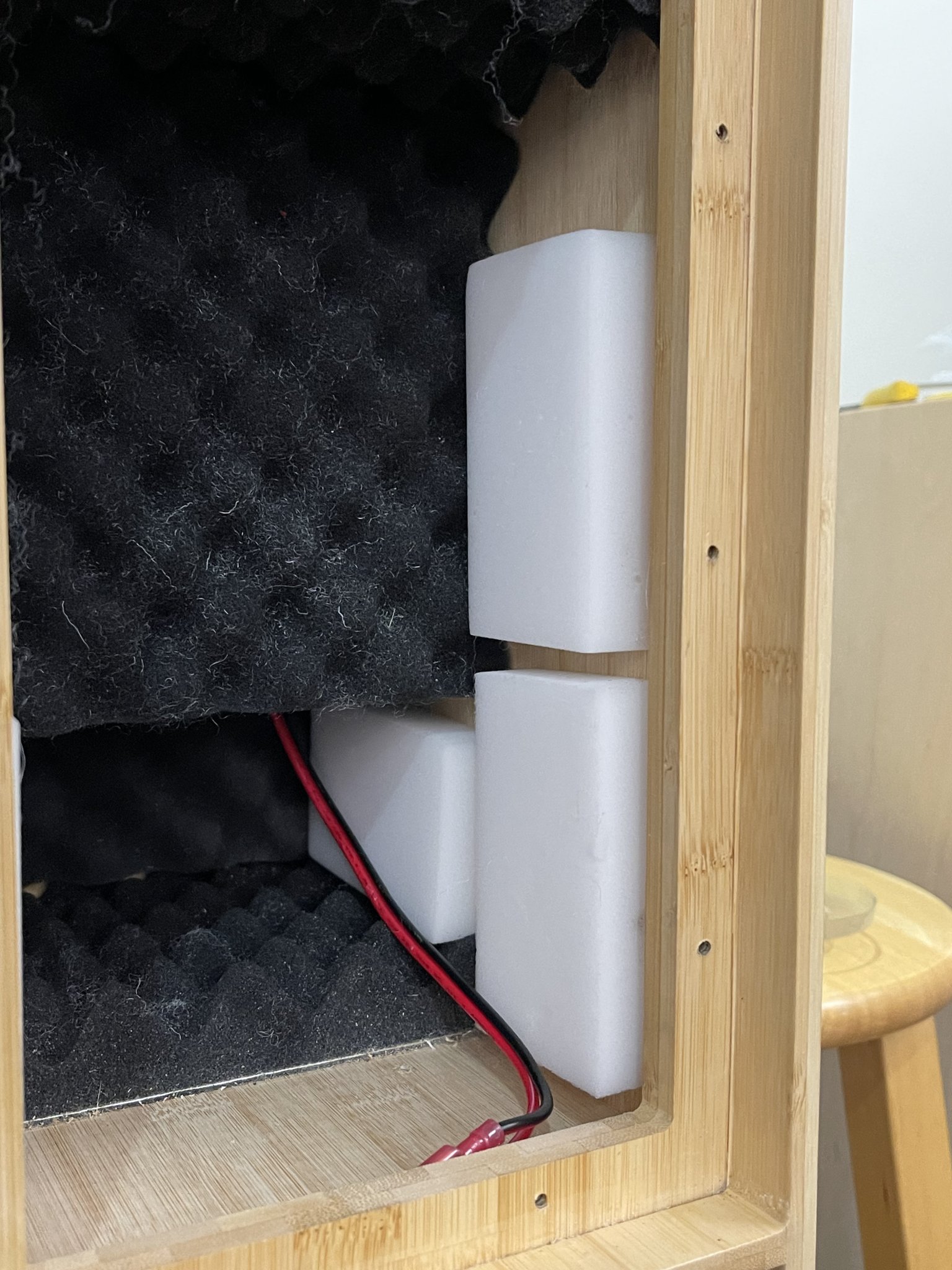

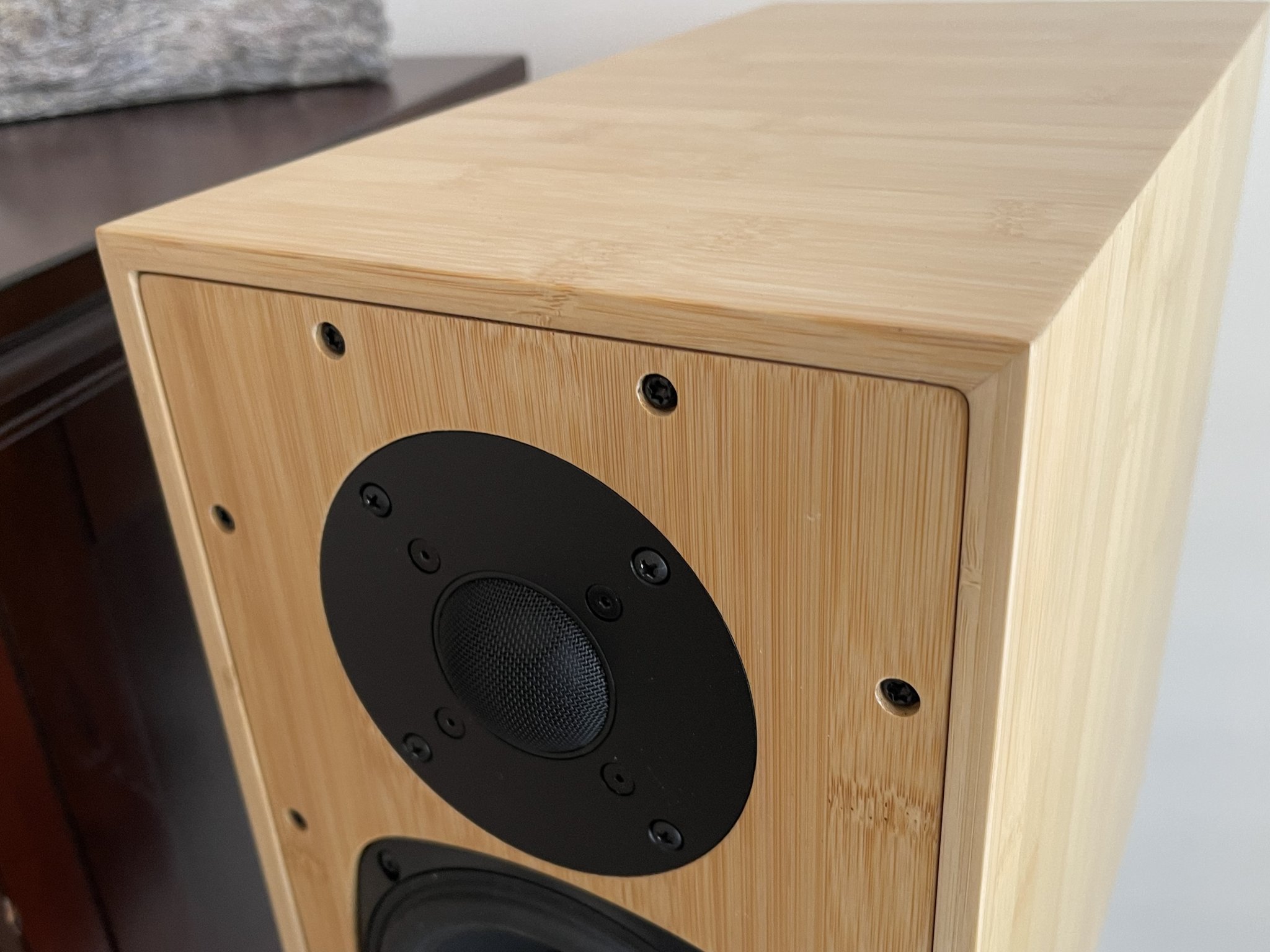

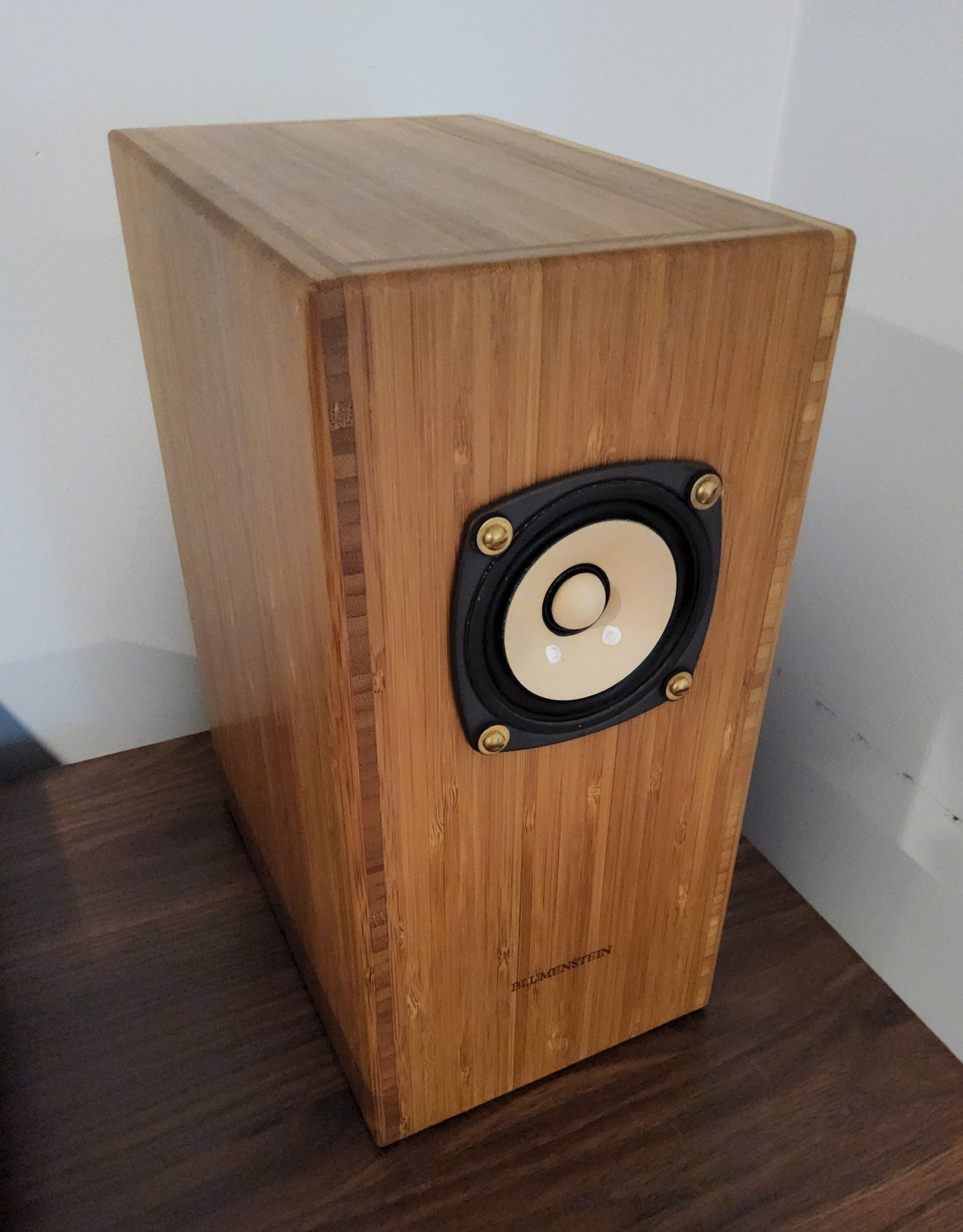

I love using bamboo for cabinets. I recently made a TL in one:
No idea how it is with single sheets.I thought bamboo ply was very expensive and hard to get in single sheets? but that's based on info from many years ago.
But you can get cutting boards for somewhere between 2-5 bucks or so.
I don’t know what mine is called but it appears to be a bunch of thinner strips bonded together and machined smooth. It takes CNC cuts and mill operations well. Like hard plastic or aluminum basically. Hard stuff and very durable.
Price is comparable to Russian BB plywood - a tad more expensive. But now that Russian BB is basically unobtanium, the bamboo is really a nice alternative.

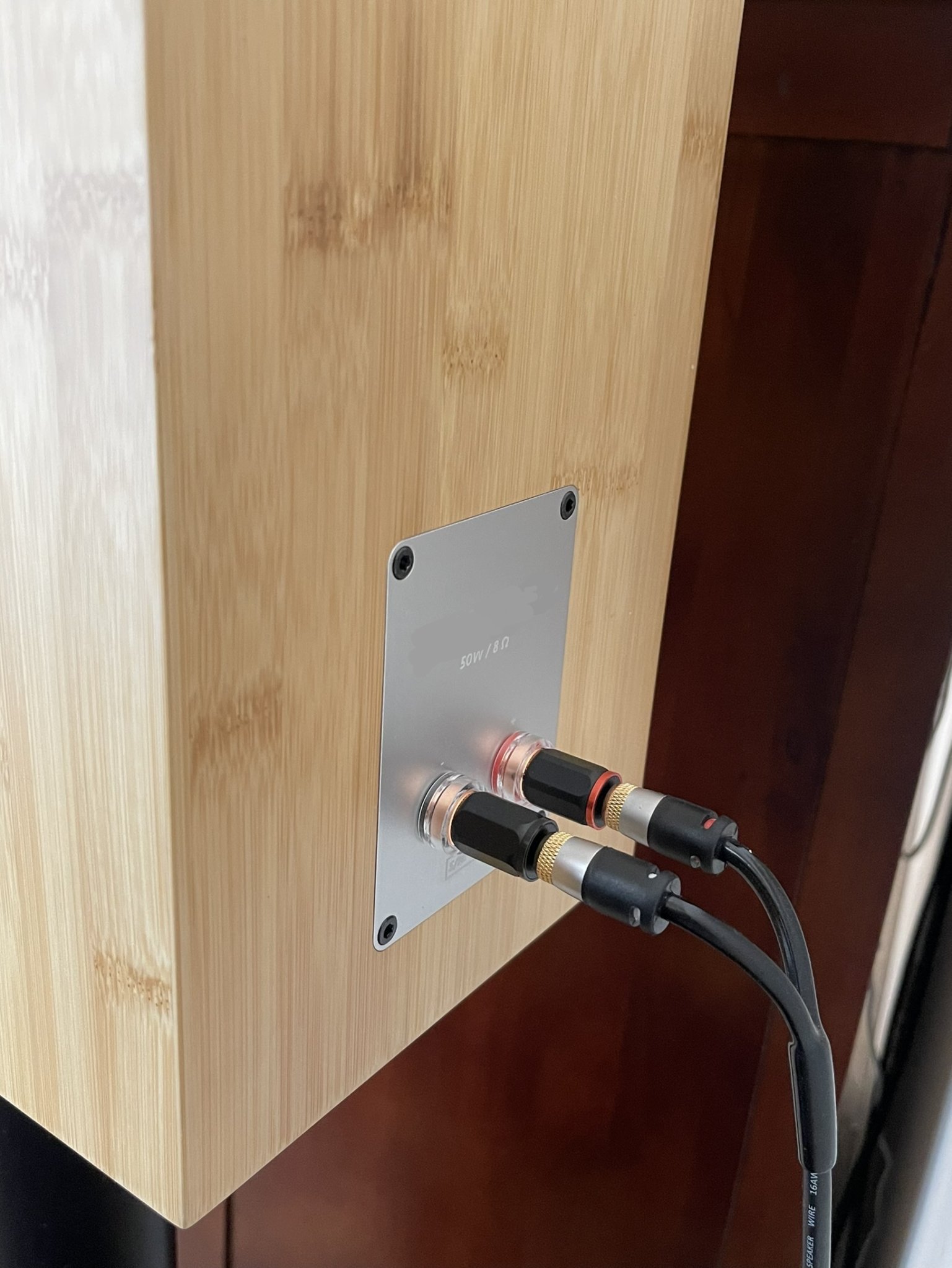

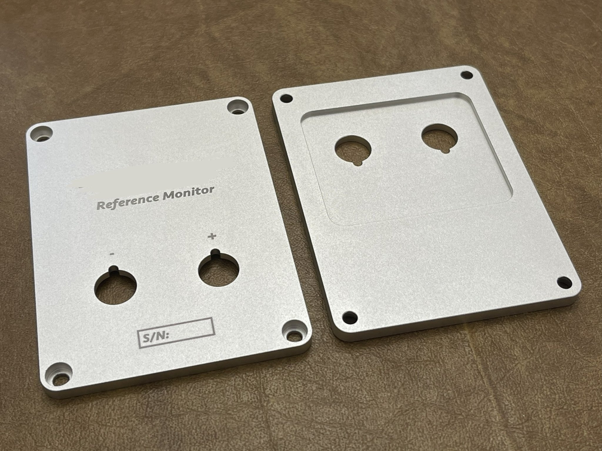

Thanks! Yes, those are also custom made CNC binding post plates. Designed for Viborg binding posts. 5mm thick and rebated to 3mm where the posts go. I originally designed them for a certain model commercial speaker but find them so handy, I reuse the design on many new speakers now that I design. I also keep a dozen or so blank ones (unlabeled) for use on development and prototyping.
