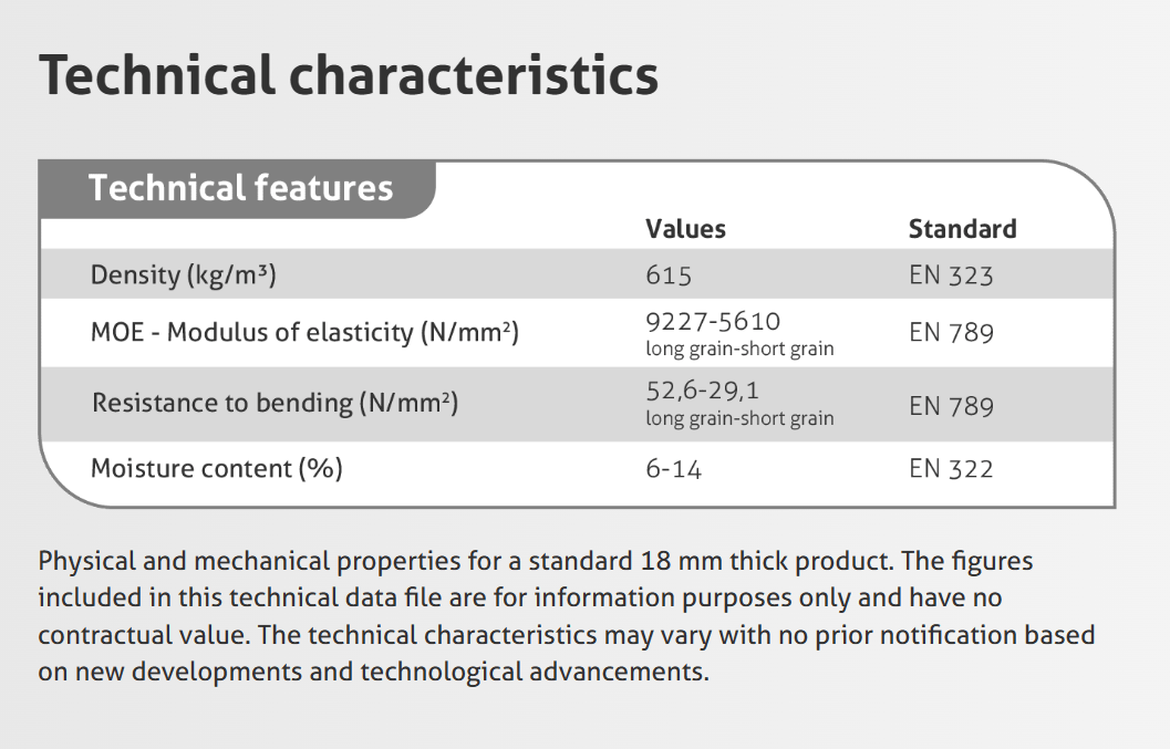

They call this 'reinforced' because of the mix with Eucalyptus which they say gives it good mechanical strength. FWIW this is a long way from typical cheap 'poplar plywood' you might find in a DIY store. Im not sure how Birch throughout compares but here is the spec:
https://www.garnica.one/en-uk/plywood-panels/range/reinforced/reinforced-globulus-maple.html

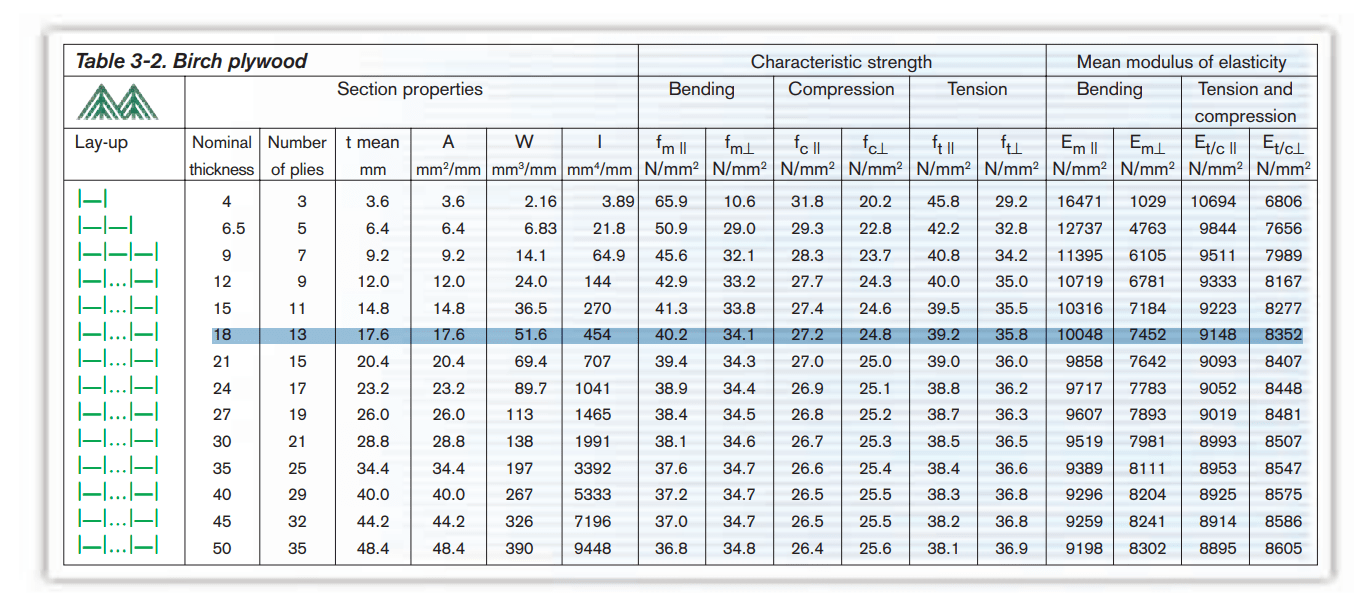

So Birch plywood has a modulus of elasticity of 10,000 Long grain - 7000 Short grain.
https://www.wisaplywood.com/siteassets/documents/brochures/handbook-en.pdf

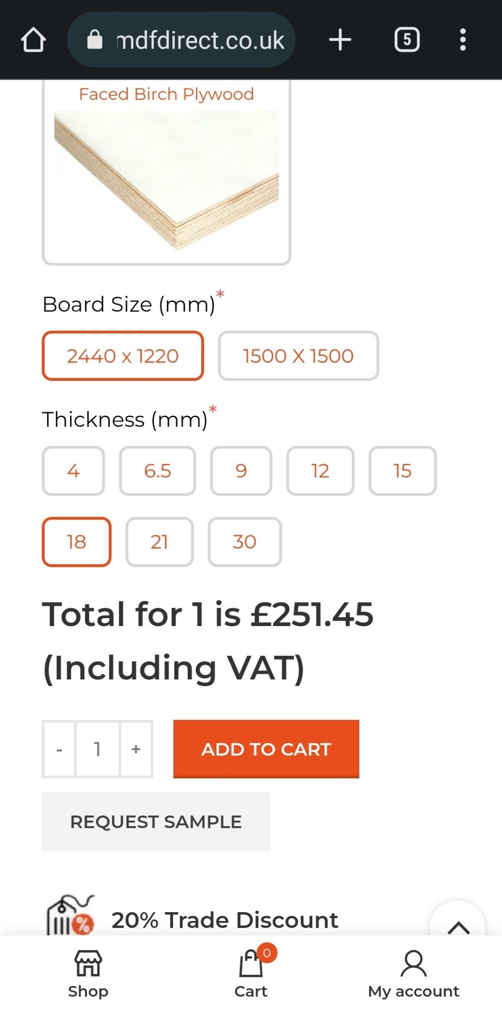

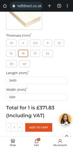

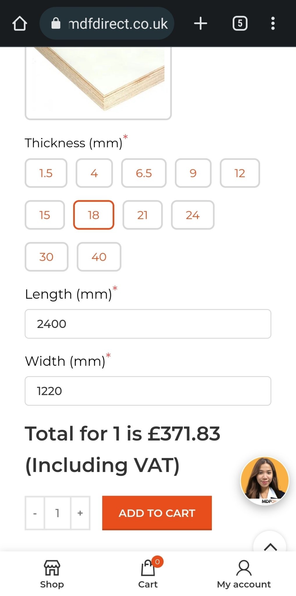

Trust me, when their current stock runs out they will have trouble to replenish it at this time.Birch ply isn’t difficult to obtain in the uk. It’s easy to buy whole sheets or cut to size. I’ve use mdfdirect.co.uk in the past.
But at this price they might never run out.

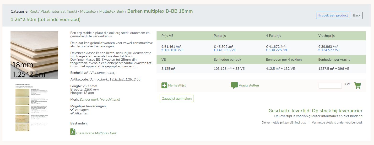

That is very expensive, In Belgium i pay about 160€ (139£) per plate (VE called in this printscreen) of 125x250cm 18mm B-BB quality birch multiplex at Dewahout. And it's in stock (but not at the location of delivery) so delivery times are probally about a week.Trust me, when their current stock runs out they will have trouble to replenish it at this time.
But at this price they might never run out. View attachment 1199554
