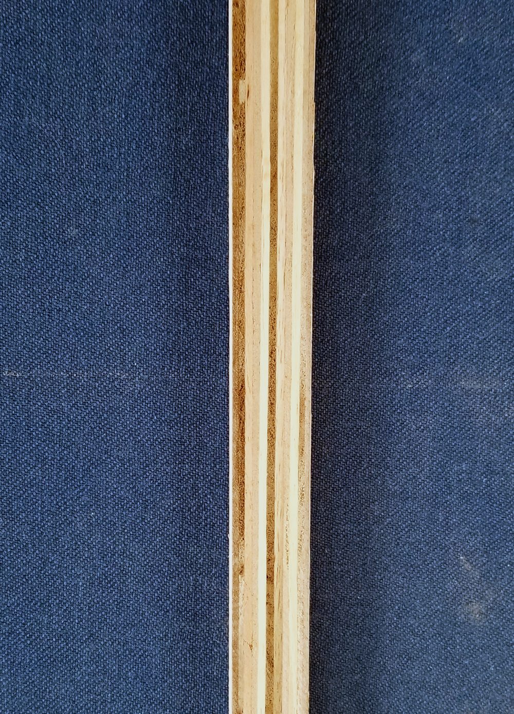

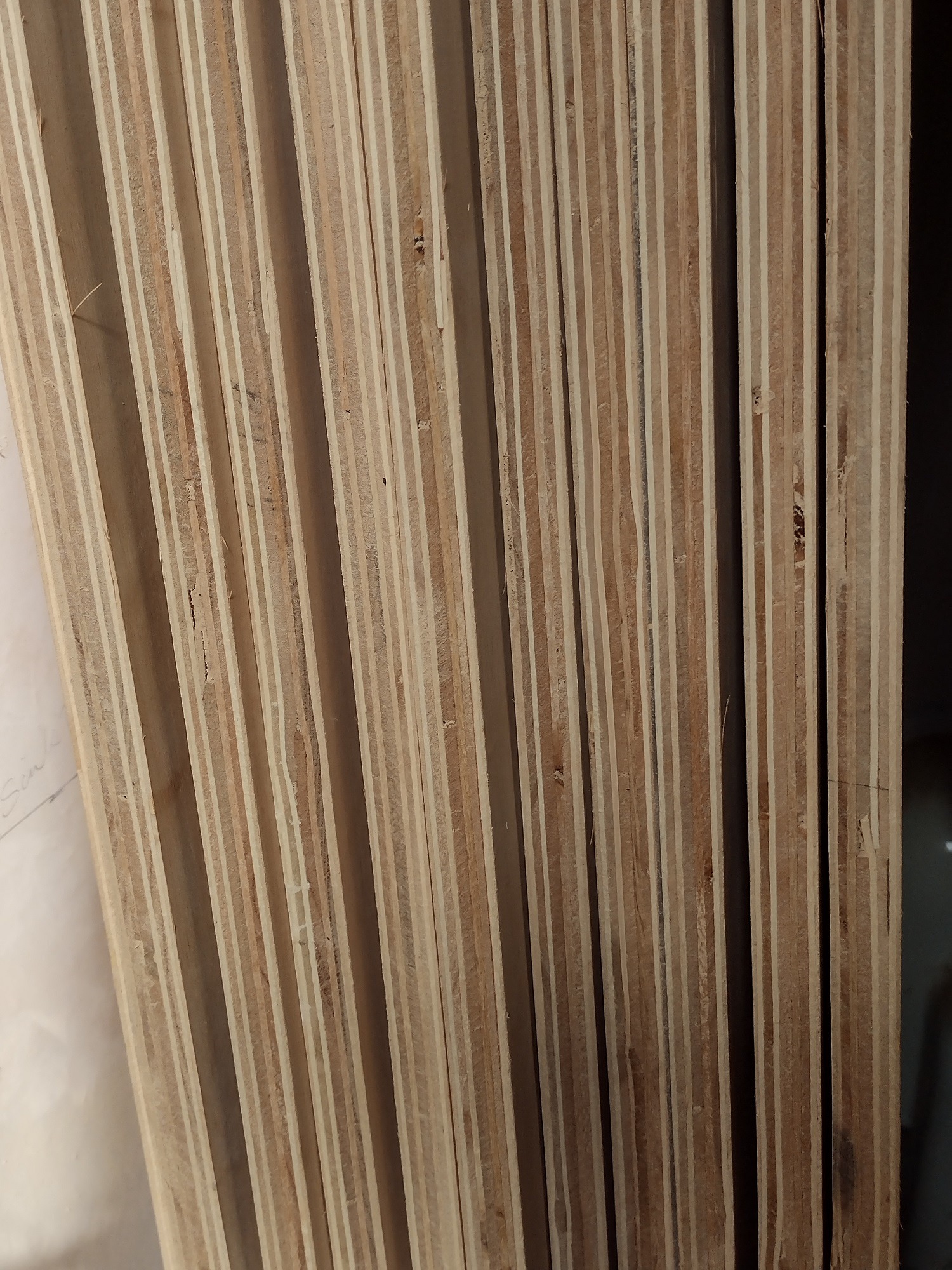

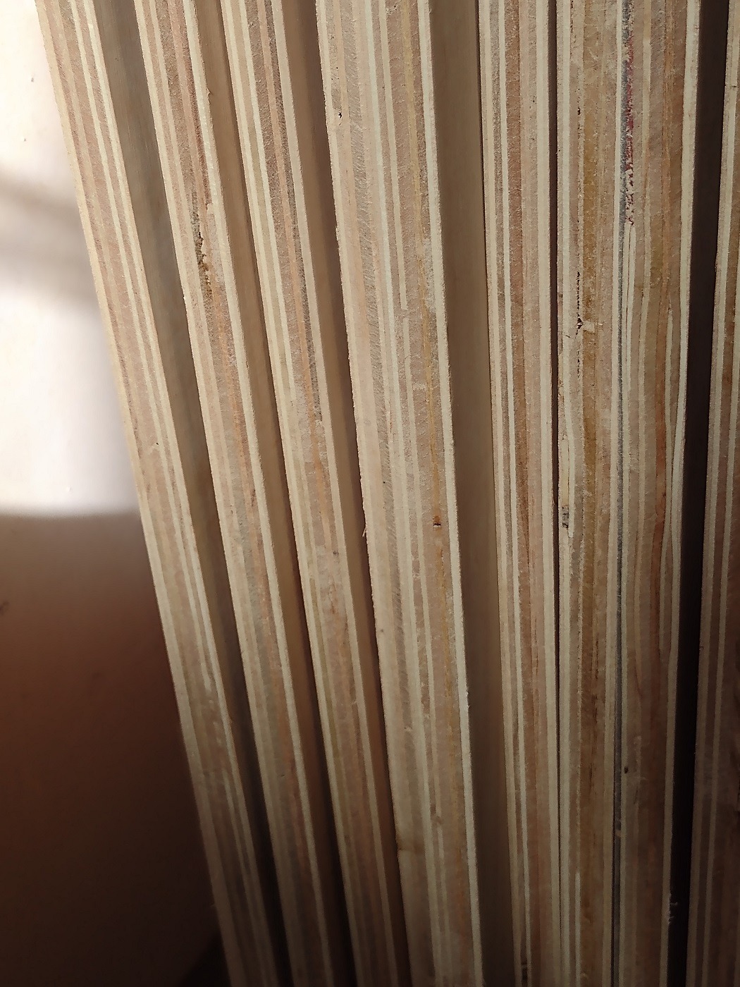

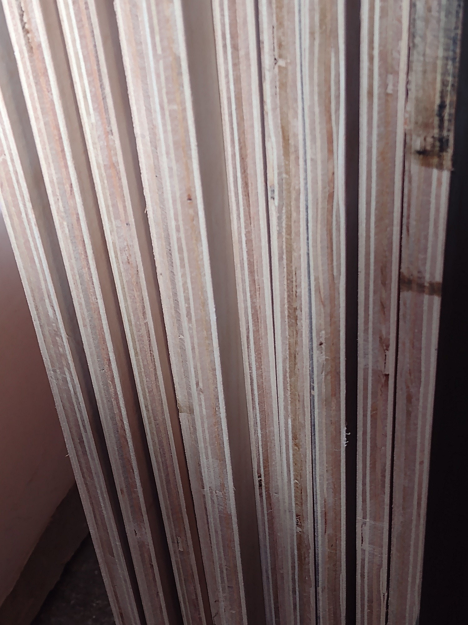

Maybe we have found the same "birch" plywood as a sub for BB. My supplier said it's from Vietnam...Upon dissection the white wood is definately poplar (can see the green heart wood) but that brown stuff is a hard heavy wood almost like teak but surely not? I’m not too familiar with Vietnamese woods, but they did a pretty good job manufacturing it.
I got some in 18mm, 15mm, and 12mm.
I've made a could of large subs with the 18mm, and working on a large synergy horn made from the 12mm.
Have to stay, the stuff is a pain. 18mm bows in the rack in afew weeks faster than 9mm russian BB does in a few years.
Crap just won't stay flat, and bends too easily when clamping. Screw holding into the end grain is passable with 18mm, but a joke with 12mm, and not so good with 15mm.
I'm spending so much time 'custom' fitting everything together due to not being able to get the precision of working with BB.
Aaargh...gotta keep searching..
Yah, after working with it for a couple days i’m not real impressed either……lowes has a 3/4“ marine grade a/b fir, but its $150 a sheet, i‘ve used it before and is great to work with, the Vietnamese stuff is under $50 a sheet for 3/4” so definitely good enough for prototyping!
I have used some "birch" plywood from Home Depot recently, it was labeled "made in Indonesia". The interior plies were a soft, low density white wood, that seemed very similar to poplar... but I am not sure it was. I was allergic to the dust, and I have never been (nor am I now) allergic to the poplar core of Canadian or US plywood. And it makes sense that in a country of tropical forests, the local lumber industry would find an appropriate local tree, something white and low density like poplar. How dumb would it be to ship poplar from north America into southeast Asia to make plywood which was then shipped to north America. Very dumb... especially since the making of plywood is not labor intensive. It is mostly done by automation.
