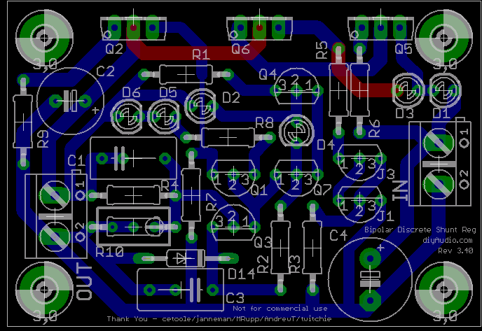

Latest changes:
- moved D1 and D3 to the left to shorten those traces
- made a single layer version for etching/testing but requires 1 jumper at R5 and not shown on the layout but the holes are there
I'm attaching the pdfs for etching if someone wants to build/test this in single layer form - copper is not mirrored, silk layer is mirrored
Thanks guys and sorry for missing your names. I'm sure everyone appreciates all your efforts and I think it deserves to be mentioned again.
Latest changes:

The board looks real good.
I like that R5 and R6 were moved away from the power transistors. Thanks for all the effort that you have put into this layout.

janneman said:It's almost looking like a board I would have designed 😀
Jan Didden
BDP said:The board looks real good.I like that R5 and R6 were moved away from the power transistors. Thanks for all the effort that you have put into this layout.
BDP
😀 thanks for the kind words and thanks for your helpful emails BDP.
moving the resistors was Jan's idea

Q2 and Q6 need at least 20C/W heatsinks.
If you go for more current and/or more input voltage then big sinks may be needed.

Layout - R1
Hello Twitchie,
I was playing with the layout and am confused by your schematic in post 302 versus the layout in post 322. Is there not a connection missing from the current source (collector of Q6) to the rest of the circuit, like R1, D2, etc.. Something looks not quite right? Or is this the wrong layout ? 😕
Hello Twitchie,
Q6 connects to Q2 then to out terminal.
The measuring side taps into the out terminal and not off the current delivery route/trace.
My bad, I can see it now - hmmm, I swear when I looked at the board before it was not there ....
These are the things that happen if you break the link between schematic diagram and layout... (Yes sometimes I'm a PITA 😉 ).
