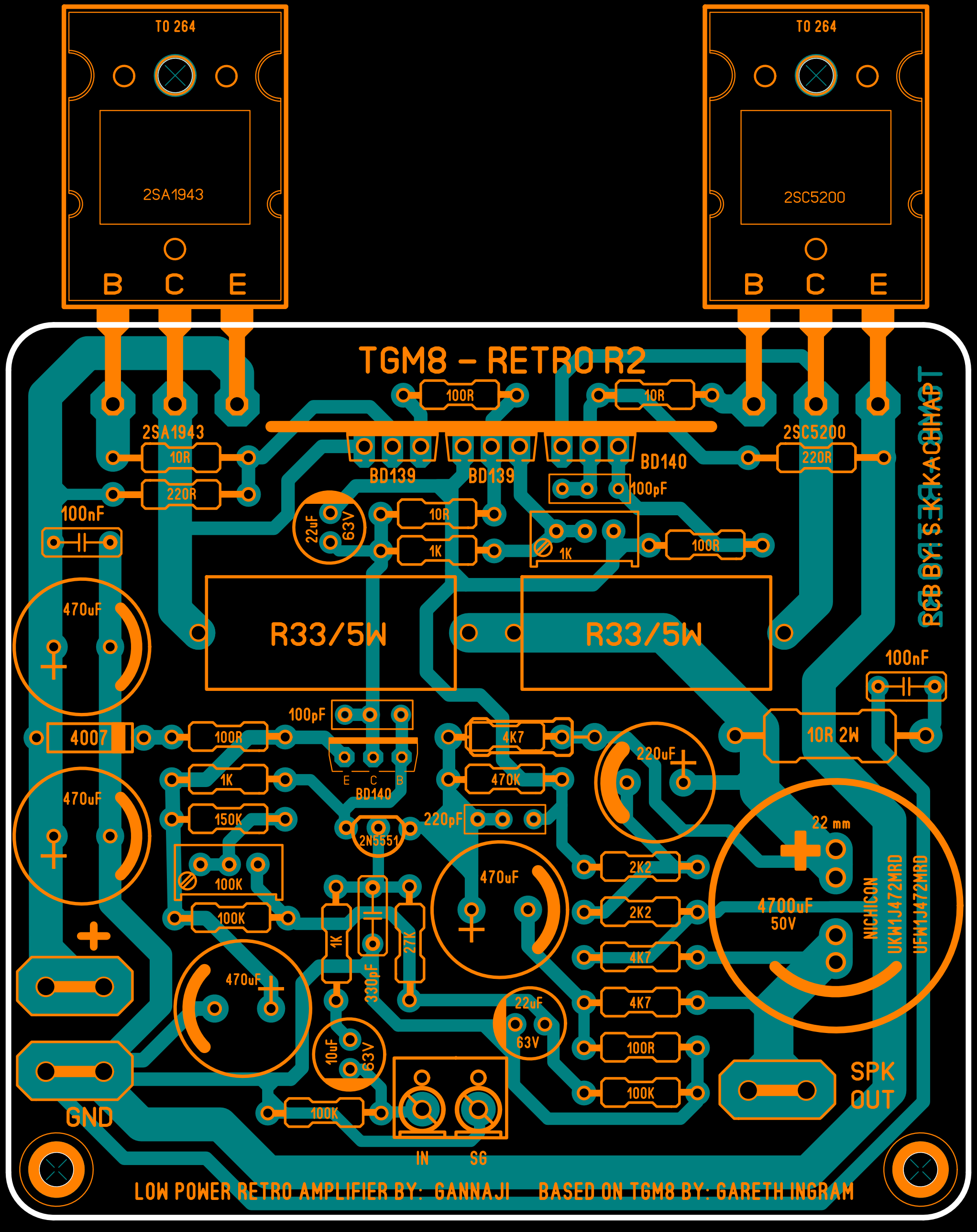

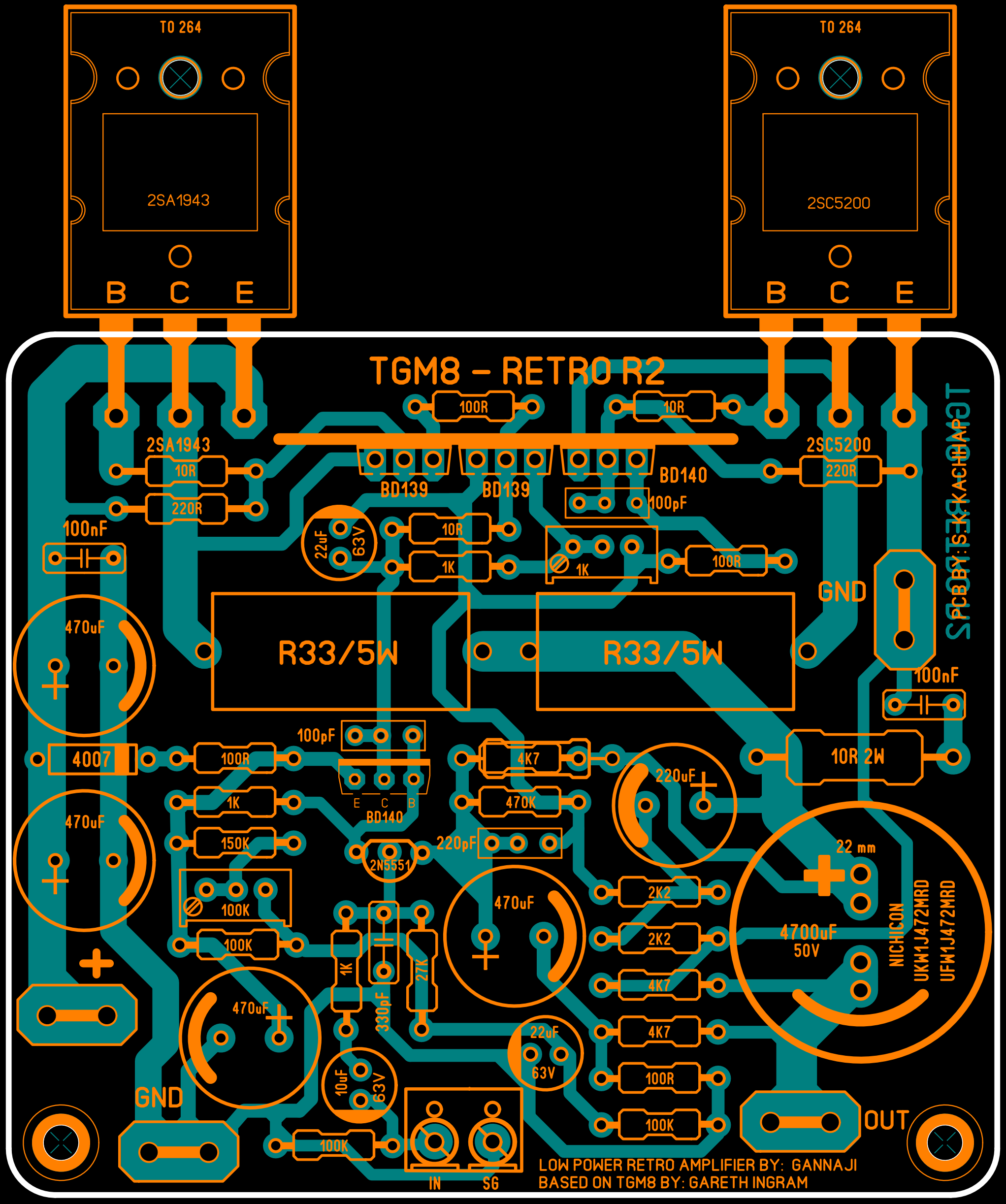

You want to keep Q3, Q4 and Q6 off the main heatsink. Unlike a regular EF output this CFP needs a different thermal control loop. The Vbe and two drivers can all be on a common heatsink but not the same one as the Output devices. I didn't find the drivers needed heatsinking, but you should have the Vbe (Q3) in thermal contact with at least one of the drivers. One way to do this without changing the pcb is to mount these devices standing up and then put a strip of metal across behind them, with insulator if the devices have metal packages, securing the devices to this common strip.

I'm just wondering about the ground routing. Do you see any benefit in an alternative ground connection quick fit lug over next to the output zobel? I thnk what you have is good, I just like to ask questions !
Are there any additional solder pads (with holes) you want to add so that you have some options to move or add parts in case of parasitic oscillations or even just to have some convenient places to rest a probe tip when checking operating voltages ?

Hi Terry, you are too fast.
You didn't used last version on post#122 which was done base on Gareth pointers. All BD's are little back and close.
Any way you could mount drivers Q4 and Q6 and Vbe (Q3) on strip aluminium heatsink.
VR1 100k is use to adjust offset, in this case if you use 50v or 60v supply measurement will half at output,
eg: for 50v supply it should be 25v ( before 4700uF capacitor) .
VR2 is for bias.
Latest version based on Gareth advice.

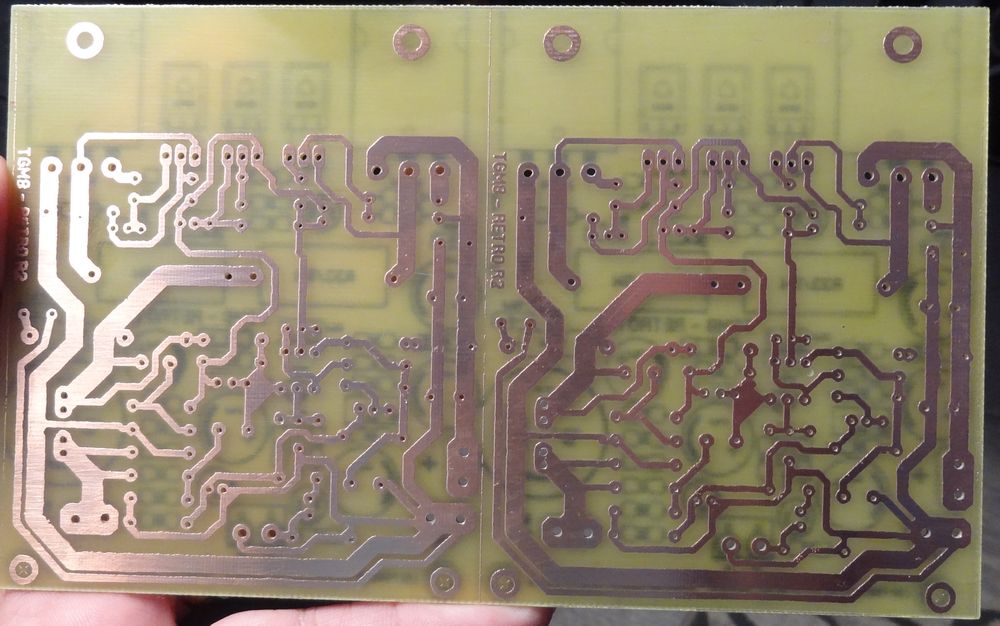

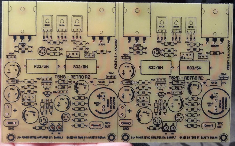

Actually this was etched using the sprint file from post #122. I did adjust things slightly so I could fit it on a 4" x 6.5" board. I didn't notice that the jpg was different than the sprint file. I won't have a problem fashioning a little heatsink for the drivers and vbe.

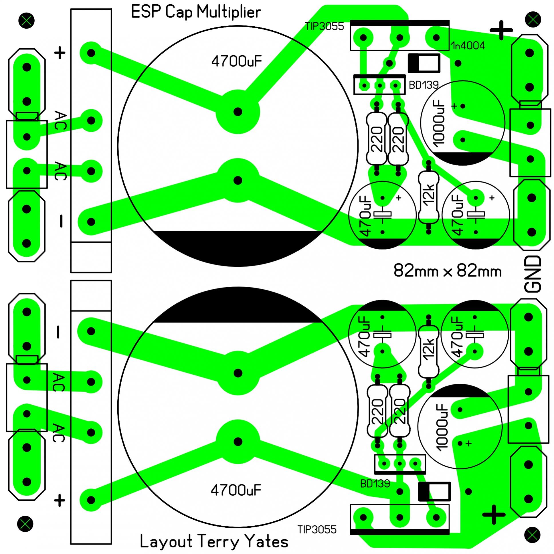

I plan to use a cap multiplier for the PSU and the rails should be about 46vdc.
