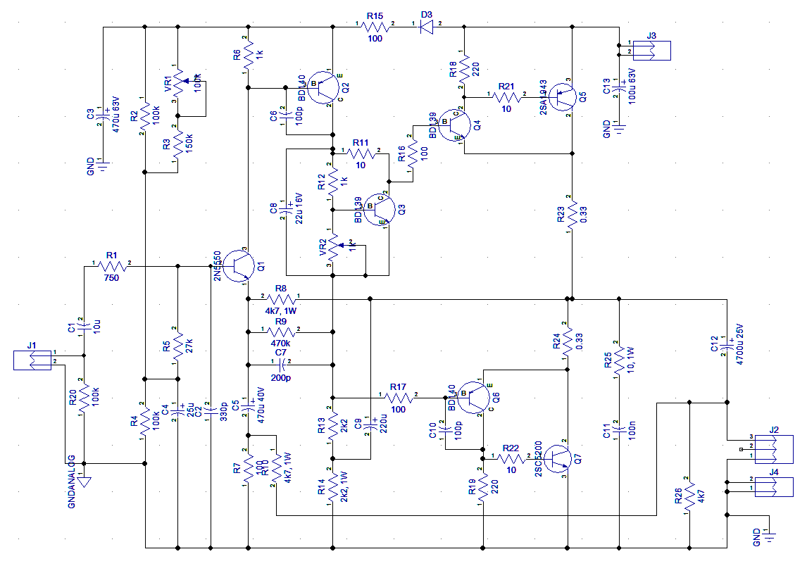

Looking at past schematics I'm guessing that C6 is the dominant pole compensation capacitor at the VAS device. This value can be trimmed to suit your build since it's value depends partly on the parasitics of your pcb layout, the actual transistor devices used and sometimes on the dielectric of the capacitor itself (silva mica reportedly can be a smaller value because of it's higher dielectric absorption ?). You may also find it worth auditioning some values in your set-up because there can be subtle affects on the sound of some amplifiers with changes in the comp. I would look at values for C6 in the range of 47pF to 82pF.
C7 is also part of the feedback compensation. Whereas C6 is usually referred to as lag compensation, C7 is lead compensation. I don't think it needs such a large value as 220pF, I would have thought something in the range of 22pF to 33pF was closer to the mark.
fyi - In a recent amplifier project I compared silva-mica with C0G ceramic as lag compensation and found the ceramic slightly more to my liking (more 'focused') although any differences I heard were very subtle indeed.

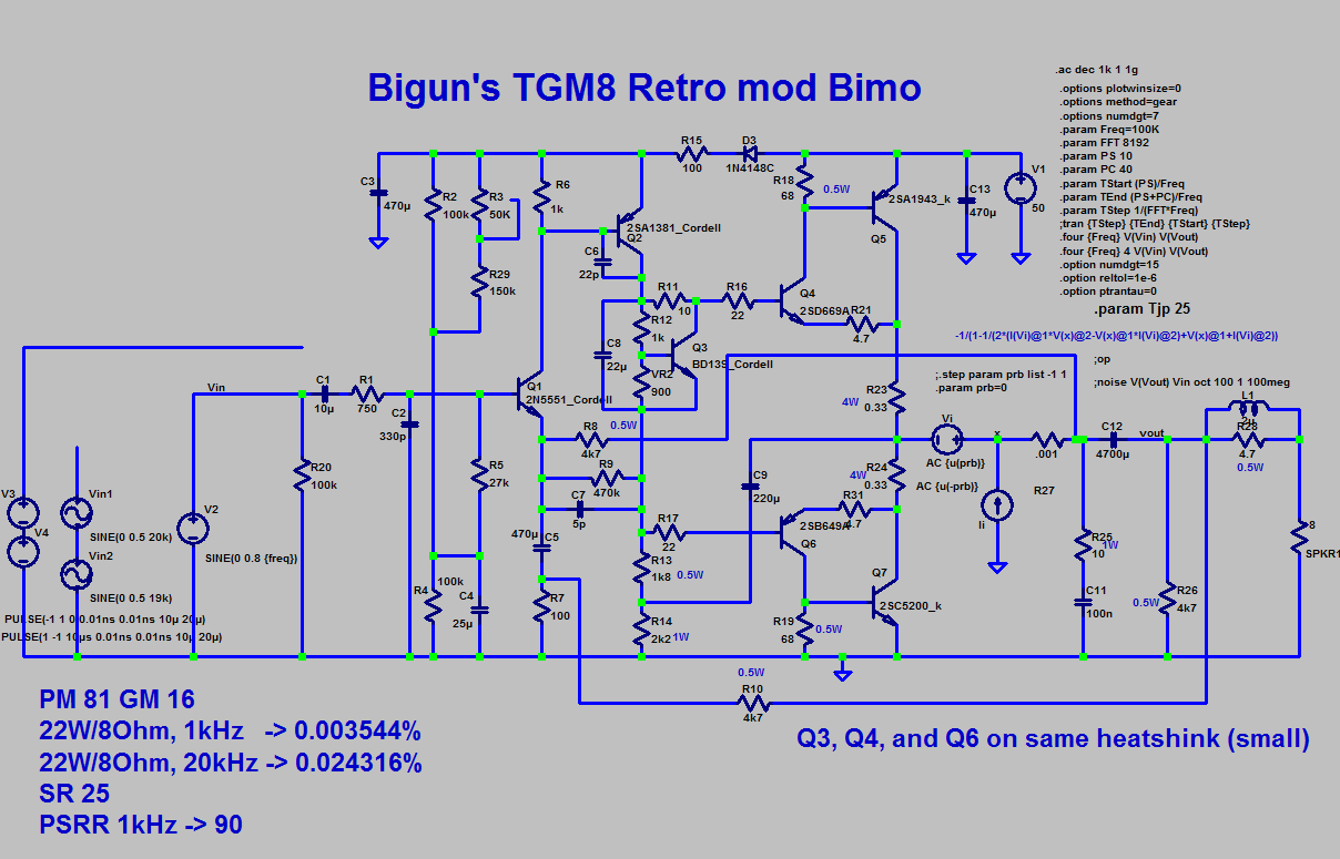

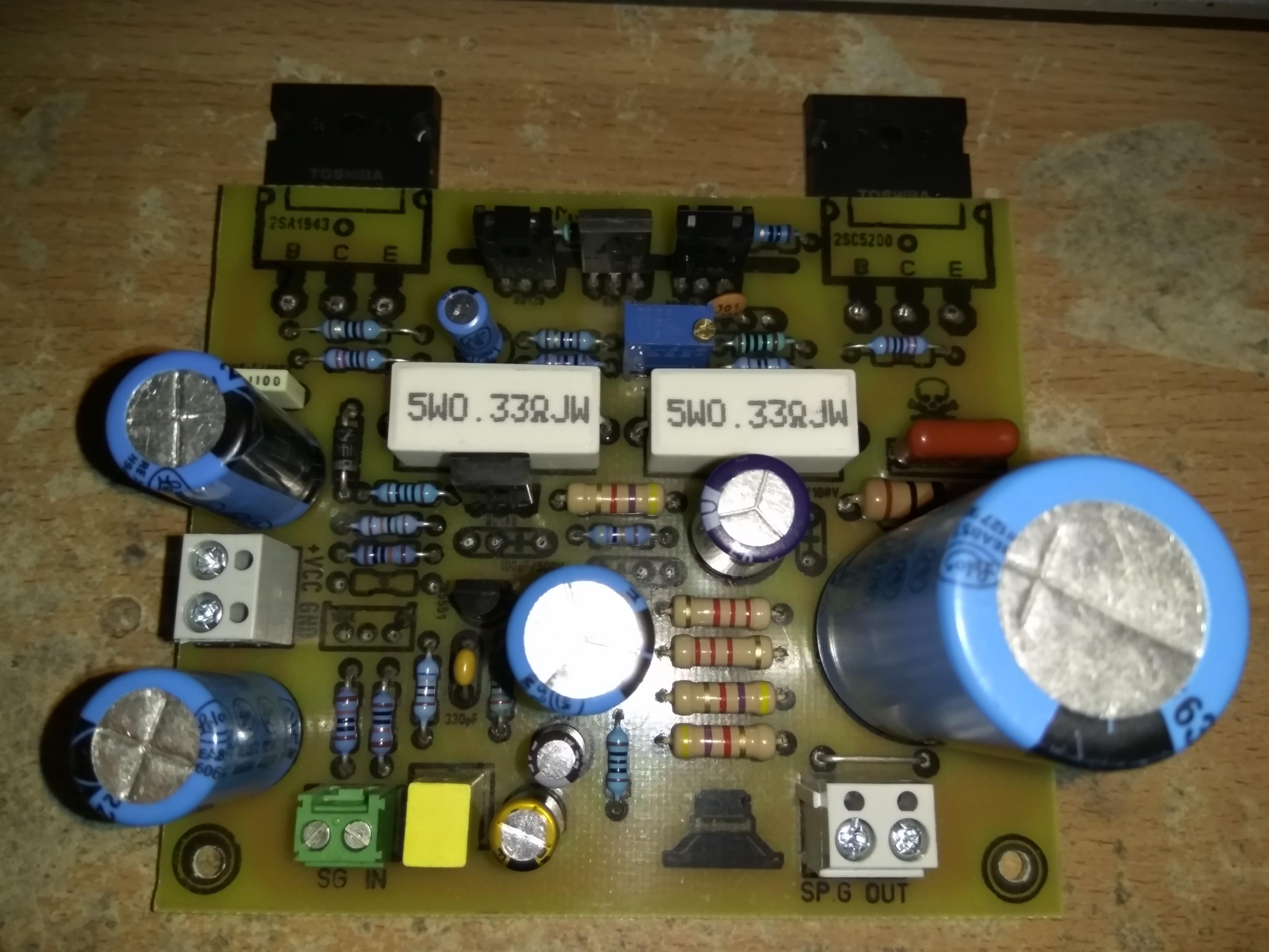

Ranchu,Bigun i am attaching the schematic i am reffering to and i also attach my build.
For driver transistors Q4,Q6 i am using HSD669A,HSB649A,(they will be placed in the same heatsink with Q3 BD139 ),for VAS transistor Q2 i am using KSA1381 and for input transistor Q1 i am using 2N5551.
Now my concern is about C6,C7 values,and just a thought of running 2N5551 at 1ma by lowering R6 at about 510~560R

C7 is a phase lead as seen in several John Linsley-Hood designs and can help to make the amp more tolerant of difficult (inductive) loads. Agree with Bigun that 220p is *way* too much and I would suggest perhaps 15p or 22p.
The Millar cap, C6, is also too big and will have an audible influence on sound quality. In my version (fully tested) I'm using 22p here with the same output devices and LESS gain.
So if I were to build that circuit and to be on the safe side, I would start with C6 = 33p and C7 = 15p. As a matter of fact, I didn't even bother with the phase lead and it passed clean square waves into inductive dummy loads.
I use only C0G/NPO compensation caps - make sure you use parts that are rated to the full rail to rail voltage swing.
An advantage with this topology is that you can get away with lighter compensation that would be required for the same design with an LTP input.
Reducing the collector load resistor, R6, will increase Q1's Ic (and gm); however, it will also increase the loading on the Q1 collector, pulling the OLG back to about where you started.
If you want to increase the olg of this simple circuit without adding transistors then the better option is to reduce R7 and adjust R8, R9 and C5 to suit. I've built a similar circuit to this with the shunt resistor as low as 10R however the trade-off is that multiple parallel (or series) connected feedback resistors are required to handle the Pd and the shunt cap becomes prohibitively large.
