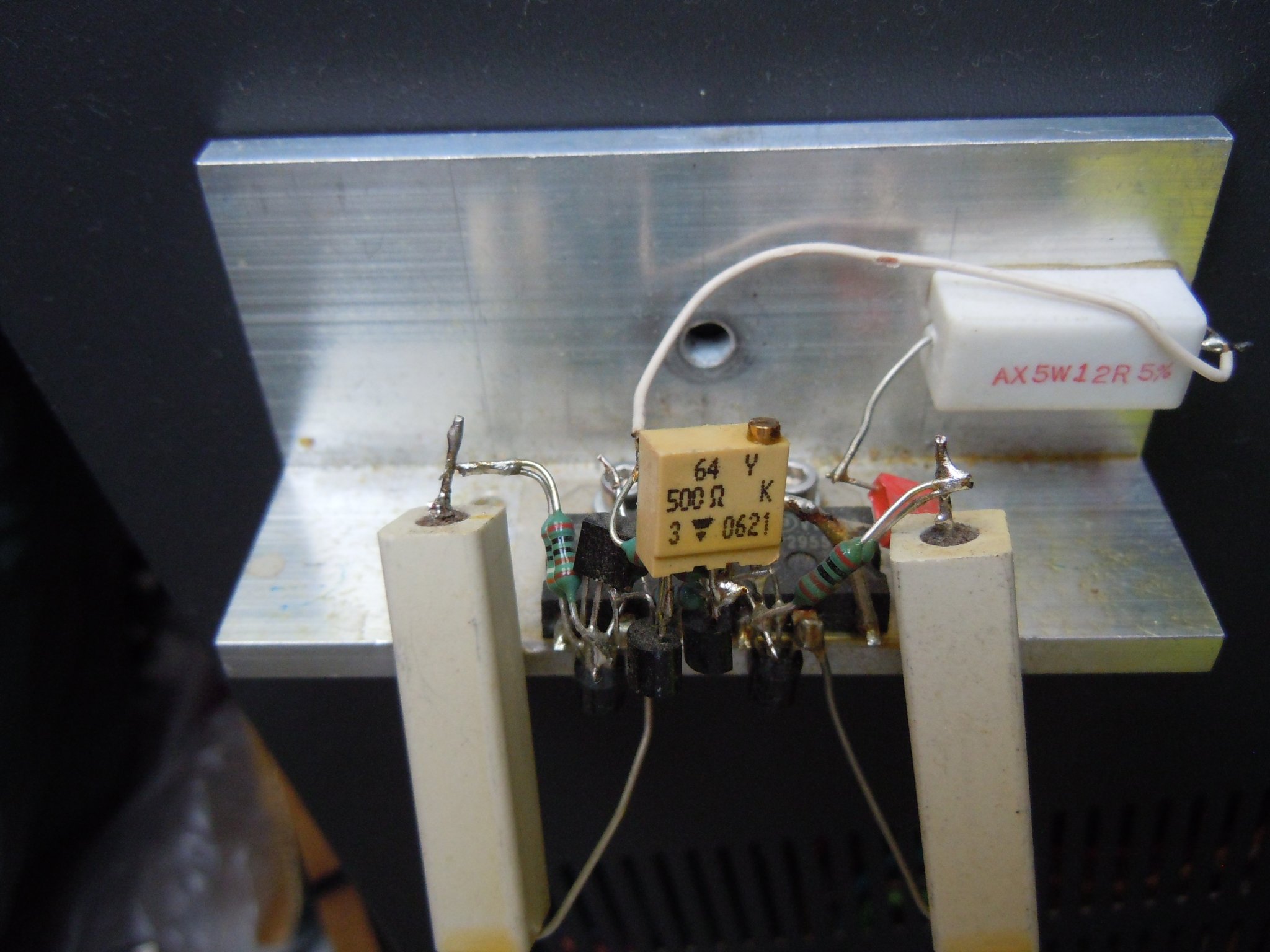

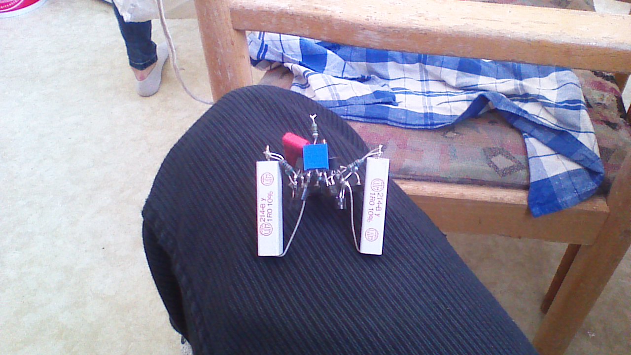

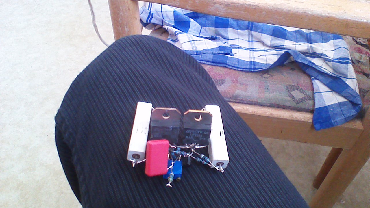

F5 indeed seems simple enough to perhaps be quite buildable without the board. Do the traces really make such a big difference? Why the recommendation to build without PCB?

Didn't quite understand this sentence.Possibly one more TO-220 may have to work.
Interesting! I'll have to look it up what would be possible replacements. But it seems like people are already using high current ones for the configuration where they are in parallel. When you say thin film I assume you mean resistors, but do you mean every single resistor?The power resistors, which are doubled, only single, but with the appropriate value, and in TO-220 or TO-126 housings, thin film.
In addition to your sound experience with the digital amps, unsuitable speakers and source devices and other factors may also come into consideration. I'm sure I could help these little things to sound very good: first of all, avoid plug contacts and screw contacts. Avoid double mono power supplies.
I have had large digital amplifiers on the table. Their PCB layout was so bad, e.g. the ground was designed as a surface, one side of the PCB, and then feedthroughs everywhere: It just sounded cloudy and unstable. But this is already the case with small digital devices, if DAC or amp. The developers didn't understand current and signal and definition. Small devices can be reworked, but large ones are not worth the effort.
In a setup without a circuit board, you are almost forced to use a current-conscious setup. You can't do much wrong, then the smaller number of soldered connections (nobody would connect his devices with solder), shorter ways, then much less corners and edges and loops, then less material that resonates, modulates the current with material resonances - we can tune devices by means of material resonances;-) Boards have nothing to do in audio. A tip: if amplifiers need boards because they are too complex, then they are too complex: NO chance for a single clean tone;-) (Except smd and digital and high power)
TO-220 are not as stable as larger e.g. TO-247 (e.g. above mentioned IRFP 240, 9240), it takes one or two more TO-220.
