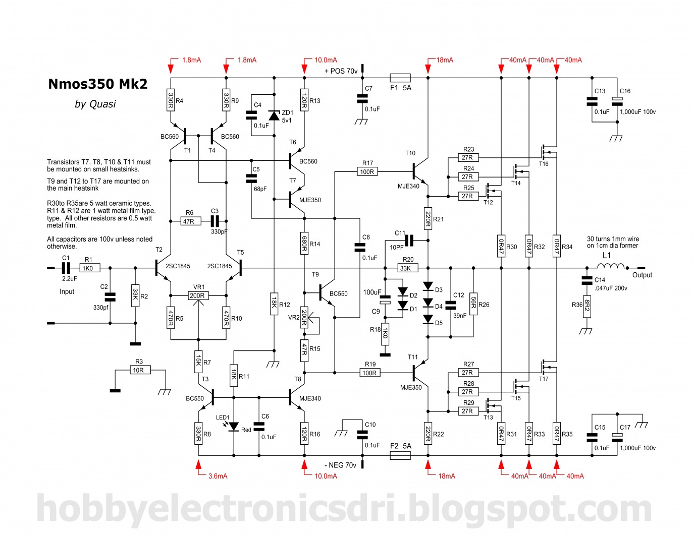

Is this circuit actually made successfully?I recommend you to make a simple Nmos MK2 amplifier.
yes .
It works immediately after assembly, the circuit design and components are simple. Similar to other amplifier circuits, there is nothing difficult.
I even combined 2 amp circuits operating in bridge mode with a tone circuit right in the amplifier circuit.

1, iff using voltage lower , example 50V you need reduce R7 at input stage to 10K.
2, bias current of 30mA per FET pair

The BC550 is encapsulated to To92, can it be replaced with BD139? My English is not good.Google translation used
Are you afraid it will burn out or why should you replace it with a high power one?
BD139 can change for MJE340
