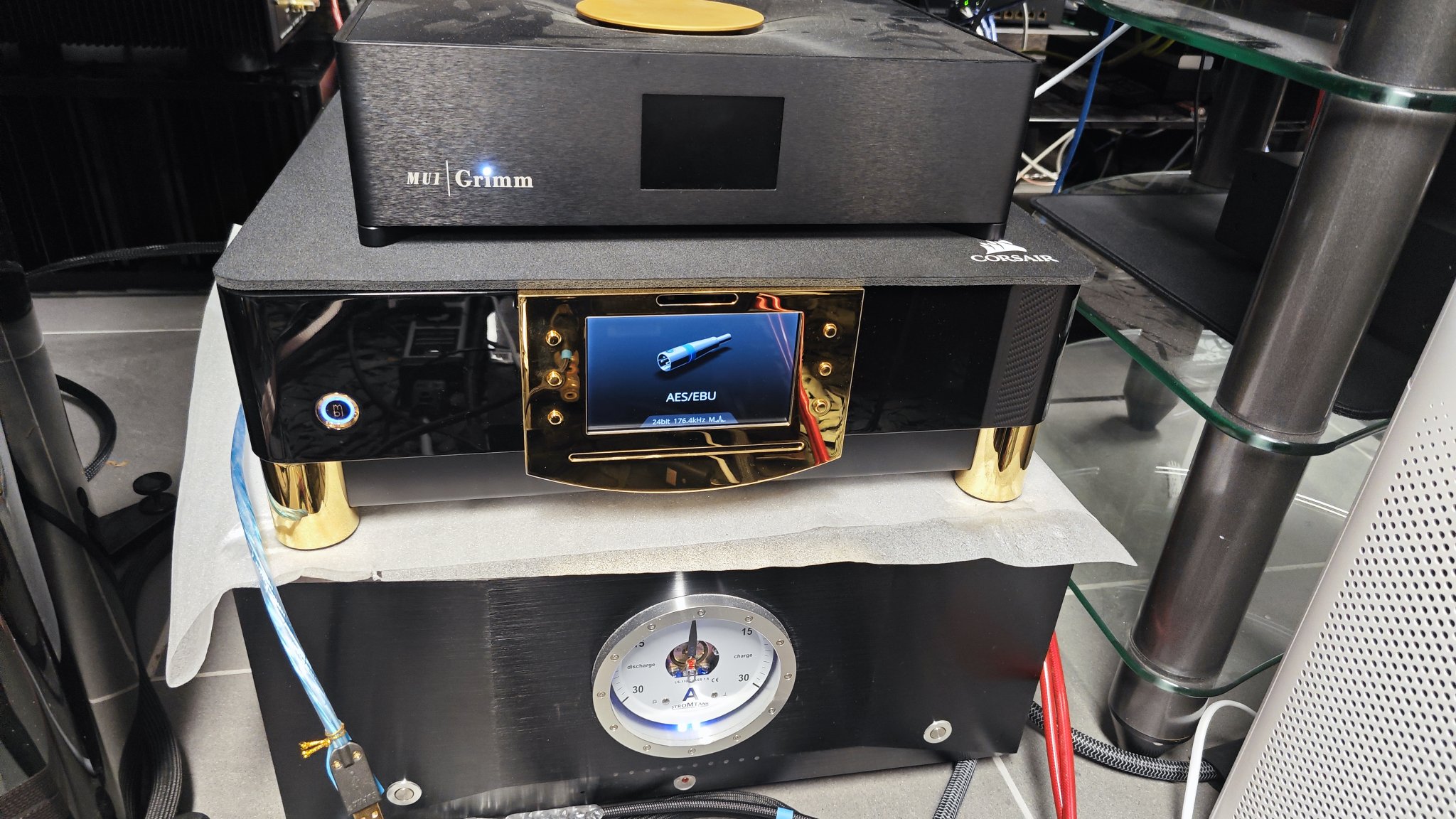

Yesterday I also heard probably the best Amp I've ever heard to my clear memory with a super good DAC too. Everything connected to it sounded unbelievable. But it's just 30 watts per channel Class A. I dunno how B&W would feel about that, since everyone says they love lots of power, but I could potentially feed Class D to the bass and everything else with something like this Accuphase. BTW it's for sale for 5k. Given inflation it was around 20k euro new 10 years ago. Truly an astounding amp. Compared it to many other things even in 5-20k range and just wow, it's amazing. Japanese know how to do it.

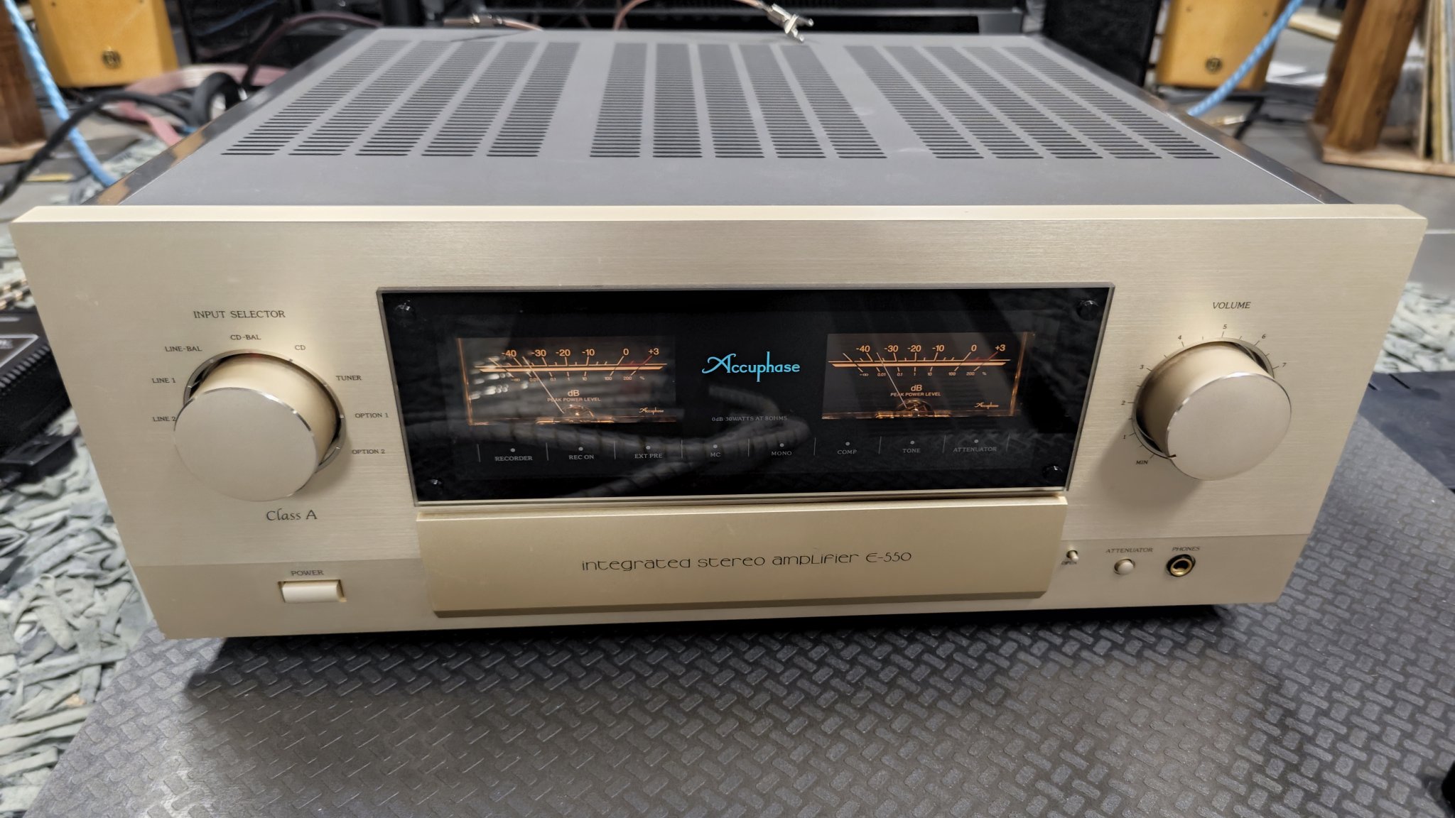

Trust me: this Accuphase is really steamy, and probably one of the best that Accuphase can build. The bigger and more Accuphase, the worse the sound. The complete k.o. was once a performance at some High End trade fair, where they gave every driver some super multi-way LS an own very big power amplifier, which was 12 power amplifiers, or more, whose power supplies were not even connected to each other. An acoustic disaster;-)
I would prefer even the smallest Accuphase Classe A, because Accuphase also is not able to place paralleling parts at ONE circuit, which is audible.
