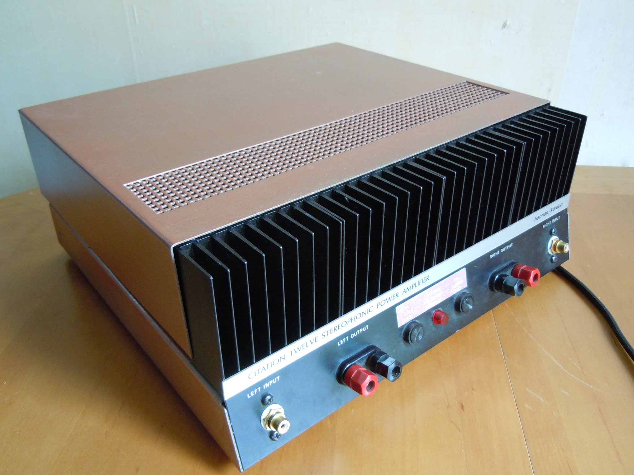

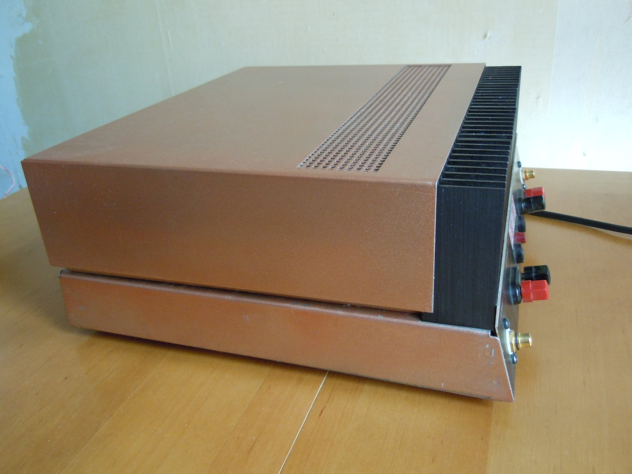

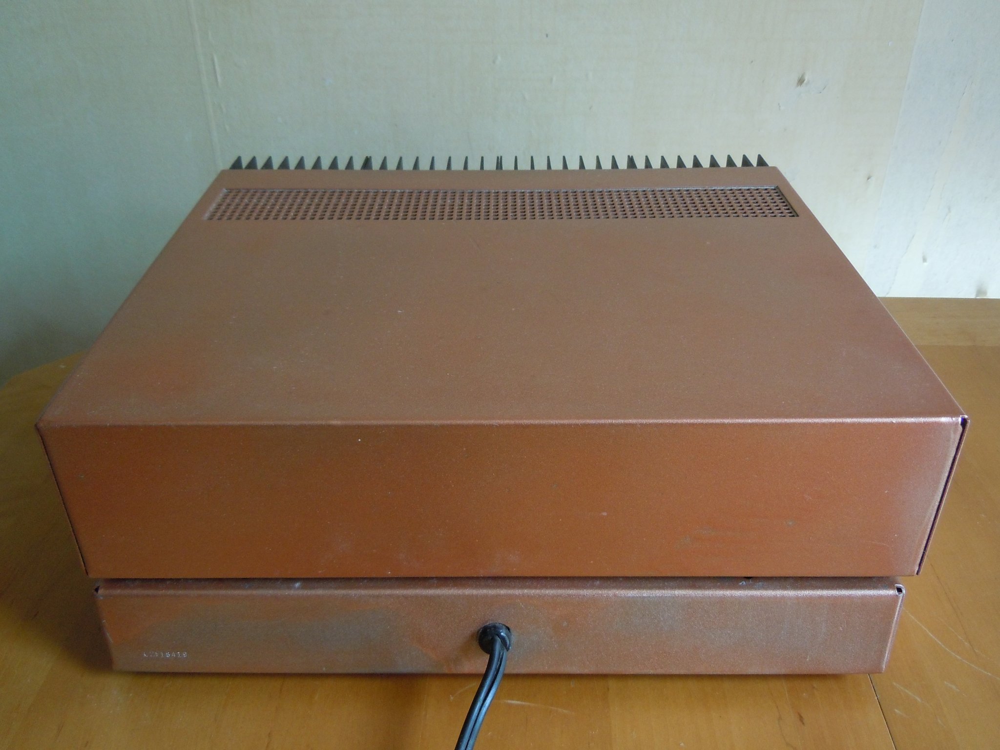

I still have a Harman Kardon Citation 12, which I bought defective. One of the previous owners sprayed it bronze. I repaired it, but it sounded... well, you can't listen music with a Citation 12;-)-; Then I took out everything except the transformers and capacitors, took two old complementary pairs (TO-3 - because of heatsinks) and put in a pp-"follower"-) But this one is not finished yet. And it's not here either, it's "mothballed"-) Unfortunately, the transformers are not heavy-duty and neither are the heat sinks: not enough for Single Ended)-;

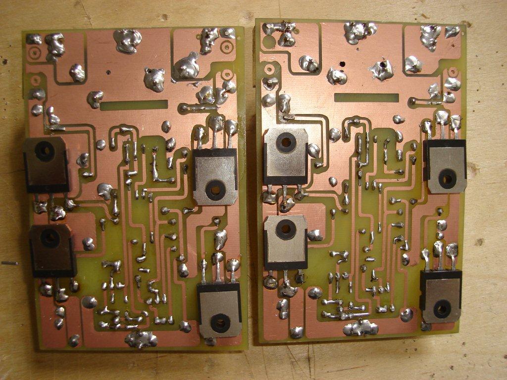

So that would be a 1-stage complementary transistor PP follower, half wave symmetric, made of only 4 parts per half-wave. That's an announcement - it couldn't be simpler hardly;-) It has a "double mono" psu. Strictly speaking, there are 4 power supplies, as each channel is two half-wave amplifiers and each half-wave has its own power supply. Then I installed a switch that can connect these channel-separated "double mono" psus together - 4 to 2 to be precise. As a gag, so that everyone can switch back and forth until the ears smoke and hear the difference between "channel-separated" psus and one psu. Until it "clicks" in the head: the untested nonsense and bad sound of "dual mono" psus;-) And the proof that identical parts sound different, on which almost the entire audio, hi-fi, high-end discourse can be built;-)
A follower does not amplify voltage. It only makes current. As a tip: a headphone output, headphone amplifier or DAC is sufficient to bring a follower up to max about party volume. You can't get any louder! A follower also sounds very different from an amplifier: milder, smoother, creamy, finely colored. Only twice have I managed to build an amplifier (from the same parts, i.e. simply rebuilt) that sounded slightly cleaner than the follower. A follower doesn't need feedback either.

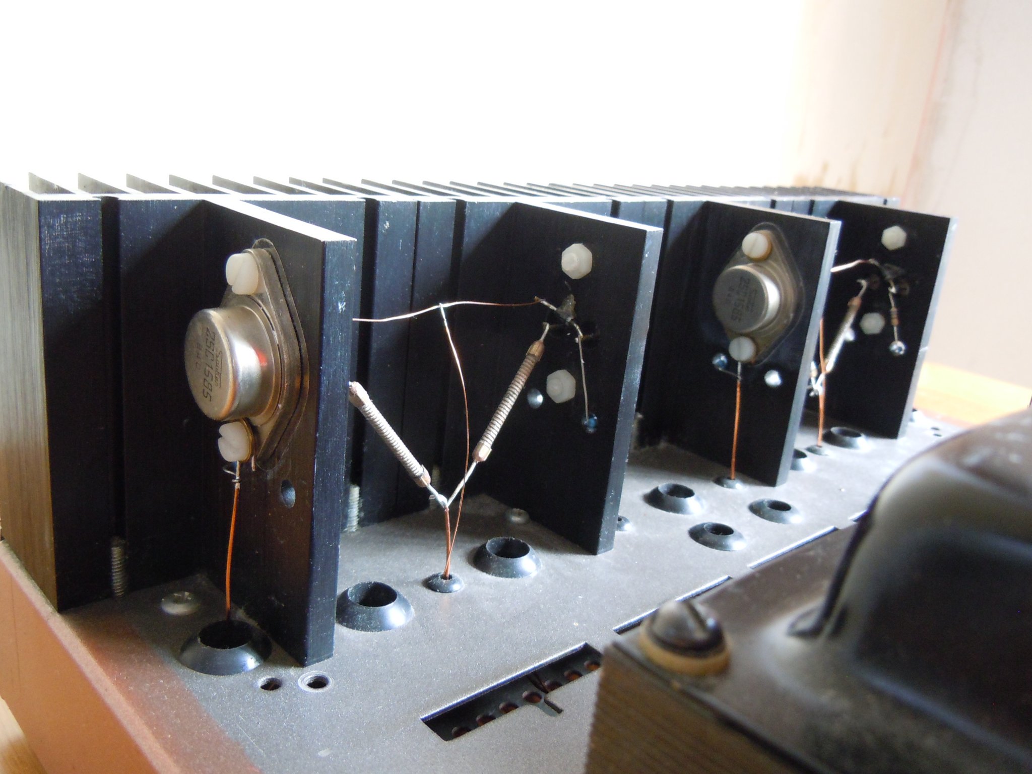

The sound of this device is limited by the TO-3 transistors. This device is built for looks too. Give me 2 or 3 weeks to get it and photograph. If you haven't found anything good amp in the meantime, I'll send it to you and you'll hear. And if you like it, if it fits to your speakers and source devices, including the max volume, then... the price I send per private - the price I paid for the defective device only.

Here is the good one;-)
Bronze from a previous owner.

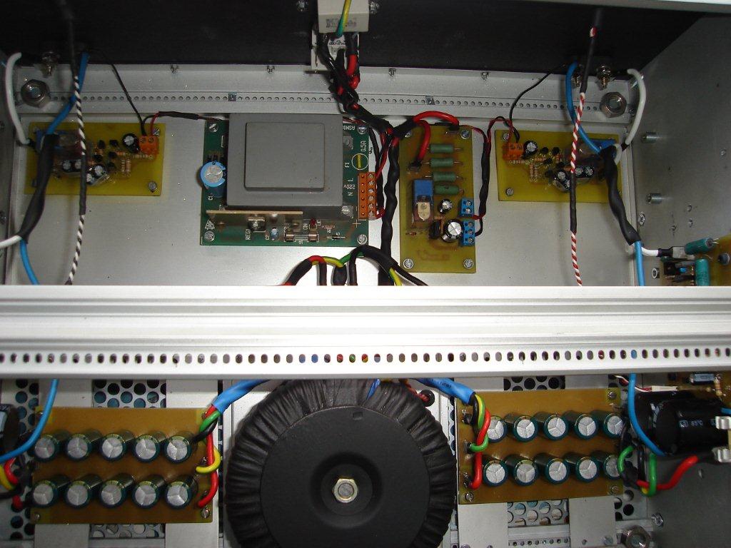

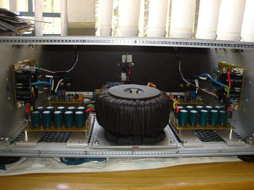

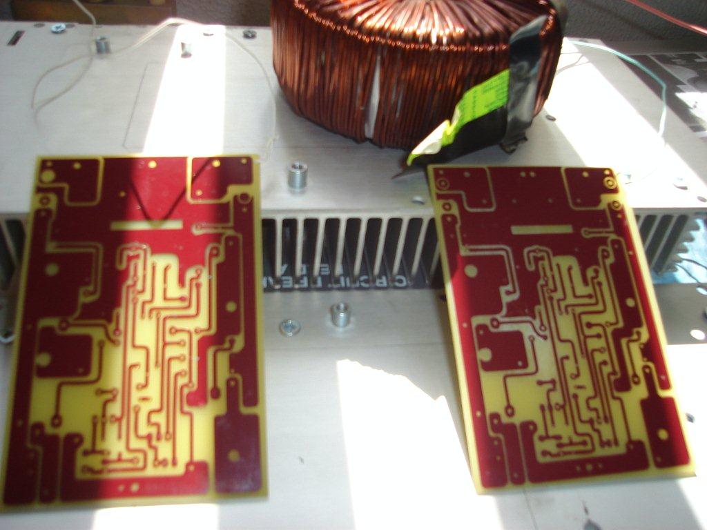

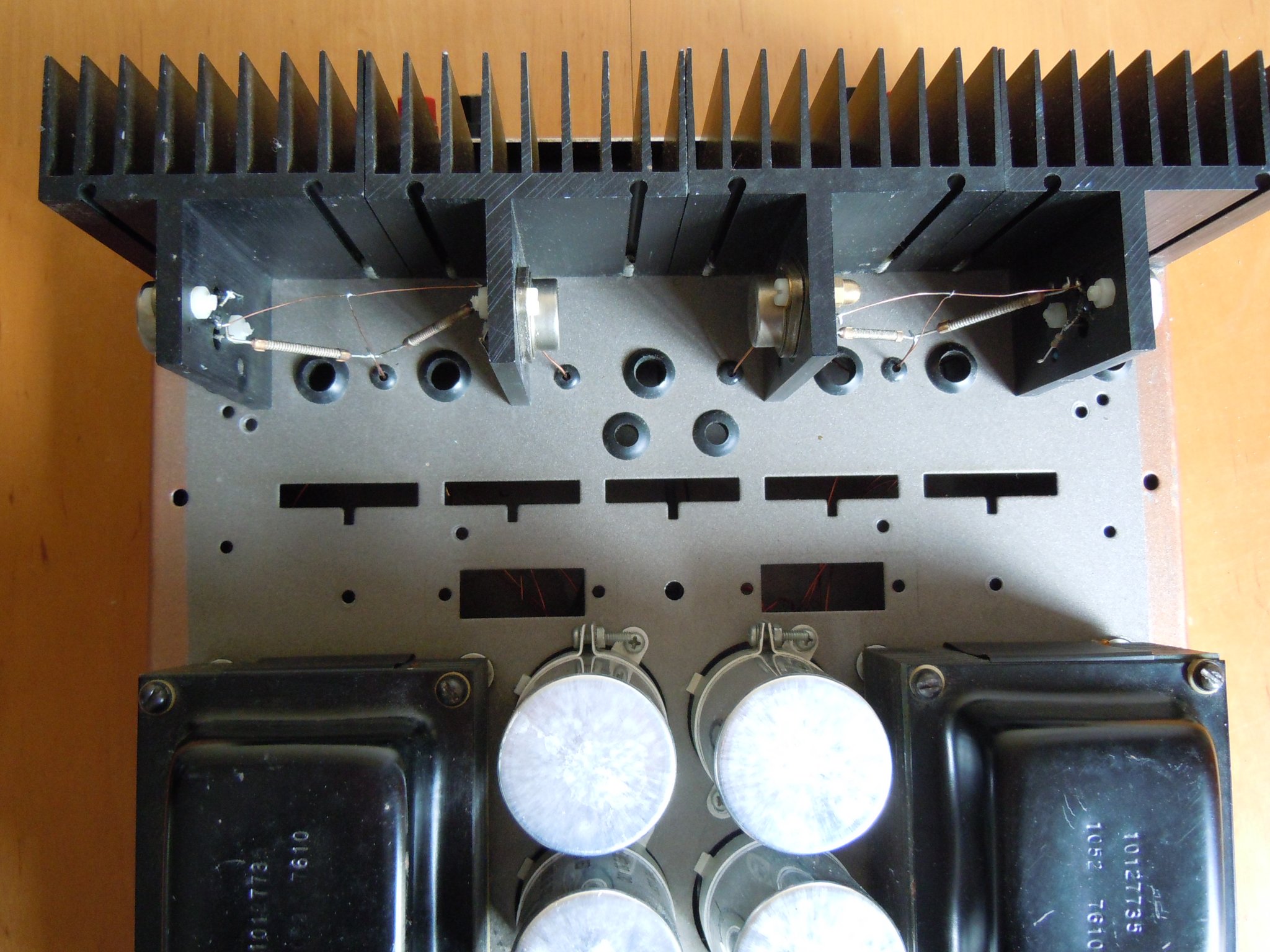

Basically we see the PP circuit, arranged like a boxer engine. 2 channels. And we can also see all the components involved, two TO-3 transistors per channel, two power resistors per channel, two diodes per channel and two small resistors that define the drive current. I also have different power transistors (values) to customize the sound of the amplifier.
I had also ordered, had got a copper plate to cover the area between the power supply and the amplifier. This copper plate would also contain the switch for the power supply connection.
Various screws/nuts can be seen on the transistors. At the time, I was looking at the appearance: what material and shape might be appropriate. I also still have gray plastic screws with which I wanted to fasten the transistors - then countered with stainless steel or brass cap nuts, for example.
These devices do not have a power switch. They ran via the preamp stage. It is also not clear which side you turn to the front. I wanted to swap the mains cable with the lamp.
Size: 33 cm x 33 cm x 14 cm. 11,2 kg.
