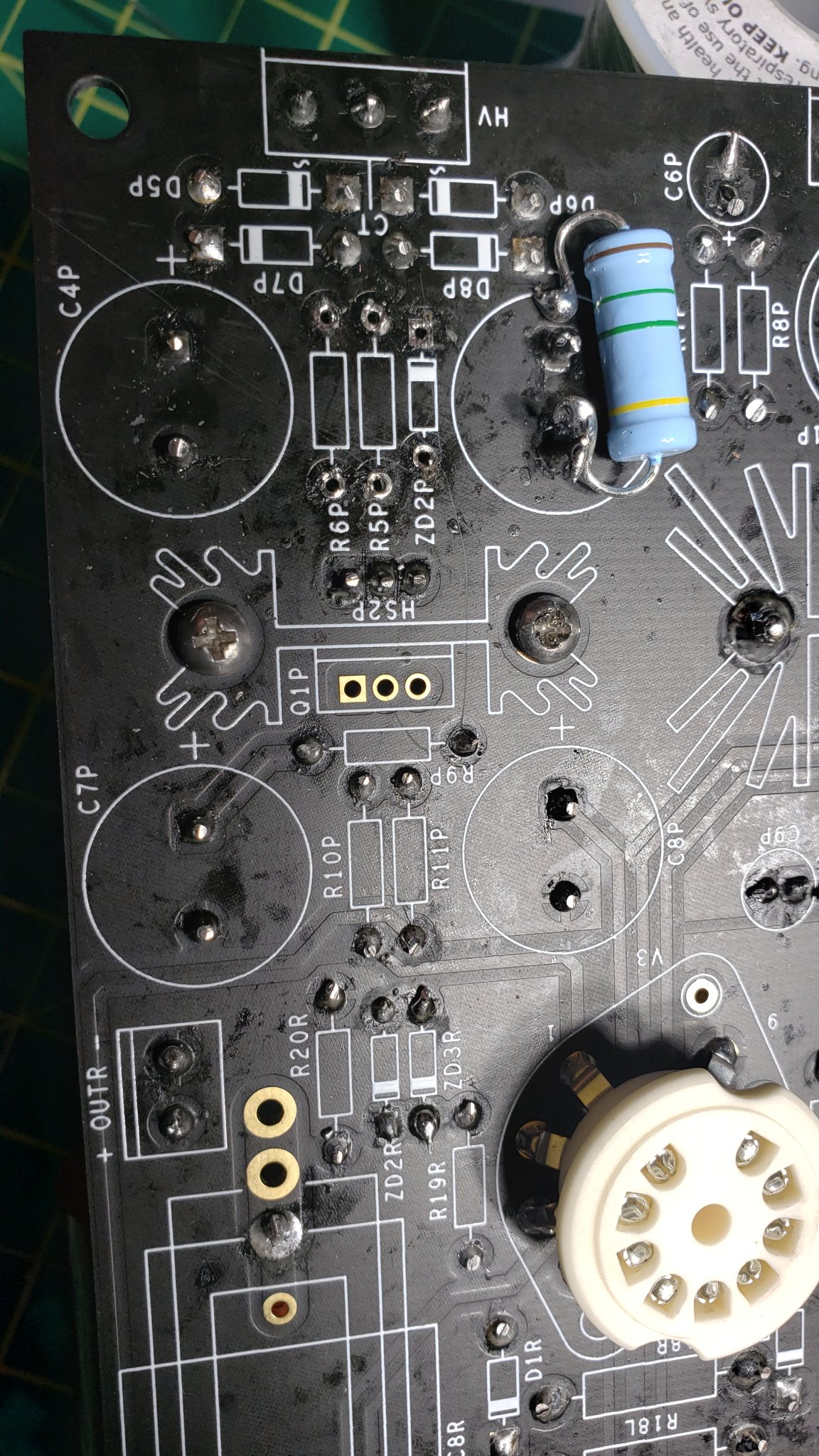

Hey, I'm not sure if anyone's still watching this thread, but I finally got around to building one of these with the multifet board.. Anyways, I got it all put together, and measured my voltages, and it was all exactly where it should be. Then I powered it off, and the next time I powered it up to give it a try I saw the magic smoke release from somewhere, and a bit of a spark from what appeared to be the C5 area... Super disappointing.
Anyways, I started measuring a few things and I noticed that when I measured ZD2P with the diode setting on my meter, it measured as a short in both directions, so that 12V zener definitely popped. I pulled out ZD2P, R5P and R6P since at first I noticed the really low resistance reading I got on those resistors (I assume now they must be in parallel or something with that Zener?).
You can see in the picture as well that I have also unsoldered a 1.5M resistor that I had in parallel with C5P (This was done to lower the B+ of the amp, as per some instruction from vivant earlier in the thread), and in the picture you can see I unsoldered it, and measured it out of circuit and it measures as it should.
Anyways, I'm kind of at a loss now as to what to do.. I'm nervous to just put another 12V zener in there, and put the resistors back in. Is it possible that the zener was just bad? Or would something else have likely caused it to pop? I'm also wondering if those 4 47uF caps in the power supply should be changed out as well..

I'd PM him. Vivant's probably the only one who could give you an answer, I'm like you, no idea where to start, plus it's so long since I built mine I can't remember much about it.I don't suppose Vivant is still watching this thread?

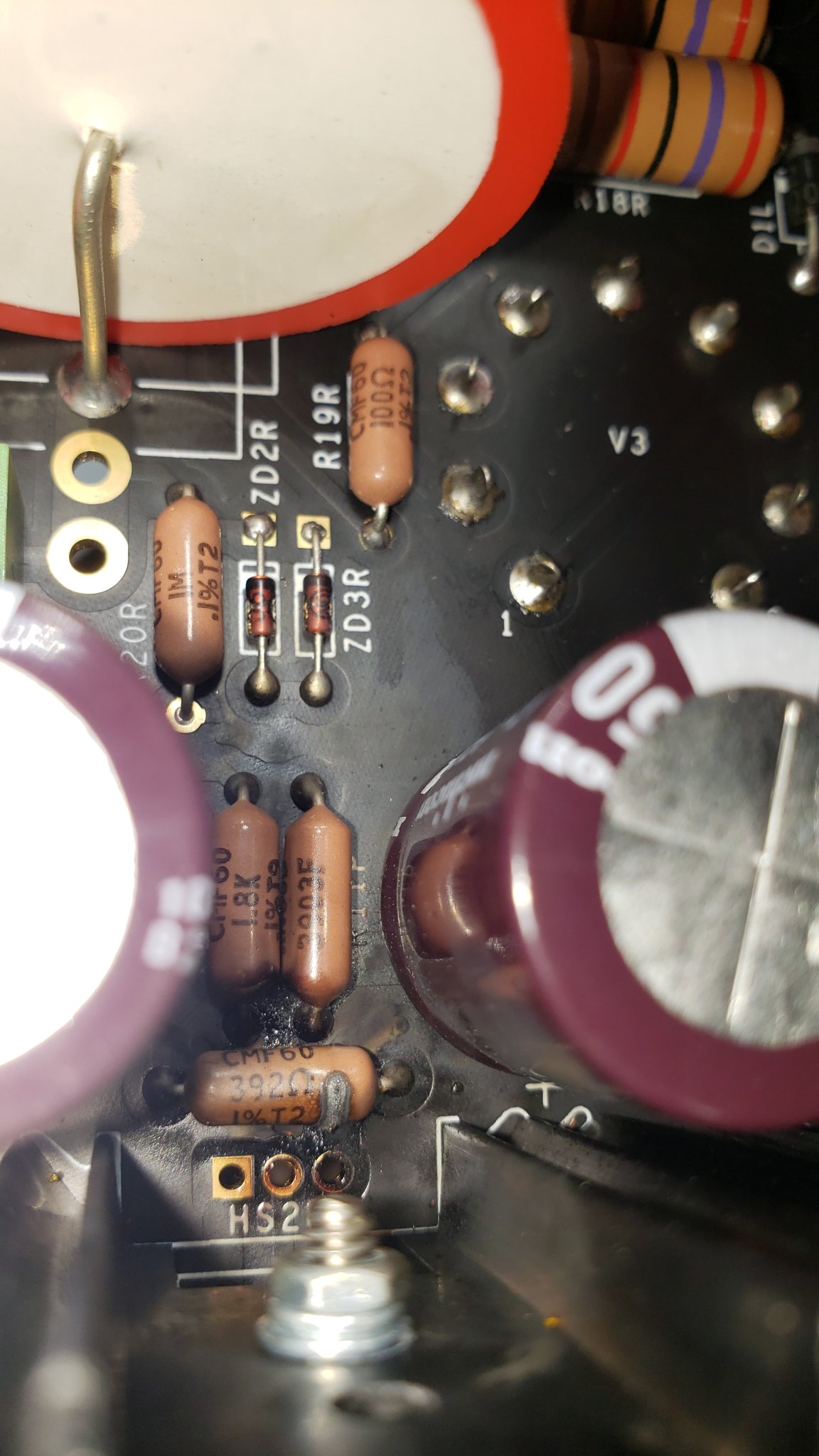

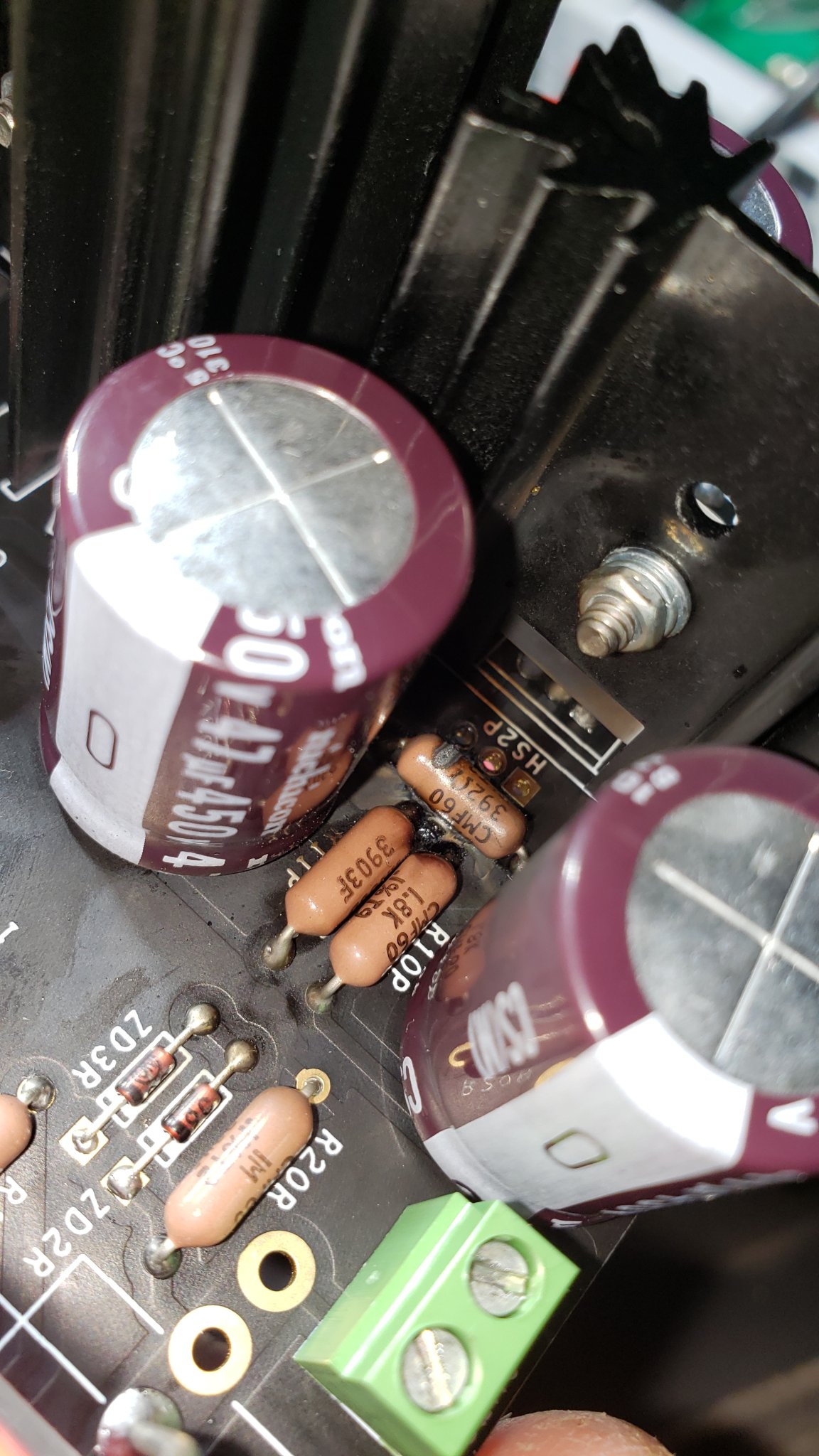

Well.. I put a new 12V zener in ZD2P, new resistors in R5P and R6P, and a new IRF820 in Q1P. Fired it up and it sparked right away. This time it left some burn marks on a few components.. It looks like R9P gave it up this time.. I attached some pictures of a very clear burn mark on that resistor specifically.. In circuit it's measuring 14 ohms now, not 390. What on earth could be going on with this thing? So frustrating..
