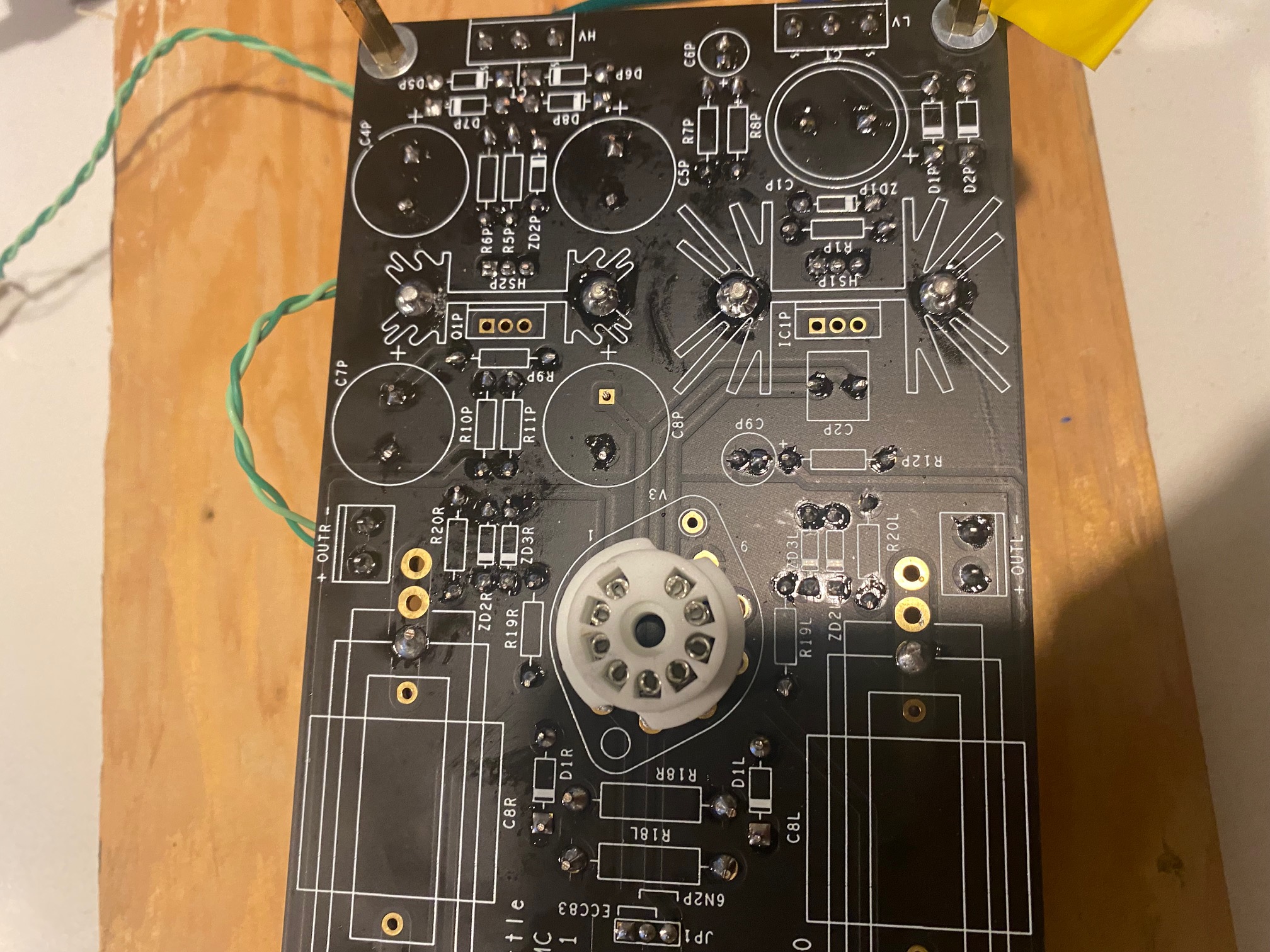

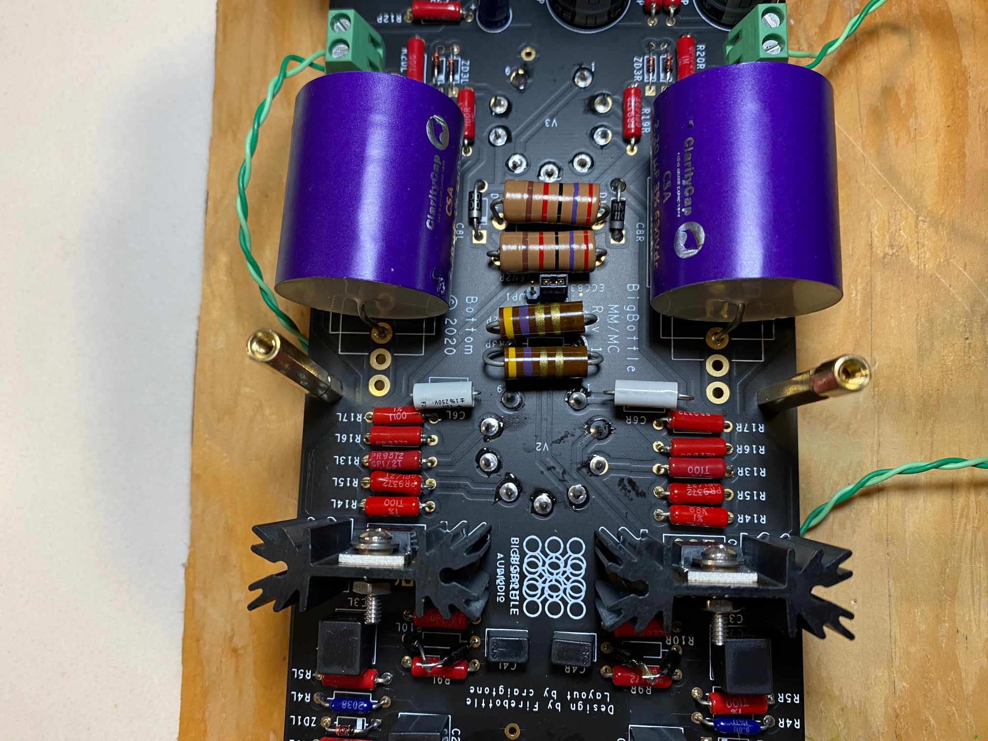

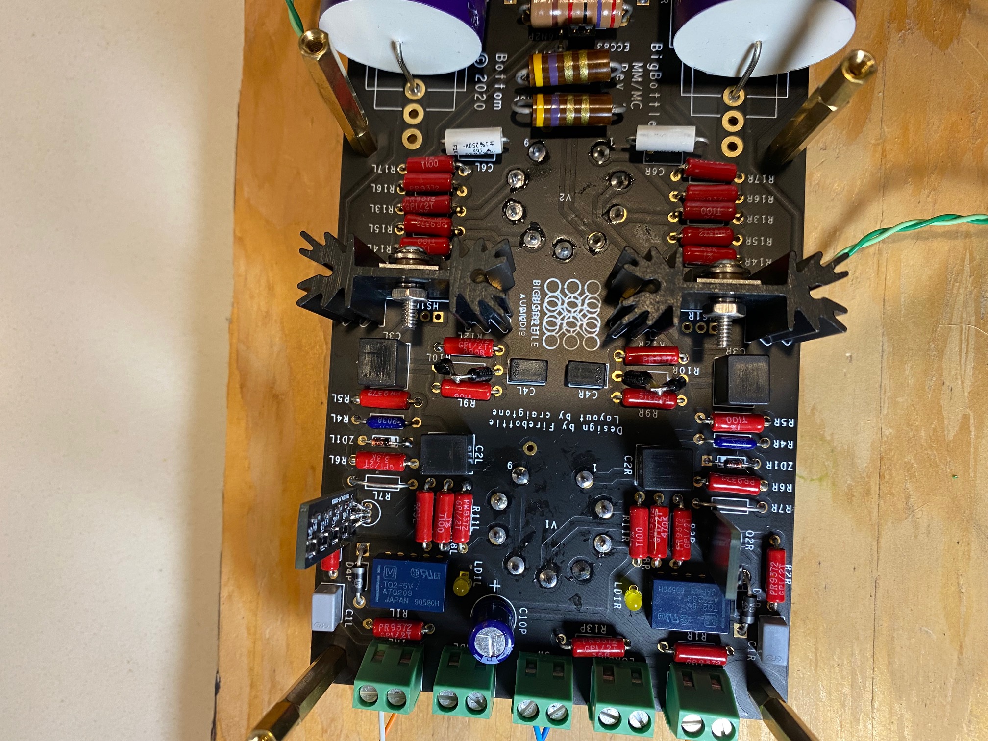

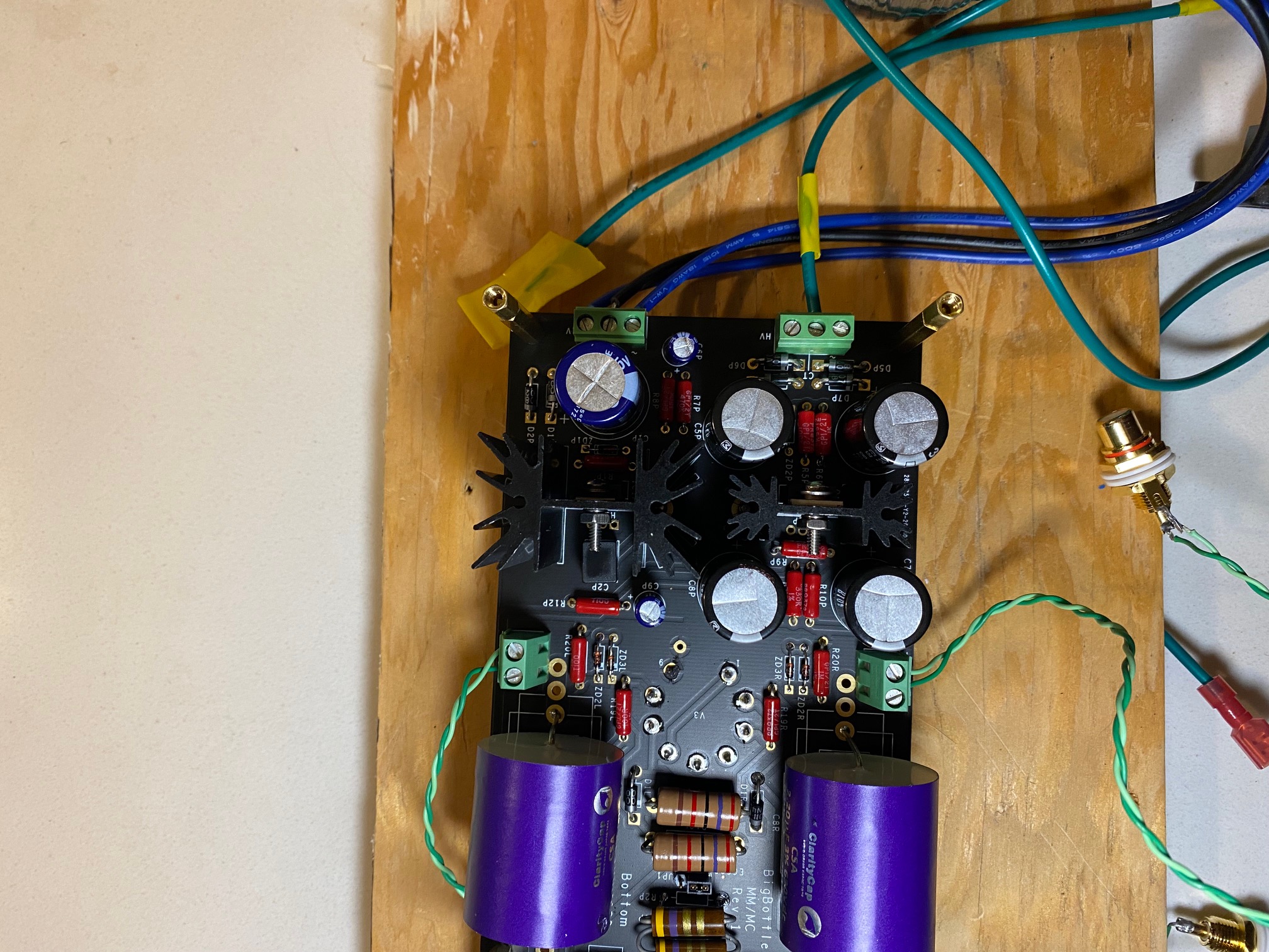

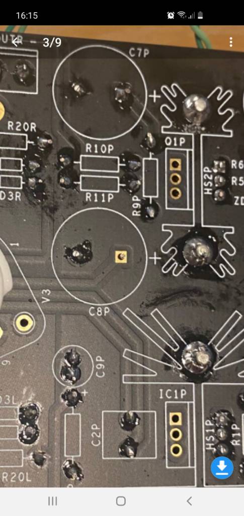

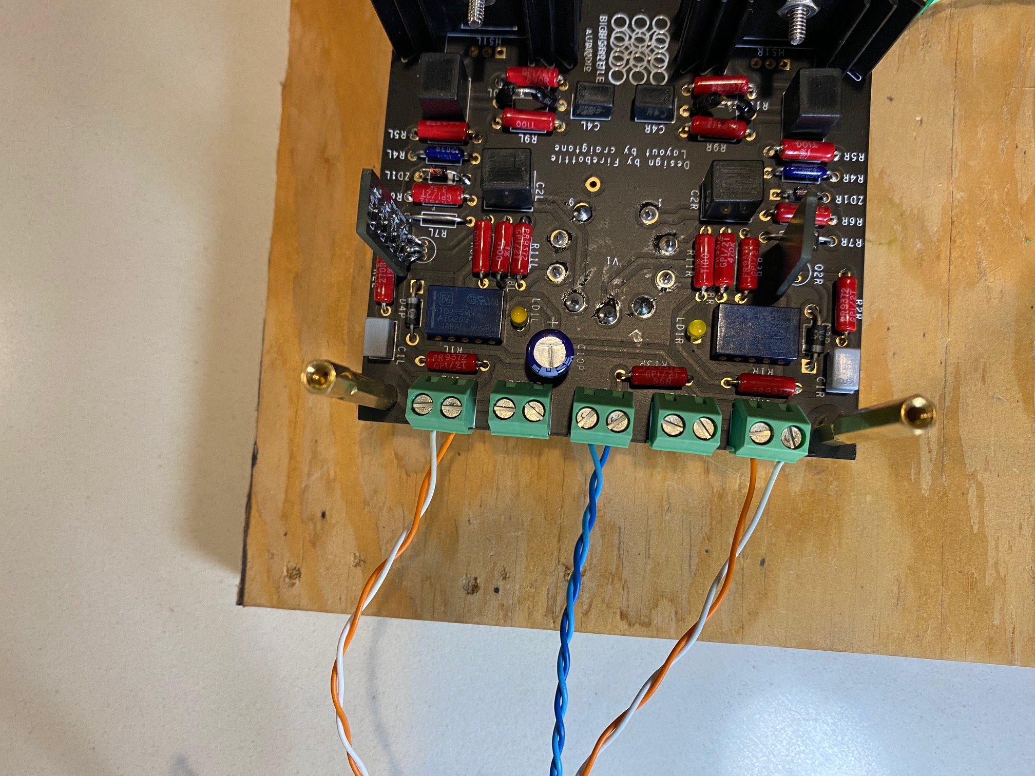

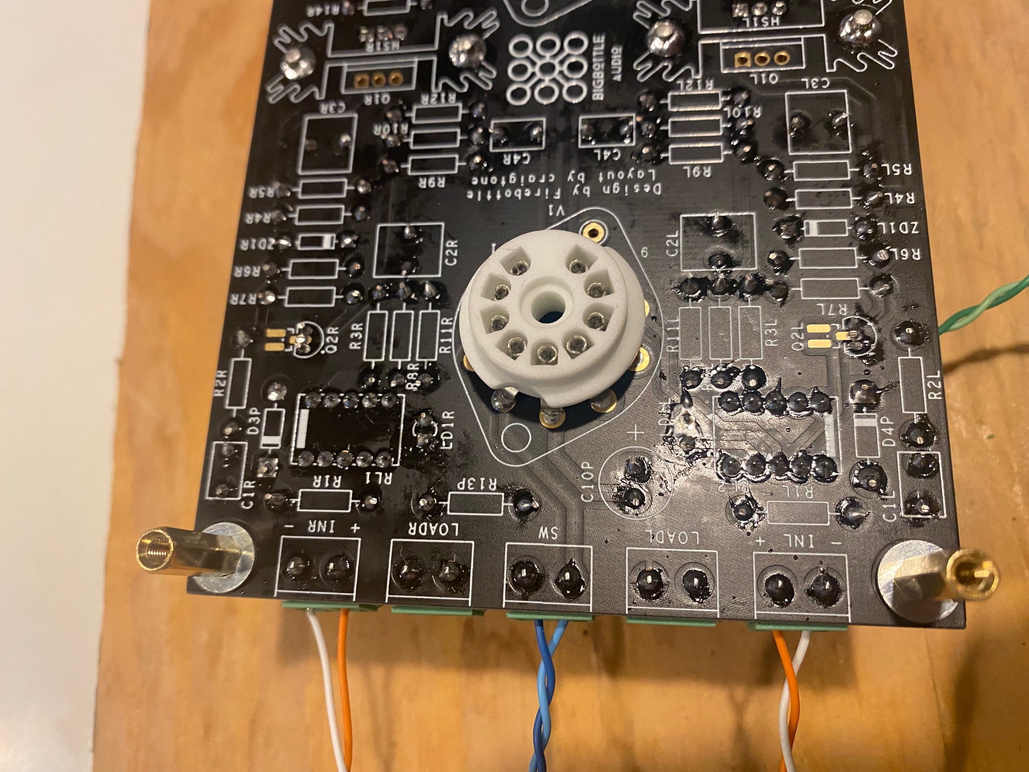

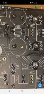

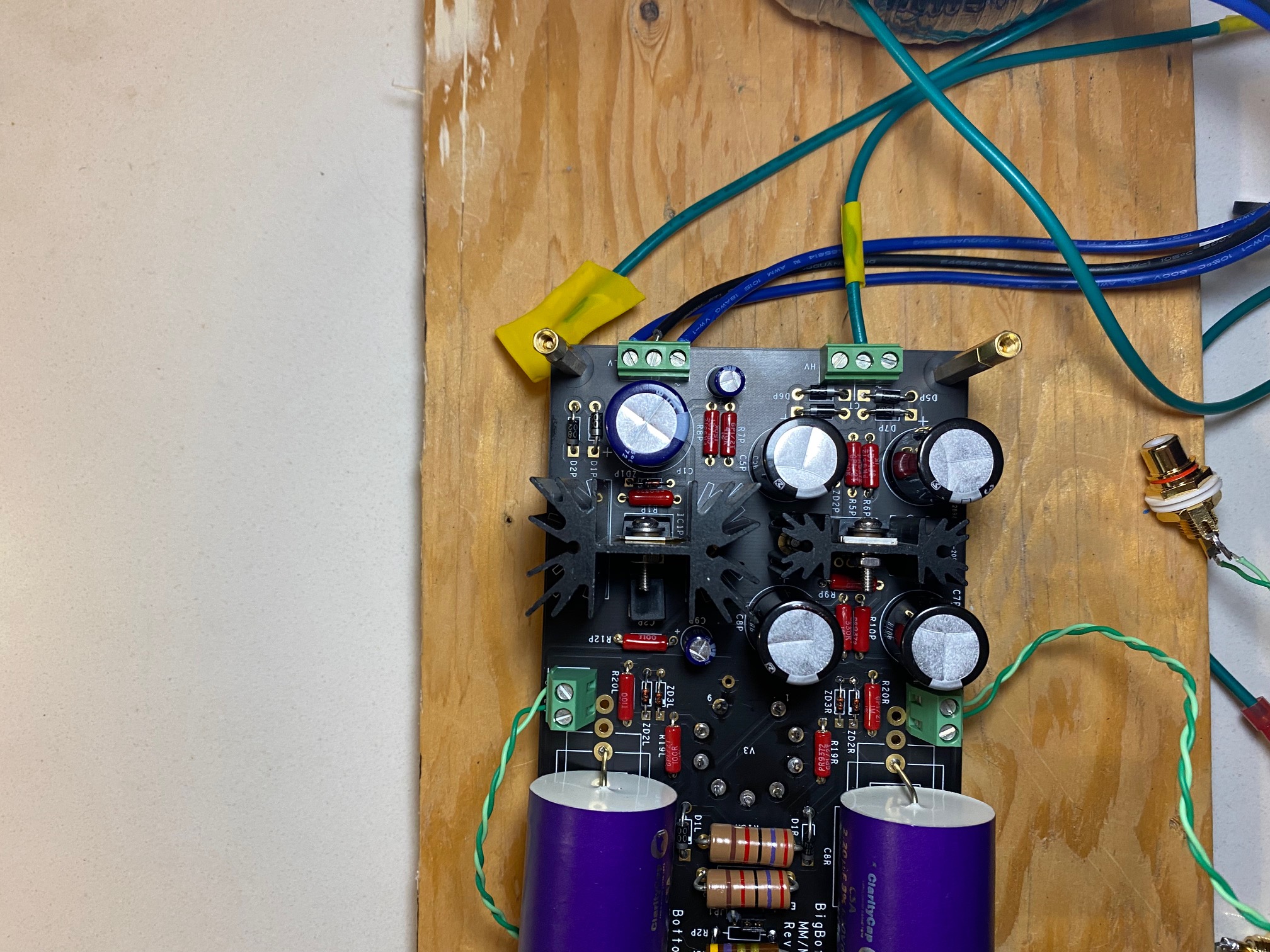

Pics for your review. Thank you again for helping out. I am really out of my depth here.

Well, it all looks good in the photos. I would suggest you talk to Vivant.
I do know that the LT ground is around 55v higher than HT ground (Vivant said this earlier in the thread) so if you're measuring heater voltage against HT ground this may account for it. You need to be measuring heater voltage between pins 4 & 5 on V1 & V3 and 4 & 9 and 5 & 9 on V2 if it's jumpered for ECC83 or 4&5 if it's jumpered for 6NP2
Try that, and if as I suspect you get low to no voltage, try replacing the 7805 and the zenner.
That should give you 7v at V1&3 and 6.3 at V2.
Do all this with HT disconnected.
Also, make sure you are using a high quality 7805 with the thick mounting plate, the cheapo ones have caused no end of trouble.
Edit: The different ground potential is what made me think you were getting HT in the LT circuit, but measuring against a 55v lower ground is much more likely, and if that's the case the valves won't be damaged as I suggested earlier.

Relays must be soldered on TOP side.
Put some solder on the C8 capacitor, as BigMan suggested.
Disconnect HV when you try to power up the heaters. Get them to work first.

Ohh man, those relays are going to be a nightmare to desolder. thanks for the help so far everyone.
Slow and steady. Also, relays are cheap to buy. Last time I had to do something like this it was a block of dip switches. It became obvious I ran the risk of destroying the board trying to de-solder them. So I cut the body apart with a small pair of needle nose cutters. Then all I had to do was de-solder the pins. Still needs care of course...

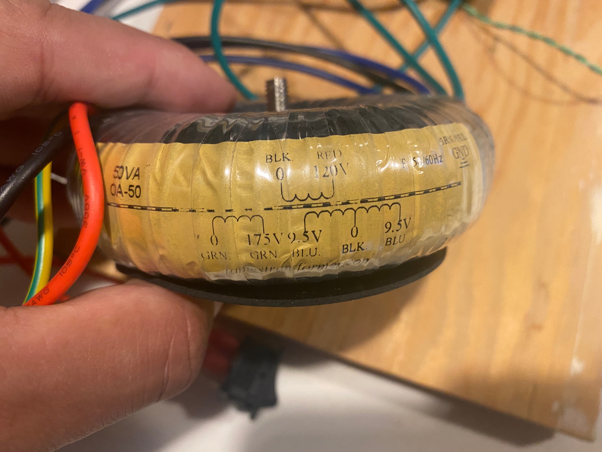

Thank you Patrick.
As I have mentioned before the HV DC at C4P 252.2V.
Power transformer form Audiophonics with secondary voltage 182.5 and 10.75 x 2.
