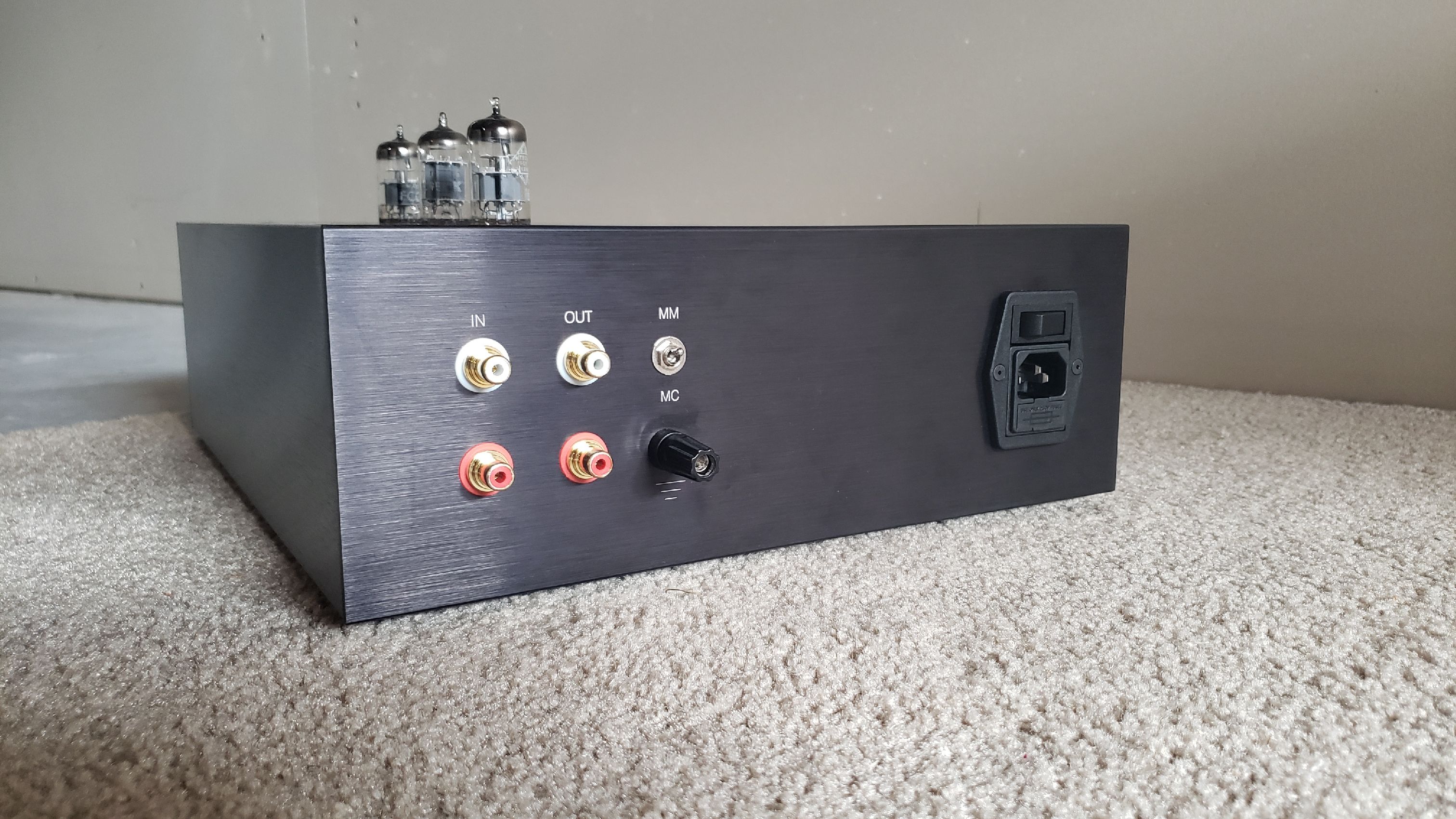

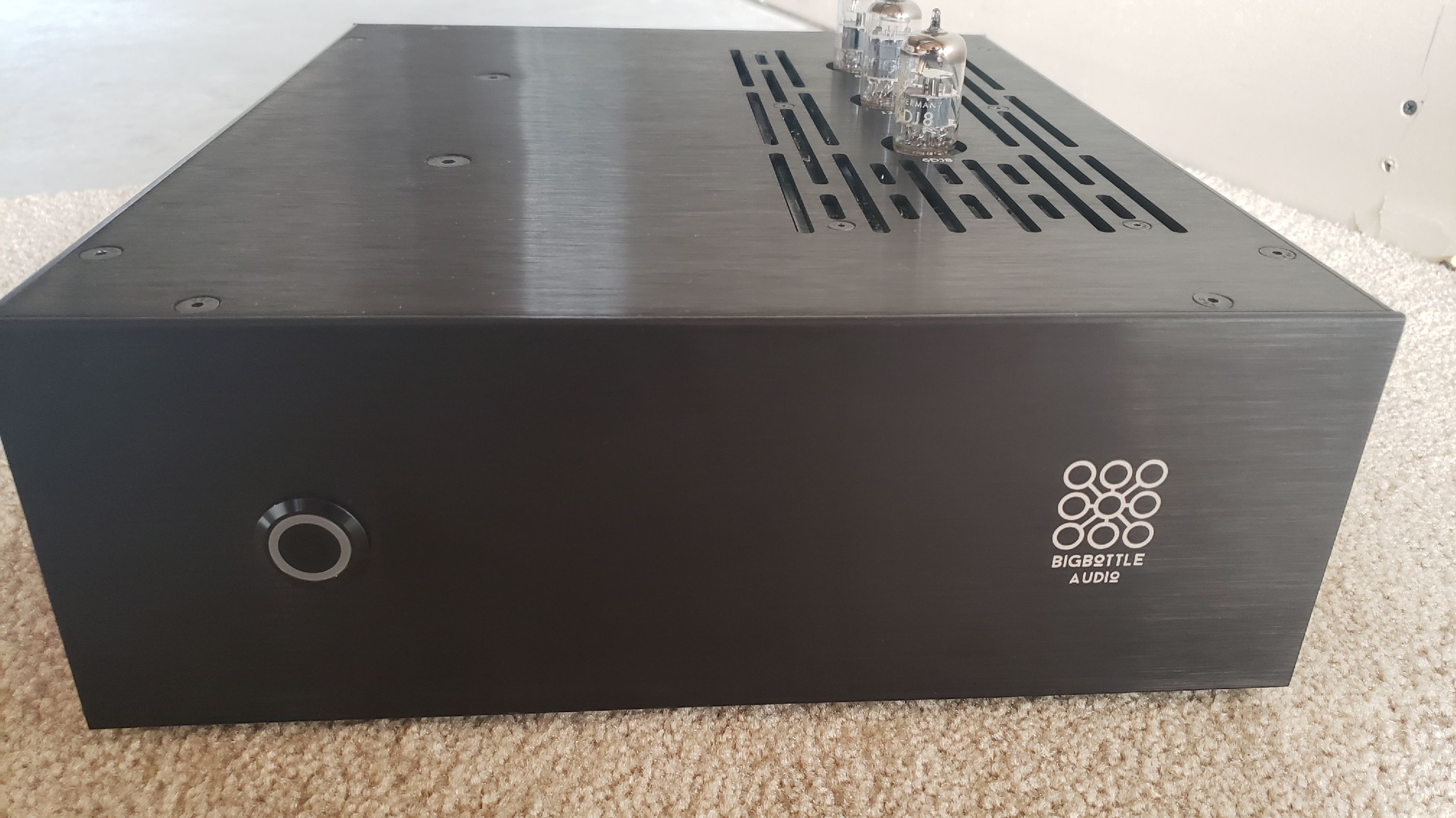

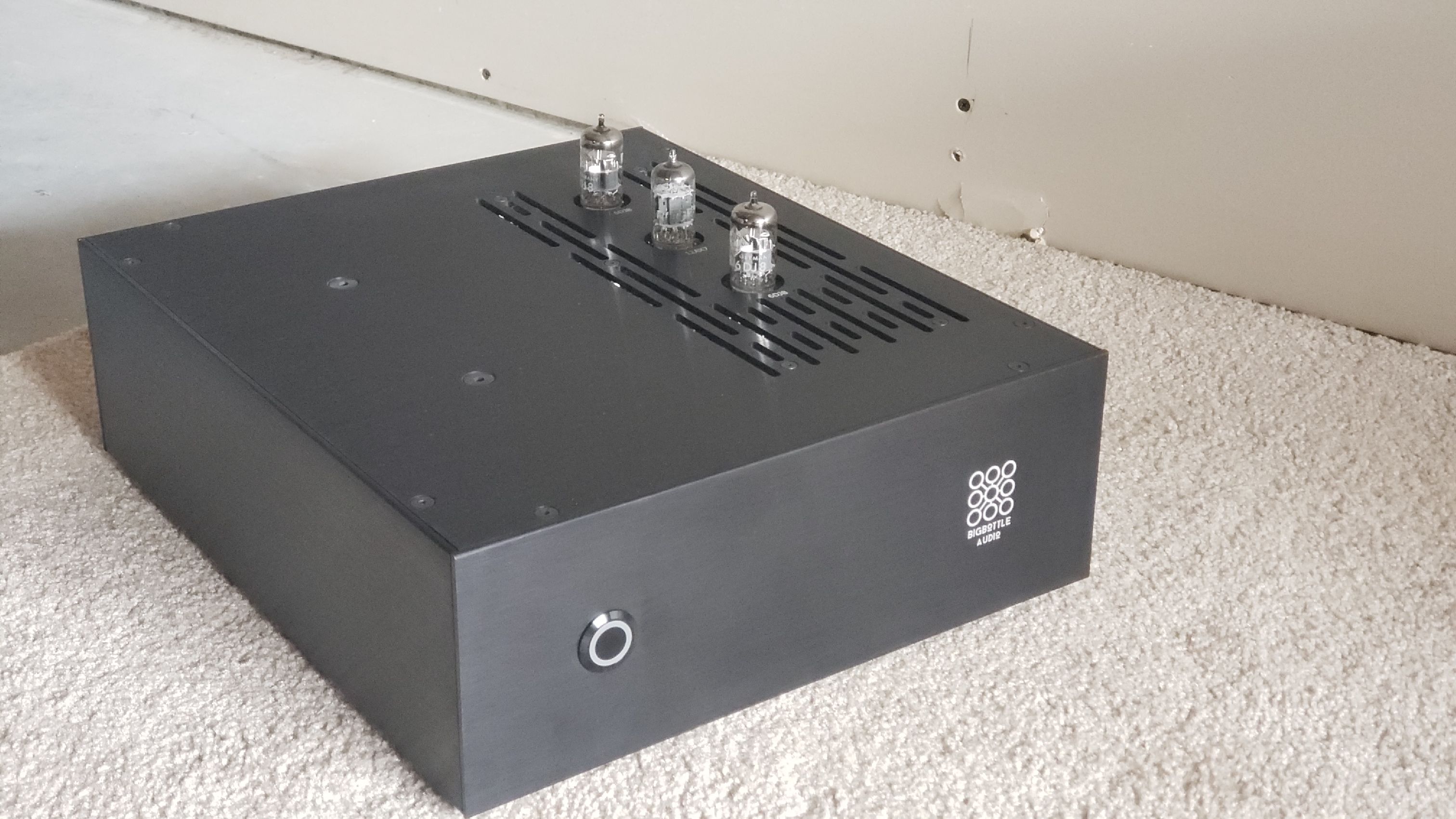

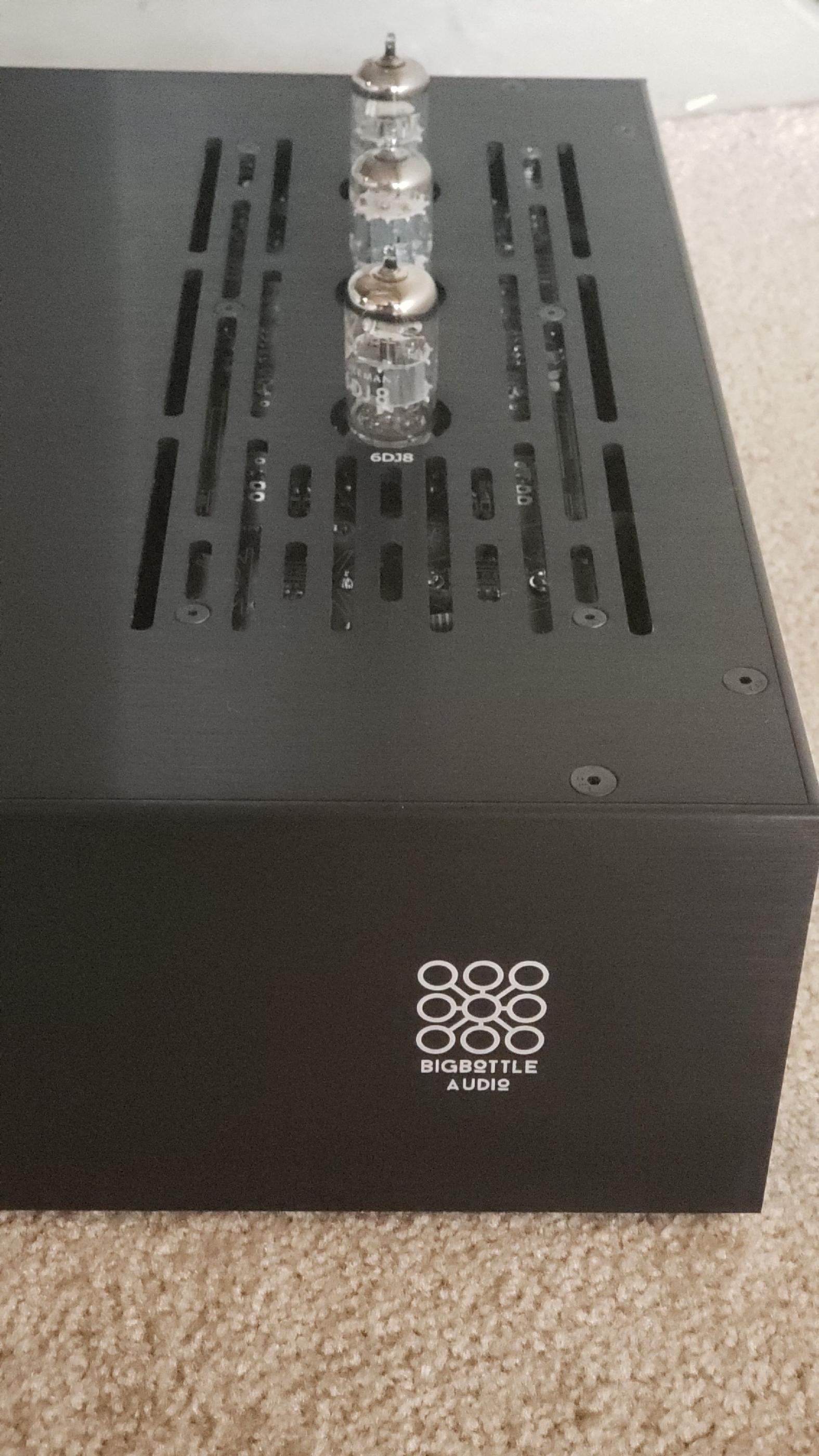

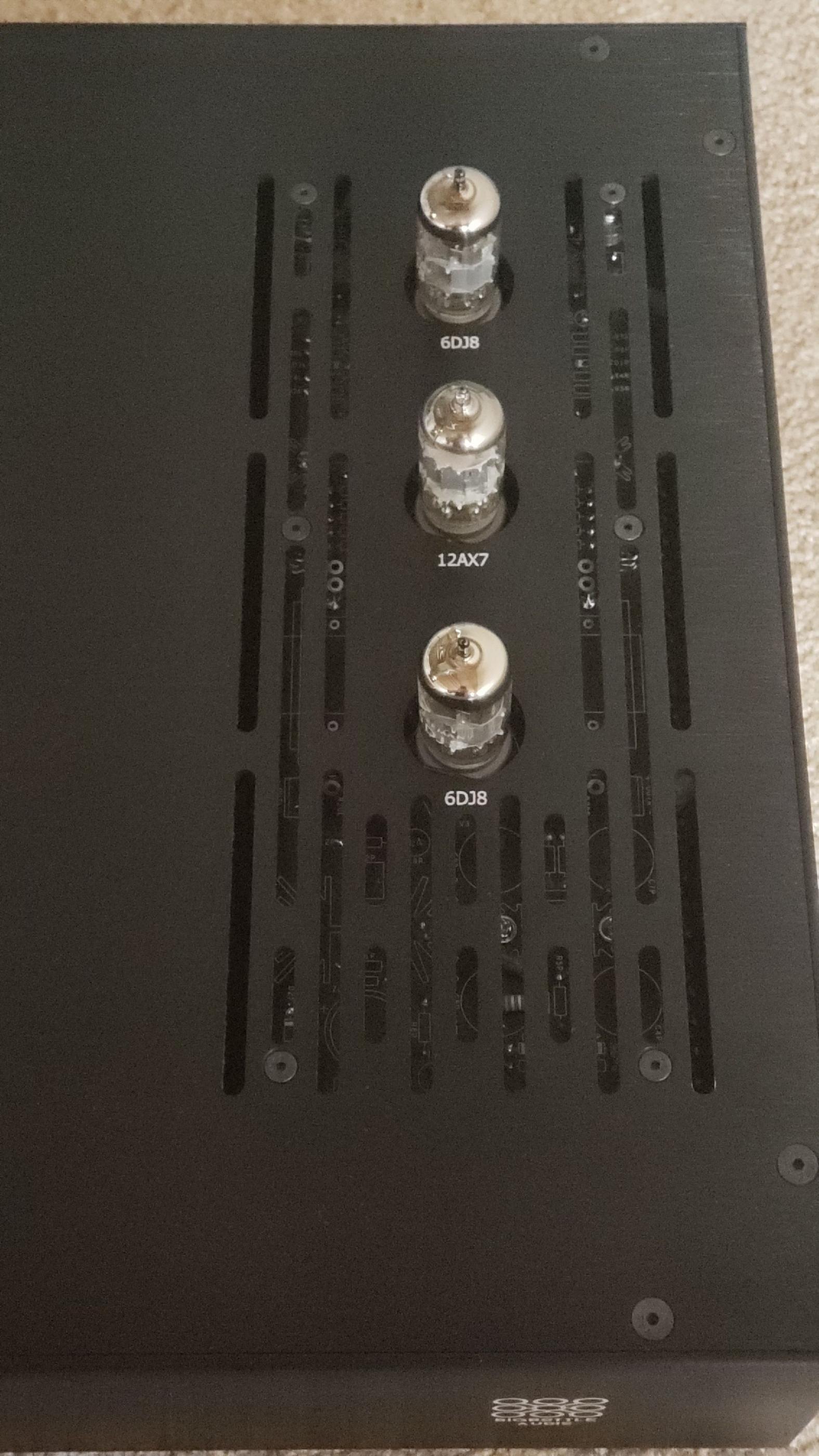

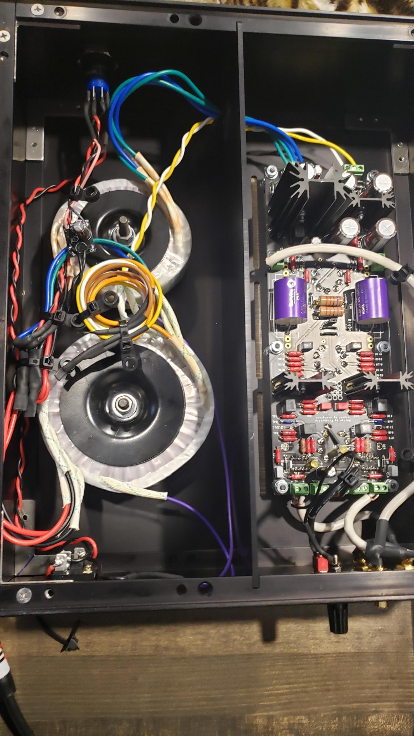

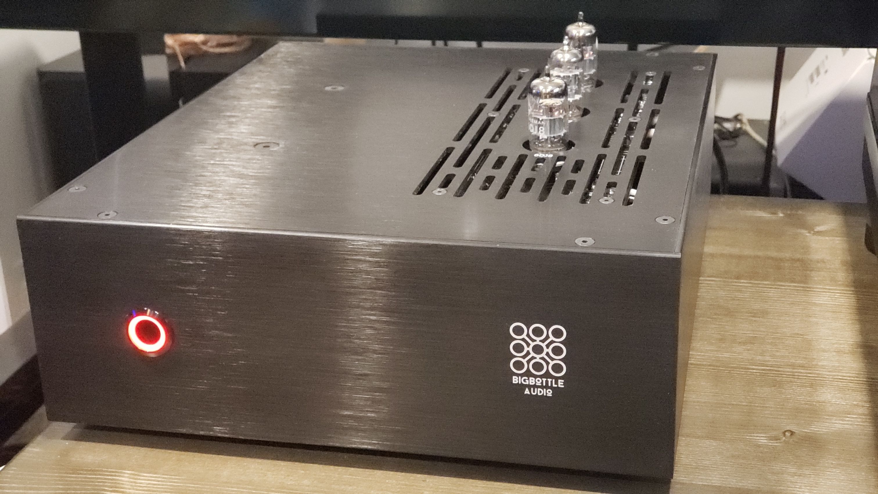

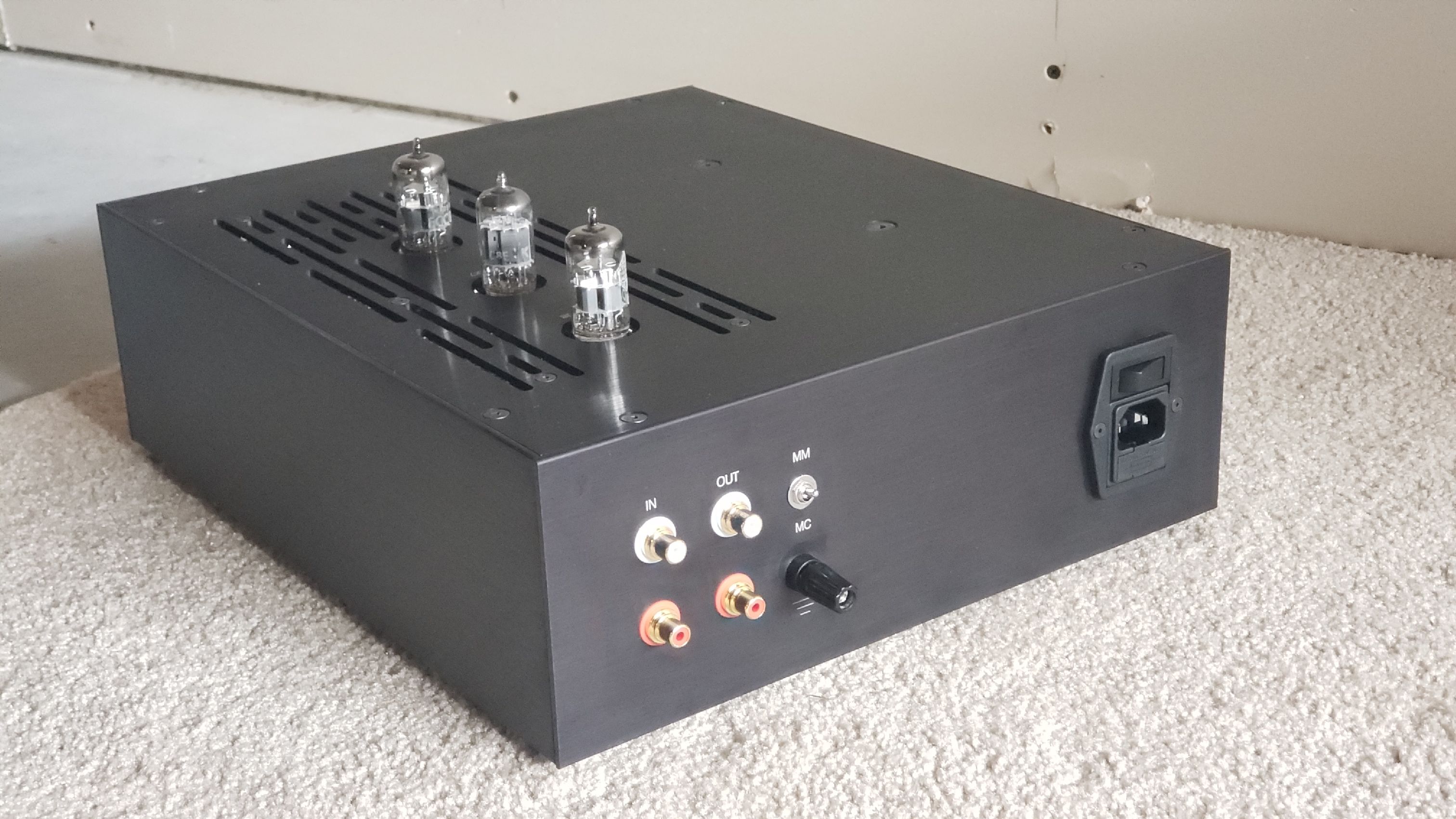

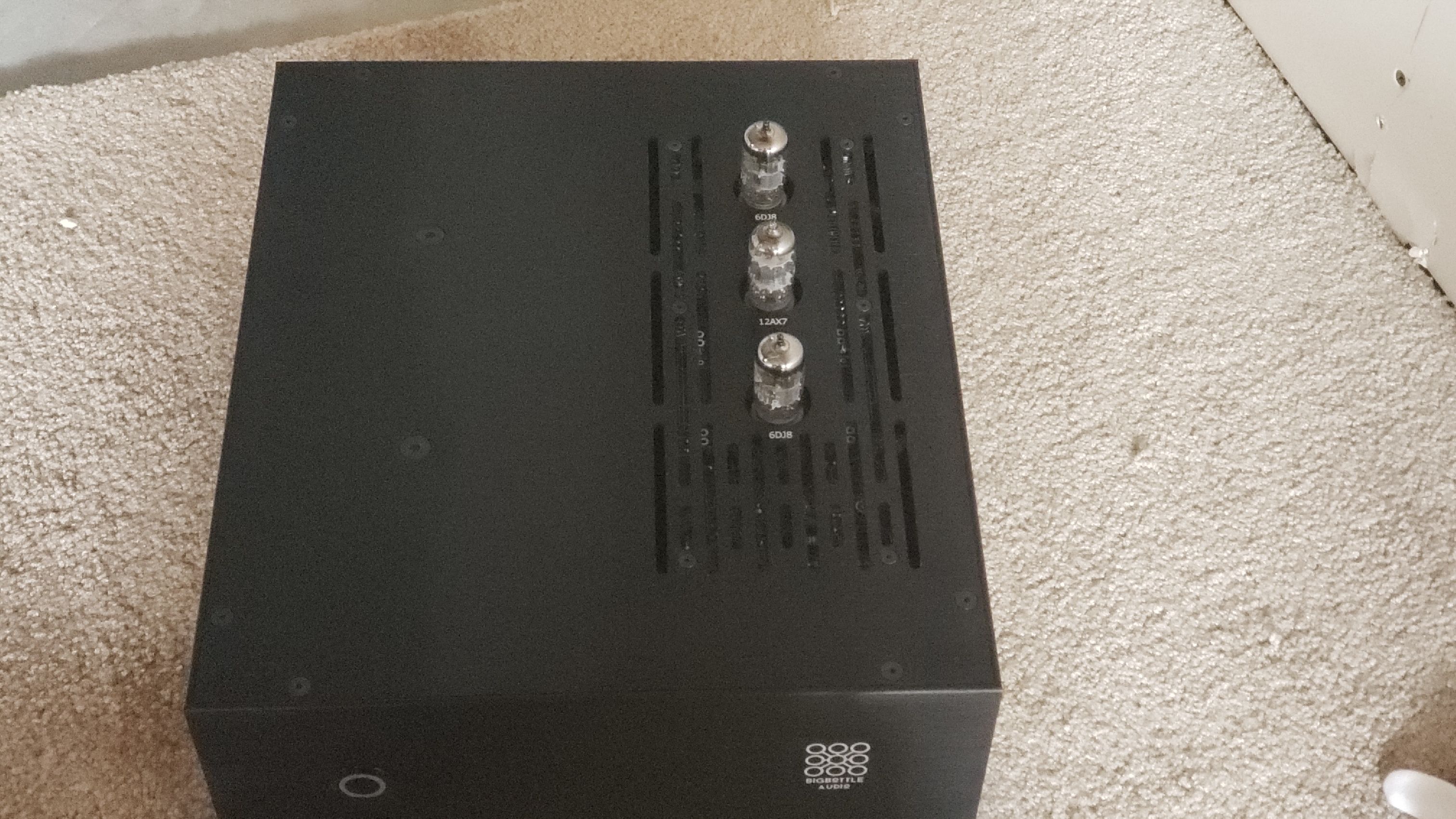

So I FINALLY got my chassis from Landfall (shipping is a bitch from US -> Canada), and just got it all assembled.
Very happy with the result. Love the power switch 🙂, and the whole thing worked out really well, other than the fact that this thing is a fingerprint magnet..
I didn't get a pic of the bottom plate, but it's a mesh plate, so with the venting in the top plate, everything should stay cool enough. Cool air coming in through the bottom and exhausting out the top.
I've attached some pics.
