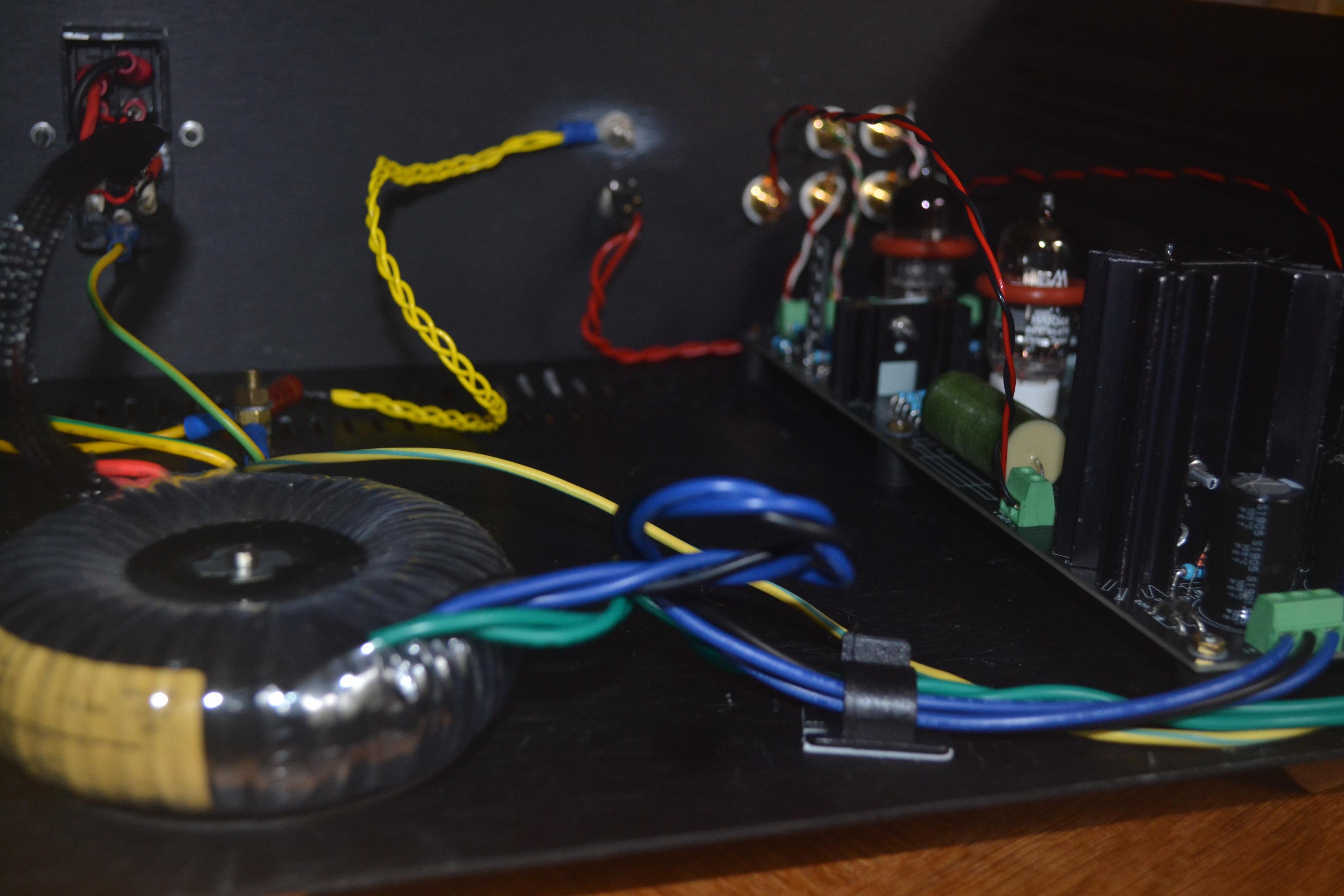

A couple of pics of my build with the James "O" core fitted. Many thanks to Oliver; Alan and Craig for this excellent phono stage which has enhanced my vinyl listening pleasure with it's dynamics and soundstage.
Joined 2009
Looks good. The yellow braid is a nice touch.
Does the transformer meet your expectations? Is there a discernible "O" core advantage?
I need to do some more listening but first impressions are favourable. It meets specification re voltages and is very quiet and professionally finished and despite having to ship from China was cheaper than my UK sourced toroidal.

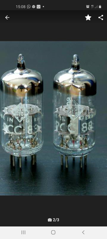

Hello. i think this is for Vivant.
I have now measured the voltages of the tube holders.V2 There are 6N2P and the jumper is in this position.V1 and V2 are 6N23P. currents are measured from 1 to 9
the results are.
V1 : 73 : 0 : 1.49 : 59.3 : 52 : 81.1 : 0 : 1.8 : 0
V2 :117.2 :-4.3To-1.2mV : 0.8 : 58.3 : 52.5 : 115 : -4.6To-0.8mV : 0.8 : 52.1
V3 : 209 : 114.8 : 120.6 : 59.4 : 52.5 : 209.8 : 112.7 : 118.4 : 0
HV is 167 ac LV is 17.7 ac
Where is the fault. or is there a fault anywhere. :)
