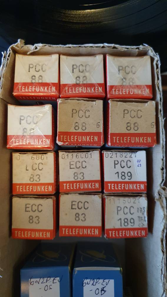

I'm using 2x Siemens made Telefunken PCC88's and 1x 6N2P-EV-OS Reflektor.
But I have a few to choose from [emoji6] View attachment 886993 View attachment 886994 View attachment 886995 View attachment 886996 View attachment 886997

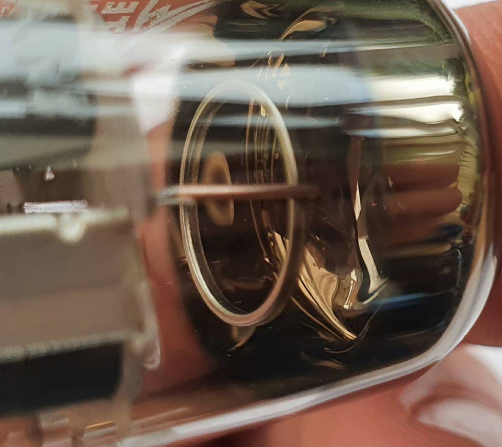

Single arm support on the Getter
Question for Oli
I've quoted one of your previous posts as it's relevant.
On your Telefunken/Siemans PCC88, you say you know they are Siemans manufactured as they have single arm supports on the getters.
My question is, Siemans seem to have two designs, of this, one using a single rod pressed into the to the top plate to support the getter, and one using a bent up extension of the top plate.
Both are single arm.
Can you say which one you are using, and whether one is preferable to the other?
Many thanks

Siemans made a lot of this type for other brands.Question for Oli
Many thanks

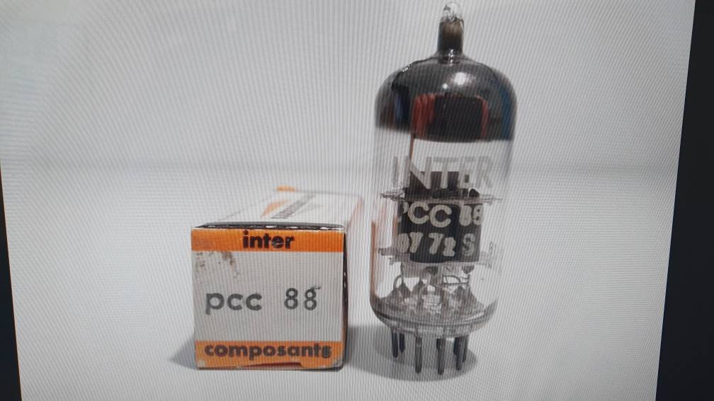

I use them because they are very crisp and clear valves.
Every one of those I have bought has been really microphonic. I've had 6 and they were all bad.Oliver, how do the Tesla PCC88s compare to them?
Kevin
May have just been unlucky but I haven't bought any more to find out

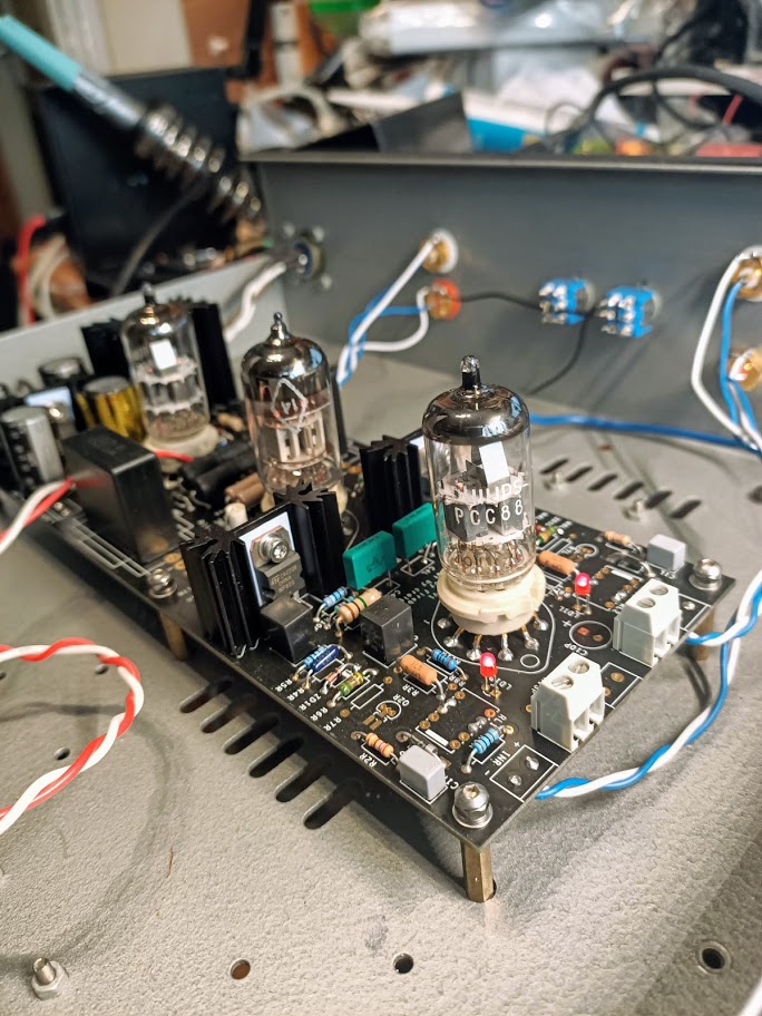

Finally finished this Beauty! New job and move to a new place came in the way, but this has been very rewardig. Soldering and wiring was pretty much straight forward, especially since Bigman 80 soldered the smd parts for me, many thanks for that!
It sounds very nice, I hear details very clear and the sound is organic and fluid. I was very satisfied with my Musical Fidelity lx riaa but this is another league.
Again, thanks to Oliver and Alan for making this project possible.

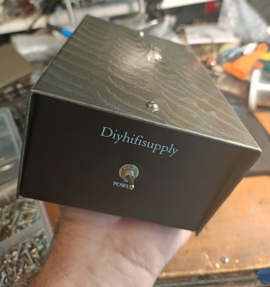

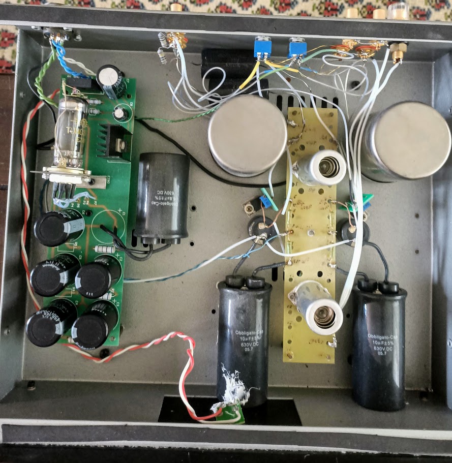

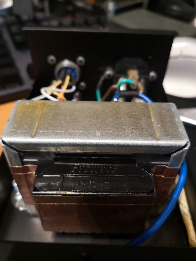

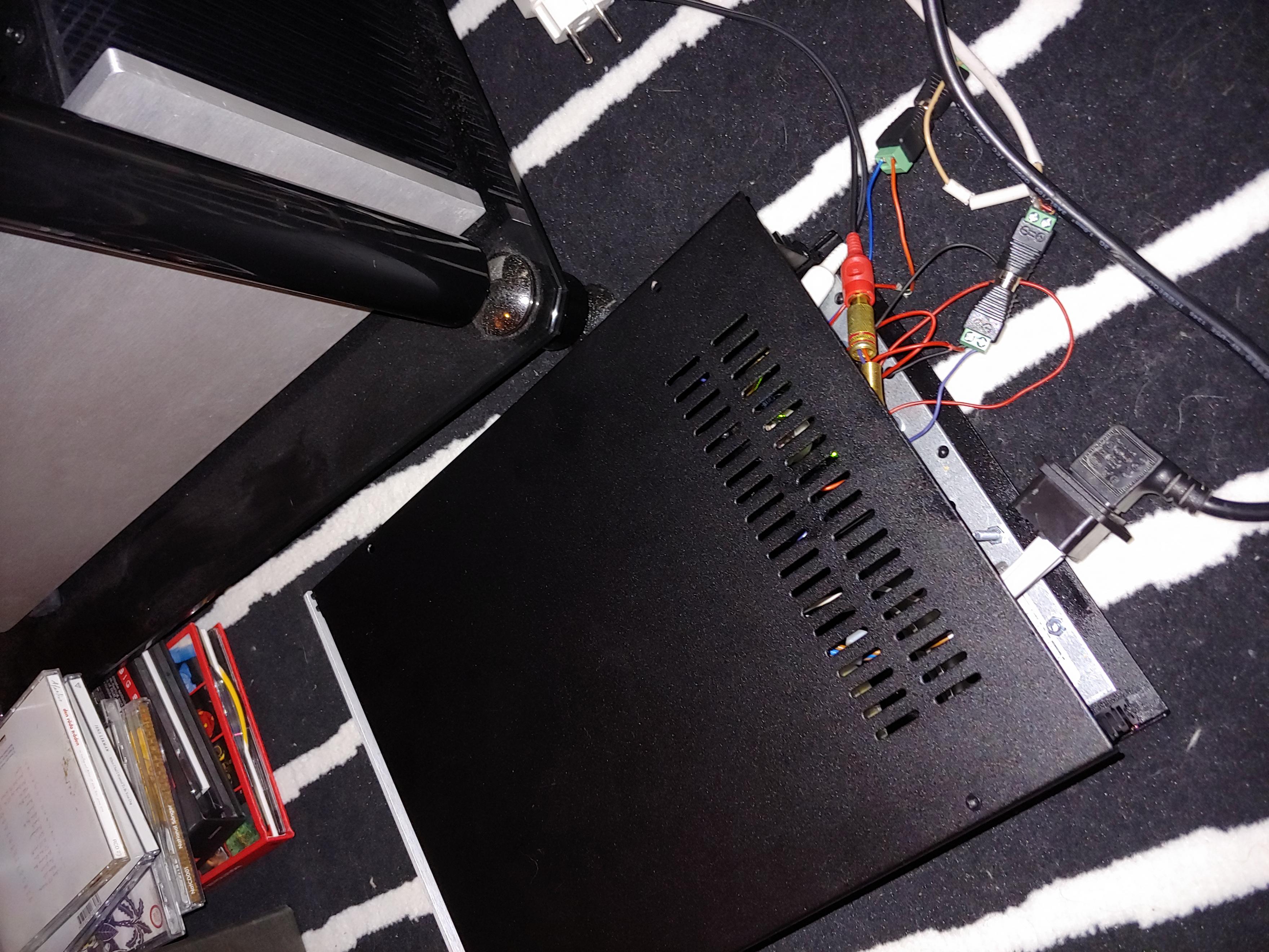

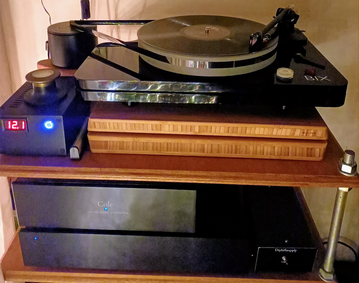

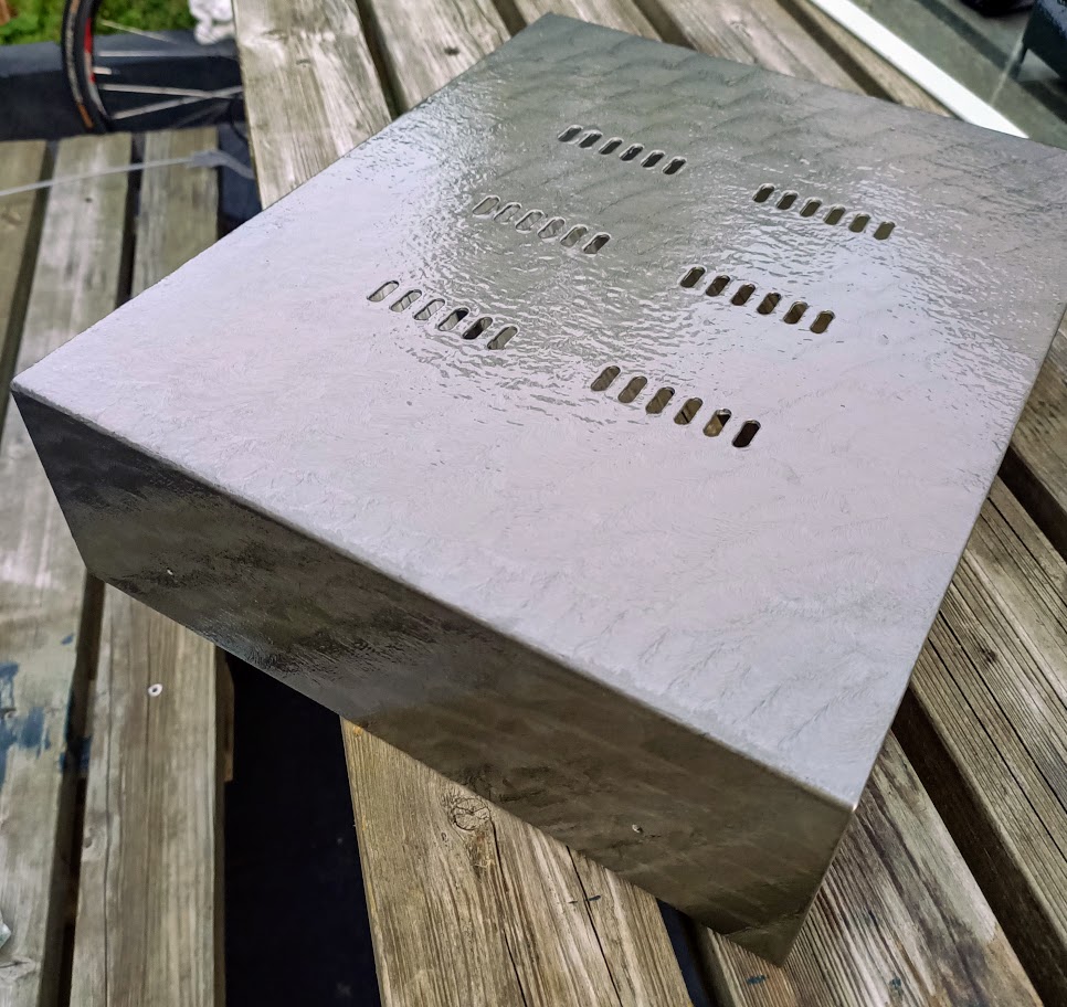

Finally have my bigbottle up and running. I used my diyhifisupply Cole as the donor chassis. I've always had some humm I could not chase down...or I did not try hard enough to get rid of. I repainted the covers. Ripped everything out. Cleaned the rca sockets...
Got the transformer I bought from Ollie and put it in the donor psu unit...etc.
Can't compare it because the last time I spun some vinyl must have been 10 years ago. I did have some hum then and an intermittent channel. My system has evolved and I have a cartridge I've never listened to. That is so new it has not even done 10 hours yet.
But it is completely quiet. And sounds great!
Phillips PCC88's and a Russian ECC83 type.

Well done Bas,Finally have my bigbottle up and running. I used my diyhifisupply Cole as the donor chassis. I've always had some humm I could not chase down...or I did not try hard enough to get rid of. I repainted the covers. Ripped everything out. Cleaned the rca sockets...
Take a wire from the chassis to the vacant centre terminal on the HV terminal block.
That would be my next move if there is some hum.
Swap out those Philips....they aren't great valves IME. A pair of Matsushita will cost you £30 and be a large improvement.
Glad to see it's up and running.
No humm and very quiet. I was referring to the donor unit.
Now that it all works...I'll go and seek some "better" tubes. Those Philips were what I had lying in my parts box.
Thanks for the tip.Take a wire from the chassis to the vacant centre terminal on the HV terminal block
