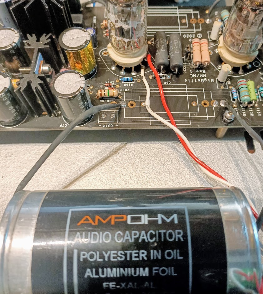

That's a good move! Those caps play a significant part in what's going to come out of the speaker.O yes. And I did replace the industrial 2.2uF caps with some better ones. Everything improved. Bass. Tone, etc. etc.
Glad all is quiet and working.

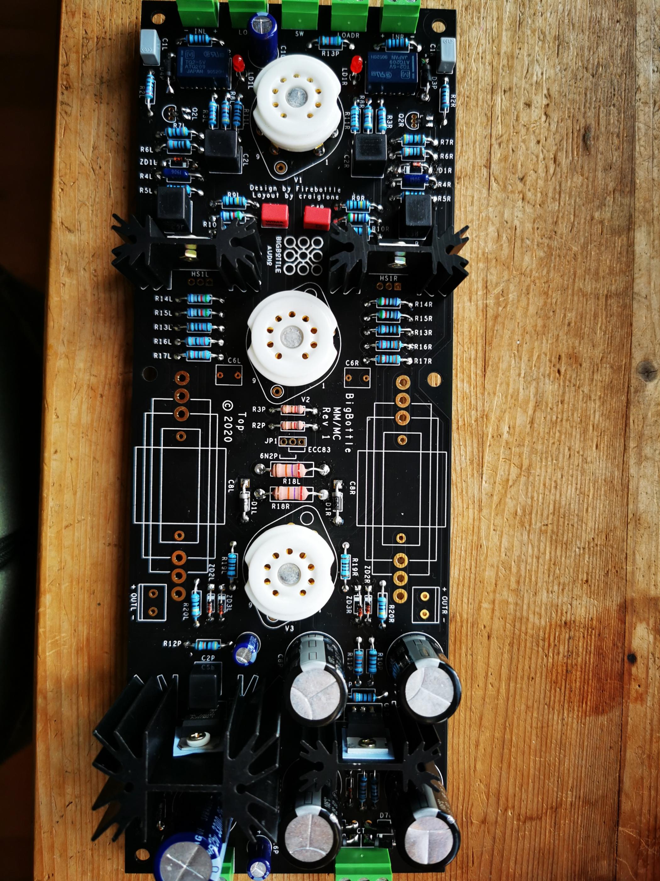

I have a strange problem. The tube heaters don't work. Tubes don't get any voltage at pins 4 & 5 (PCC88) and 4 & 9 (ECC83).
If I remove the tubes from sockets, I have 7.87V at those pins. When I insert them, I get 0V between those pins ... I tried inserting the tubes separately, but no luck.
Other than that, I notices the LEDs don't work, tried to flip them, no luck.
Relays are working when I toggle MM/MC switch.
Please, help.
I've quoted Flikomans post as I have the same problem. The only difference was the relays weren't working either. Strangely enough I found my brand new 7805 also from Mouser was faulty. That's simple enough I thought so I changed it with a L7805CV, from Amazon, which was all I could get at short notice.
I still have the same problem, the only difference is that the relays now click when toggling to MM. LEDs do not light.
Like Flikoman, I'm getting voltage (spot on at 7v on the pc88's) on the heaters, as soon as I put a tube in, it disappears.
Help please.
The modern 7805 regulators with the very thin metal tab are somehow different to the older versions with the thick metal tab.
The new ones don't cope with the current surge on switch on when the heaters are cold and low resistance.
The preferred regulator is a Texas Instruments LM340T-5, this is available from Mouser.
The MM mode Leds next to the relays will only light when V1 is conducting so won't light if you have no heater supply.
Thanks for that, I've ordered LM340T-5.
Another point is the 7805 I took out was definitely faulty, I've now replaced it twice (with the L7805's from Amazon) and both times they were showing 5 volts on the output when first powered, but dropped subsequently.
Is this typical with what happens when the units fail?
Not all 7805 are equal.Thanks for that, I've ordered LM340T-5.
The ones linked in the BOM are good, the ones I use now are the same as the ones Alan mentioned
Yes, I did originally use a Mouser 7805 from the BOM, the Amazon ones were just a case of quick availability.
I'll wait for the Texas Instuments replacements I've now ordered from Farnell.
