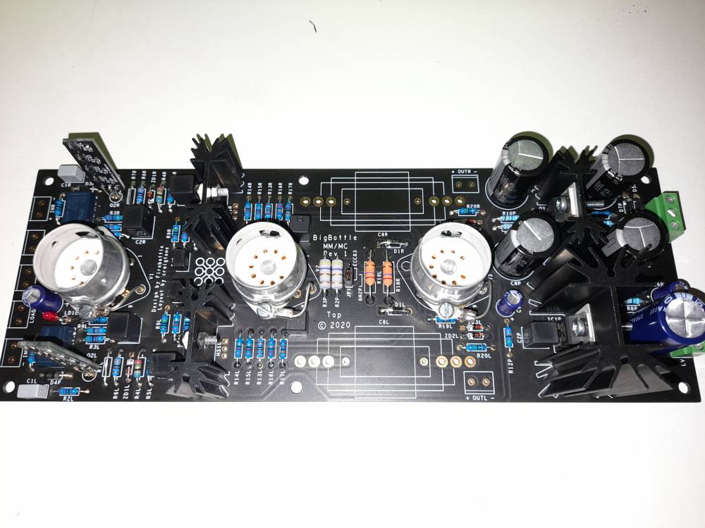

My pcb populated except for the output caps. I used 0.1% resistors and matched them to equal values. I was a little surprised how close values are but almost all were not the exact value. Plenty resistors for future projects..
I think I put the multifet board in the right way. I couldn't find pics here with the multifet board in place so I peeked at your Ebay listing Oliver. It occurs to me now that I could have used the data sheet of the fet...
You may notice the tube sockets are different from the Beltons so I had to improvise on grounding them. I plan to have the shields on them because I have them in a box anyway. And isolation on the heatsinks [emoji1303].
So now waiting on the transformer and saving some money for a nice pair of output caps. Great project so far!

That looks tidy, and yes the MultiFET PCBs are the right way round.My pcb populated except for the output caps. I used 0.1% resistors and matched them to equal values. I was a little surprised how close values are but almost all were not the exact value. Plenty resistors for future projects..

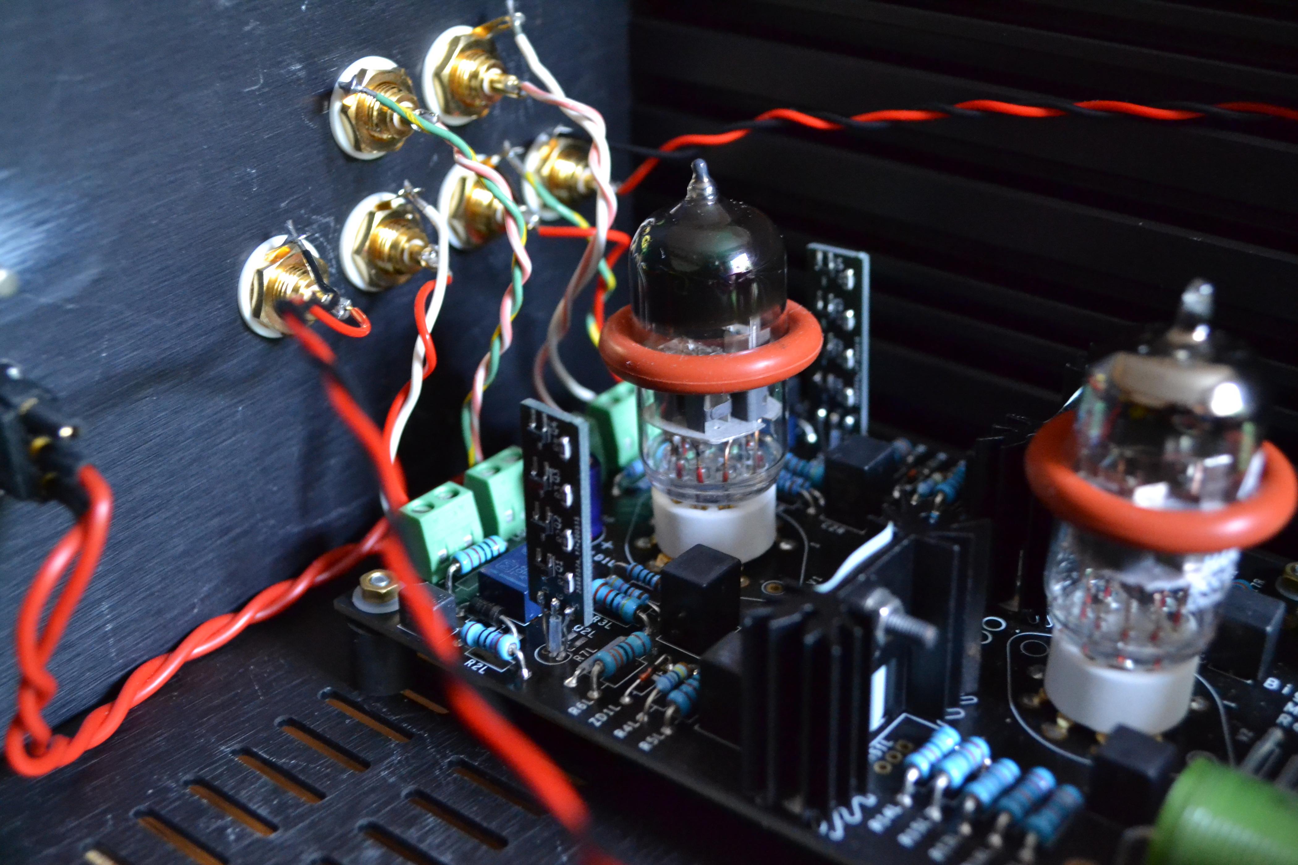

That logo looks great.....where was it from?It took me way longer than I'd intended to fit the multifet boards but they are now in so time for some listening. I added the logo to the front panel to.
