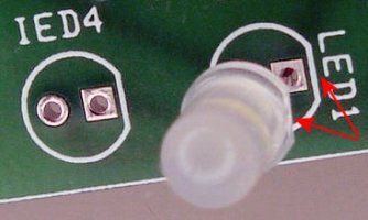

Oliver, could you please confirm:

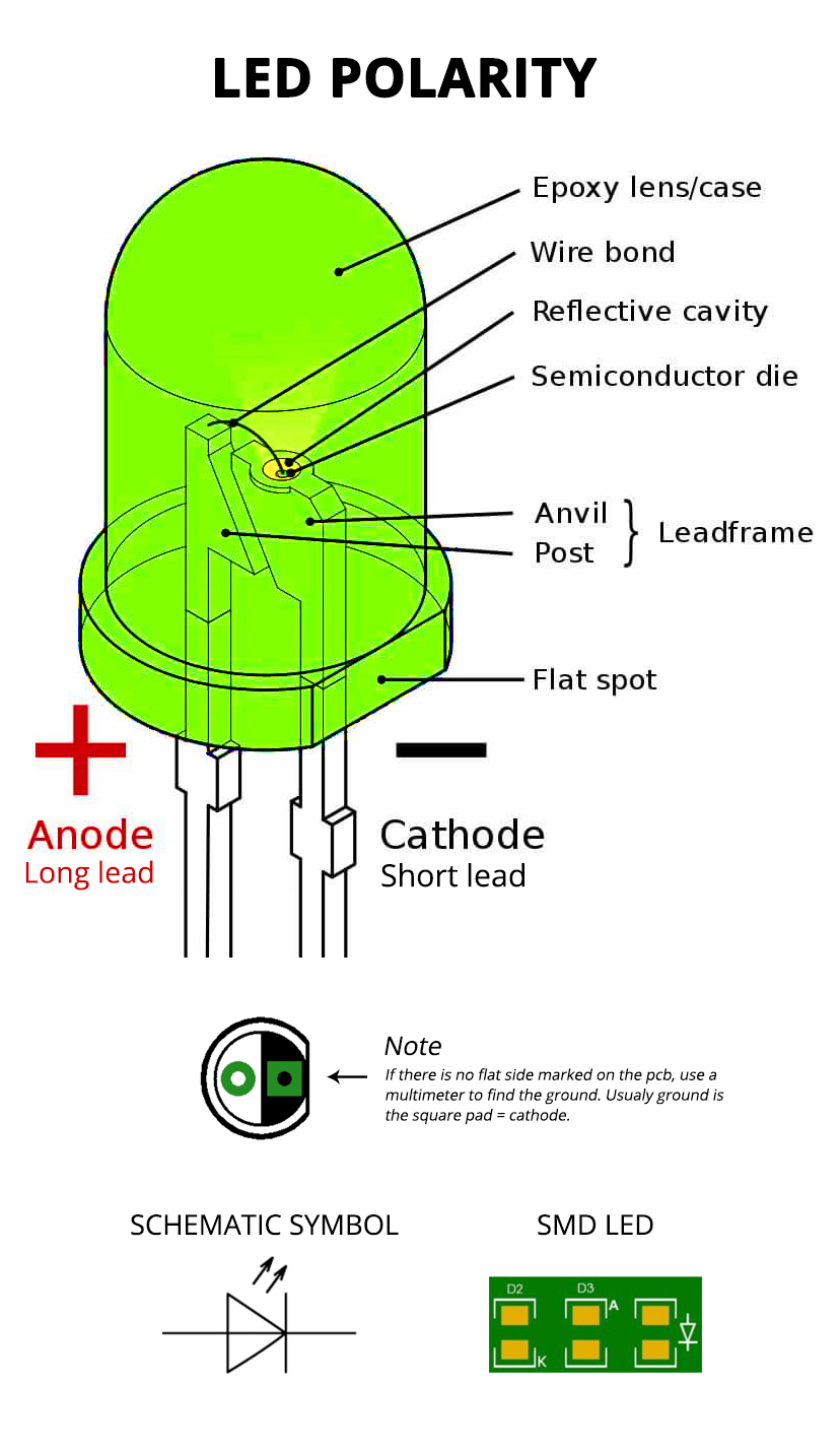

Position of LED, square pad is Anode?

Square pad = Cathode.

Position of LED, square pad is Anode? - see diagram above.
