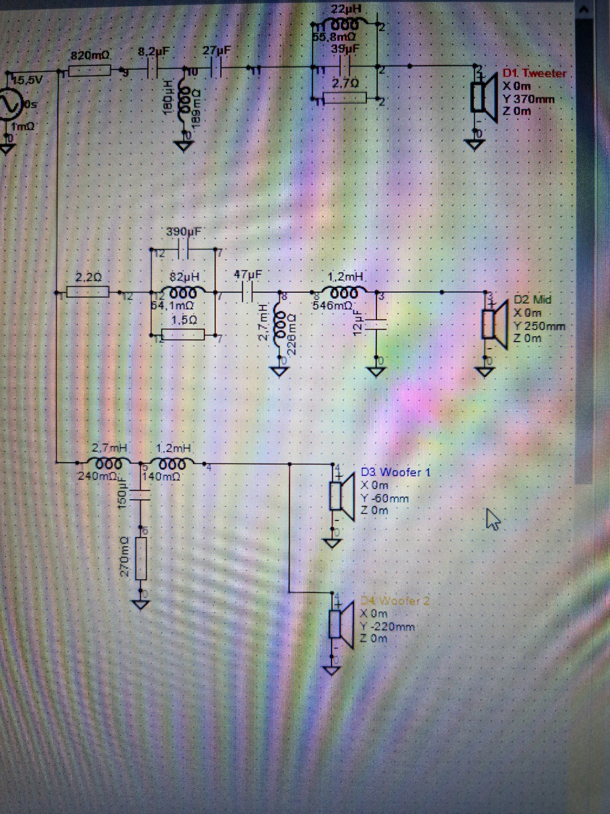

The crossover you were using was for the Mission and Pluvia combo? I can't sim that, as I don't know the TS parameters of the Mission woofer. If you really want to understand what you're doing, I'd suggest you should give Basta a go yourself. It's a free download from the Tolvan data website. (Or try other software, xsim for example.)
The 0.5 marking on the inductor that burnt out almost certainly means 0.5mm diameter wire. That's a very light gauge for a series woofer inductor. I don't understand where the resistor was in your circuit - it's not shown in the diagram.
If I was you I'd read up more on speaker design before going any further. You're lucky it was just a few components that went up in smoke.
Thank you @ianbo and @Wootoo !
The resistor was the final component in the circuit on the tweeter side. It's not in the diagram but I added it into the circuit to compensate for differences in sensitivity, balancing the output volumes of the two drivers.
I did mean this crossover, but with the Peerless or Dayton 12" woofers I had suggested, not the Mission driver (I used that temporarily to test the principle of the WAW design and try building a crossover before committing to v expensive cabinet builds). However, I appreciate I was pushing my luck – don't worry if it's too much effort. Unfortunately Basta!, like all the the other sim software, seems to be PC-only. I only have access to a mac, which is becoming a real pain! I'd love to be able to do some simulating.The crossover you were using was for the Mission and Pluvia combo? I can't sim that, as I don't know the TS parameters of the Mission woofer.

@lewisb I'm sorry if my previous post was a bit harsh. But burnt out crossover parts are actually quite unusual, and are a real safety concern.
I'm troubled that the resistor you added in series with the pluvia was a 15 ohm - that's very high! A 15 ohm resistor in front of an 8 ohm driver will be dissipating most of the power you send it, and cutting the sensitivity of the driver hugely. Playing a speaker like that at party levels is not a good idea. (10 W is usually ok for resistors on mid/treble crossovers - its the 15 ohm resistance that bothers me.)
I'm puzzled as to why you needed such a big resistor to get the balance right. It makes me wonder if the 4.7mH coil on the woofer was an air core part? If so, it would have a very high dcr, (maybe in the region of 4 ohms?) which would again mean it was dissipating a lot of power, and cutting the sensitivity of woofer significantly. I'm guessing, though.
A woofer inductor should usually have low dcr - well under 1 ohm. Hence cored inductors tend to be chosen. Apart from the issue of damping, low dcr means low power dissipation, and much less danger of overheating. Go for whatever wire gauge gives you something like 0.3 ohms dcr. (1mm would be a reasonable starting point, probably.)

This is all starting to add up. The resistor wasn't fit for purpose, both because it was a cheap 10W one (more sensitive to burning out) and because it was dissipating too much power. I was using such a strong resistor unnecessarily, probably in part because the prototype speaker was using a different woofer to the driver I'll eventually be using, and likely a less sensitive woofer. So the 15ohm resistor was compensating for that, I imagine. It was also generating quite a low-end-heavy sound (which I don't mind), so was probably higher rated than needed.
Making matters worse – thanks @ianbo for flagging this – the inductor which got burnt out (one of these, 3808: https://impactaudio.co.uk/products/visaton-kn-ferrite-core-coils?variant=15302709805123) also wasn't fit for purpose. Not only because of the thin wire gauge, but because of its dcr of 2ohm.
So my takeaways are:
I feel like the burnt crossover makes sense now, and I know how to avoid the same happening again. So I'm tempted to build these speakers up. Unfortunately I haven't been able to do any proper simulation but I'm not sure there's an easy way around that! It can't sound that badd... can it?
Lewis
- Try to get a higher sensitivity woofer if possible, so ideally i won't need a resistor on the wideband driver at all
- Use higher quality crossover components with appropriate wattage and wire guages
- In particular, make sure my inductors are low dcr so they're not adding unwanted resistance to the circuit
