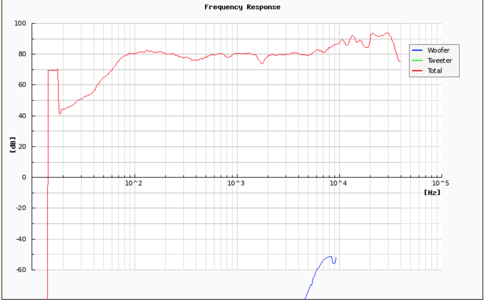

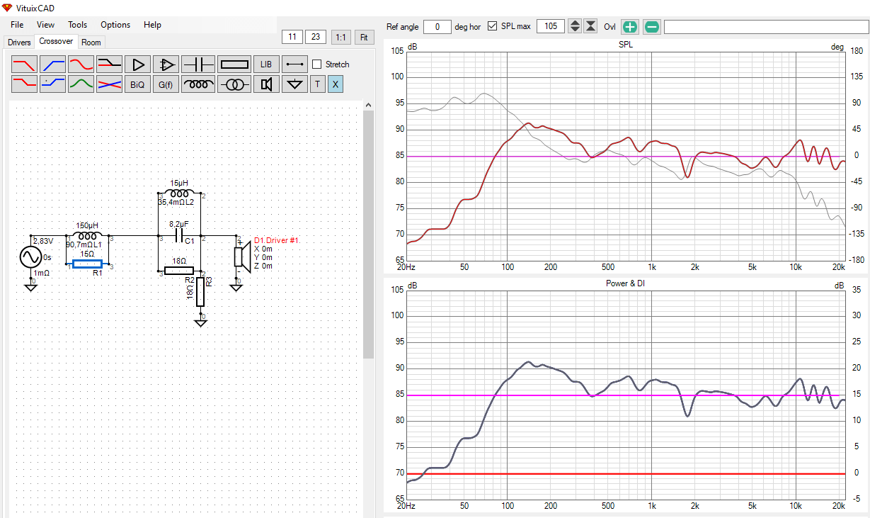

Hey @lewisb just having a look at it now. Made an frd file from the data provided by the sheets but the response is looking terrible 😂
This is going to take too much of my free time I'm afraid and I don't have that many.... maybe someone who's more into full range drivers can help out?
This is the best i can simulate the Pluvia with the data from markaudio. adding the woofer creates a load of phase issues.
looking at the frequency response.... this is terrible...
made the frd and zma files with SPL Trace inside Vituix.
  • frd pluvia_SPL.txt
    frd pluvia_SPL.txt
  • ohm pluvia_ZR.txt
    ohm pluvia_ZR.txt
