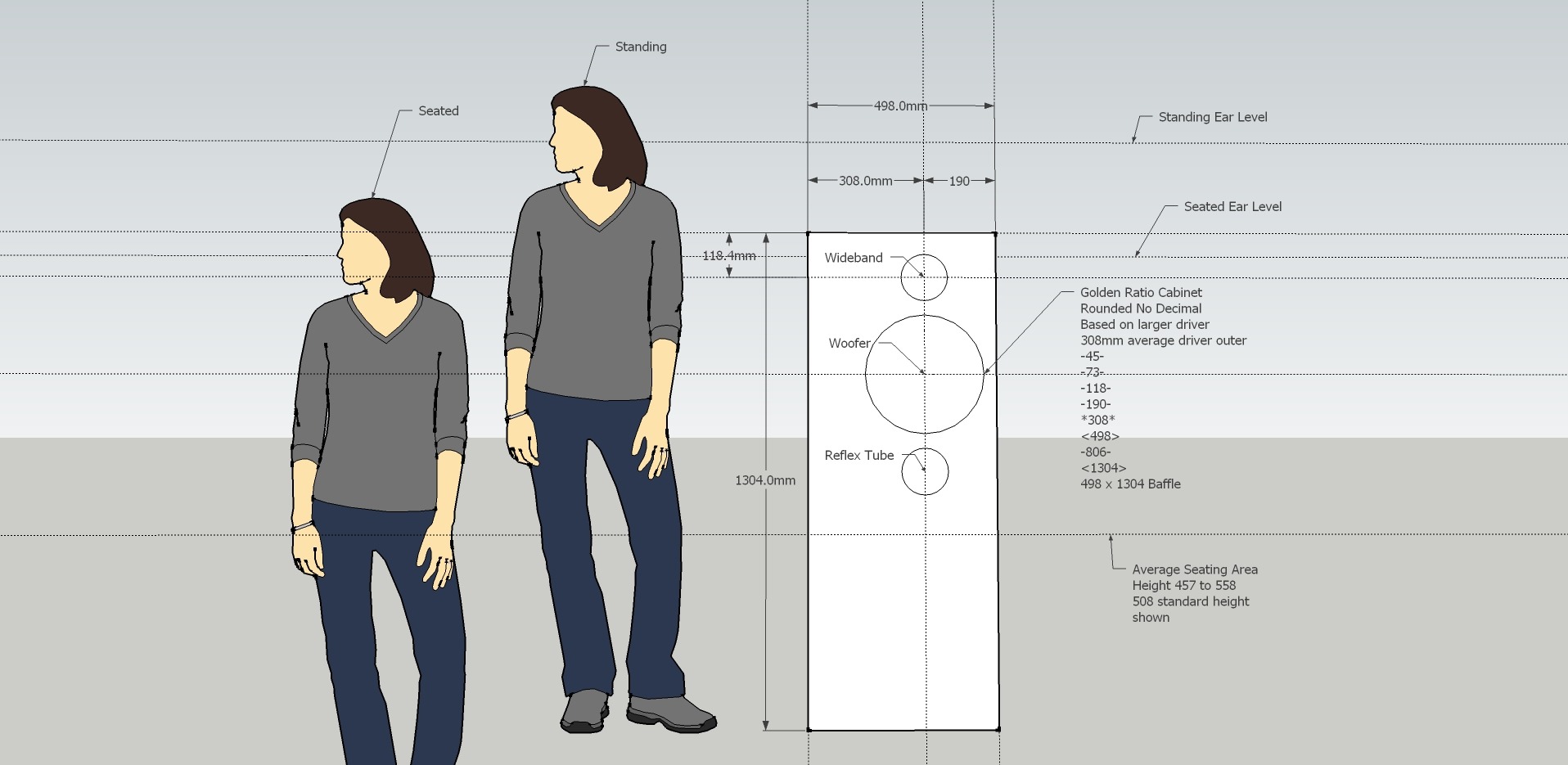

My concern with initial posted drawings was driver spaced so far apart.
Far as straight forward Rectangles. I tend to get good flat response
using wider Ratio.
Usually based on Golden Ratio. Using larger driver outer edge size in the design.
Likewise driver offset center for least diffraction based on smaller numbers from same
Golden Ratio
I have numerous generic drawings for reference for Golden Ratios
and drawn to see seating/standing heights
Anyways Here is basic Generic 498mm x 1304mm Golden Ratio Tower
for 12" driver. Ratio chart rounded up for no decimals.
I'll insert as thumbnail, likely click for larger view
Ironically in numerous sims I have found if driver
is offset according to Golden Ratio. Usually yields
move favorable diffraction. I make a measurement list from
small to large ratio based on largest driver.
Best location usually falls to the ratio

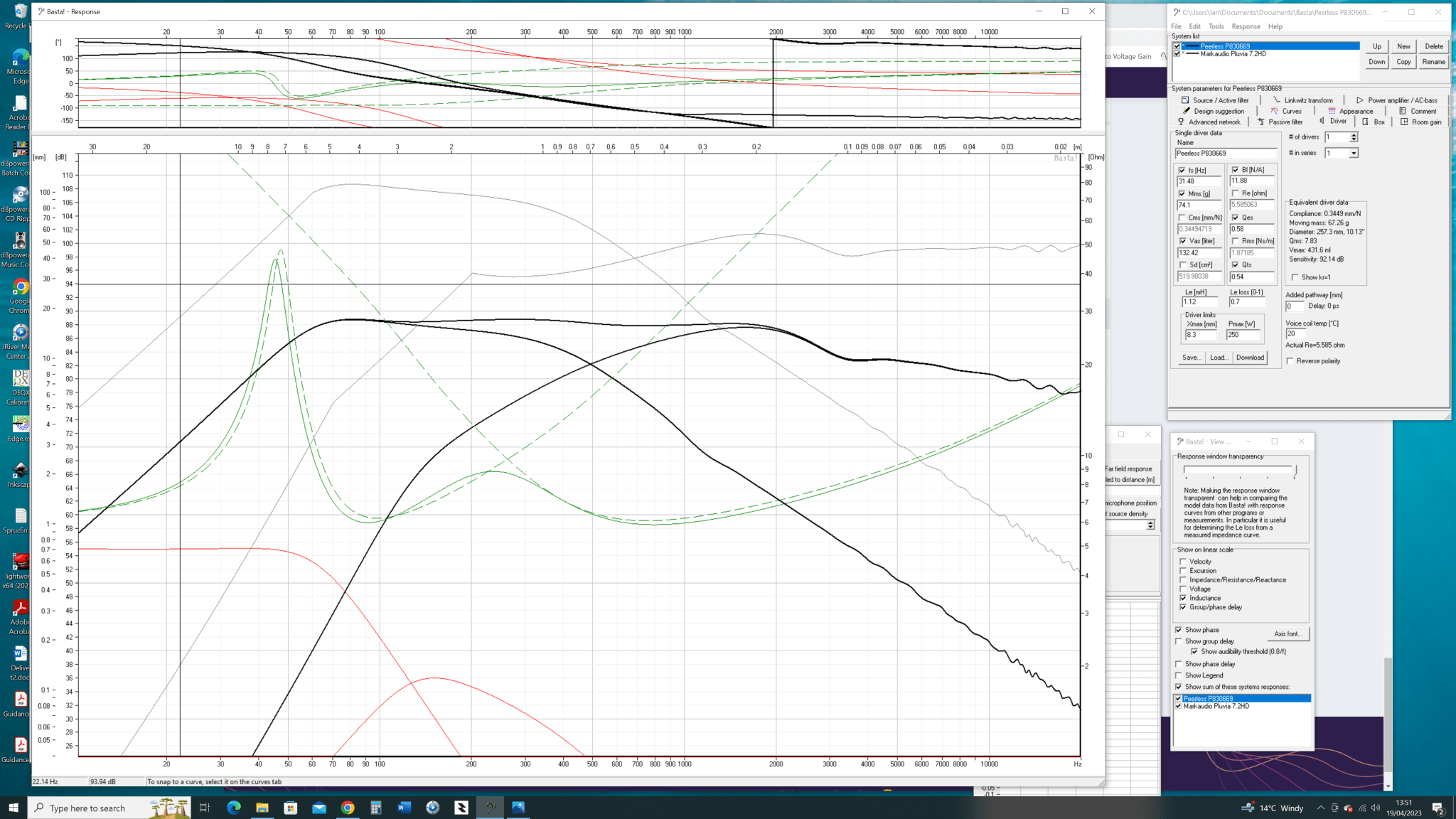

Here's a sim of your suggested design, done in Basta. The Peerless 830669 is in 74.5 litres sealed, and the Pluvia 7.2HD is in 4 litres. I've used 1st order electrical filter on the woofer (5mH), with a zobel (5.6 ohms, 36uF), which gives a reasonable approximation of a 2nd order acoustic filter. The Pluvia has 2nd order highpass (50uF and 4mH) and is padded down with a 1 ohm series resistor. Its phase is reversed.
The sim does not use any measurements or traced responses - just published T/S parameters, so it is of limited value. It does include baffle effects, though. (Traced responses, based on the drivers in different baffles, are of limited value too.) Real-world crossover might well benefit from different values.

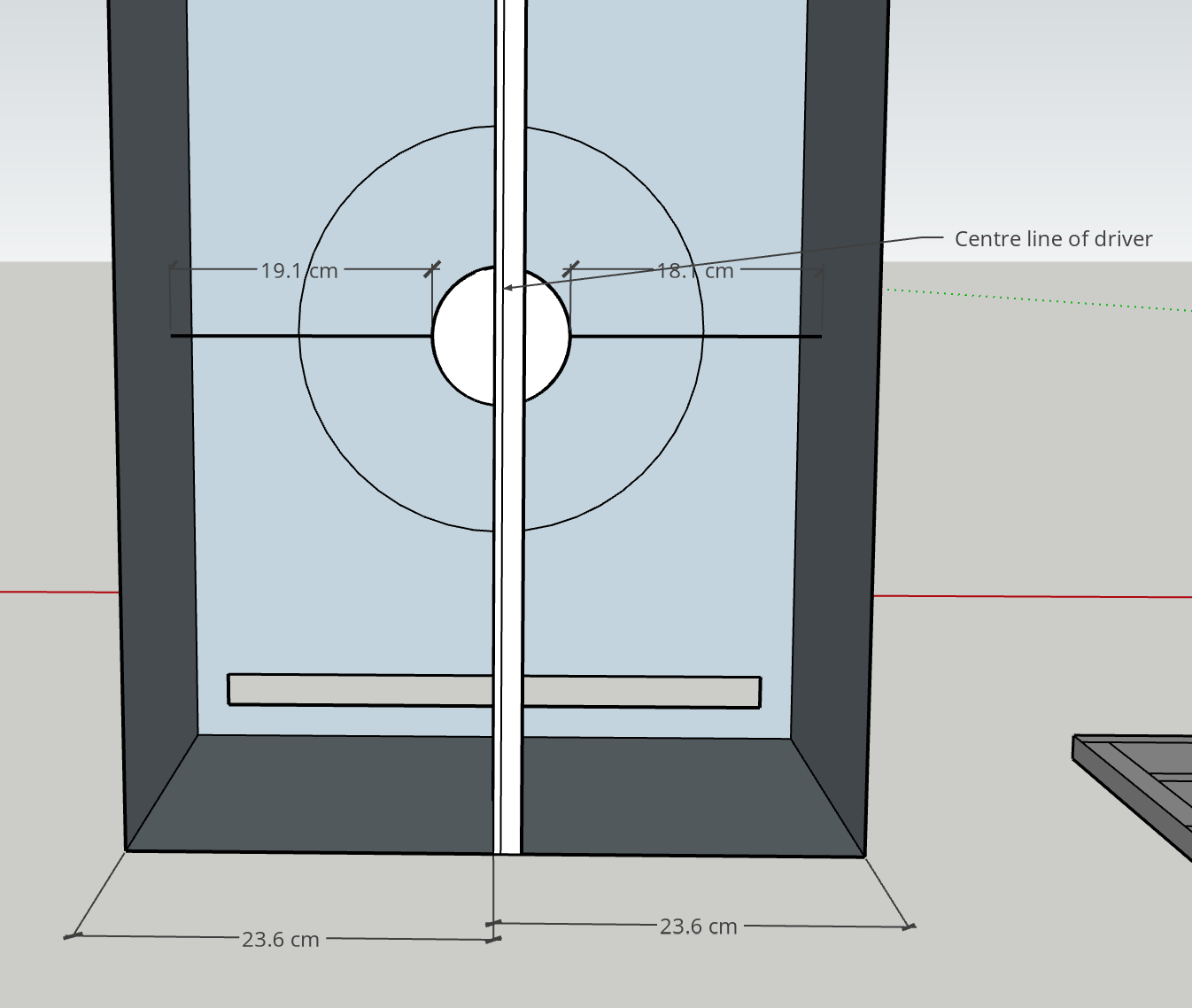

I'd strongly urge you to get rid of the raised periscope, to get the drivers closer together. How about making the woofer box a little taller, and putting the Pluvia in a cylinder on top? Also, I'm not sure that venting that woofer box is a good idea. The Peerless woofer has quite high Qts, 0.54, and a vented box would need to be a lot bigger than 75 litres, I think, to work well. Even a sealed box could benefit from more litres. Crossover has ended up around 500Hz. Personally, I think that's fine for those drivers. I wouldn't worry about the Pluvia being too small. I have a 2 inch wide range driver crossed at 600 Hz to a 10 inch woofer, and I really like the combo.
Just my tuppenceworth. 🙂

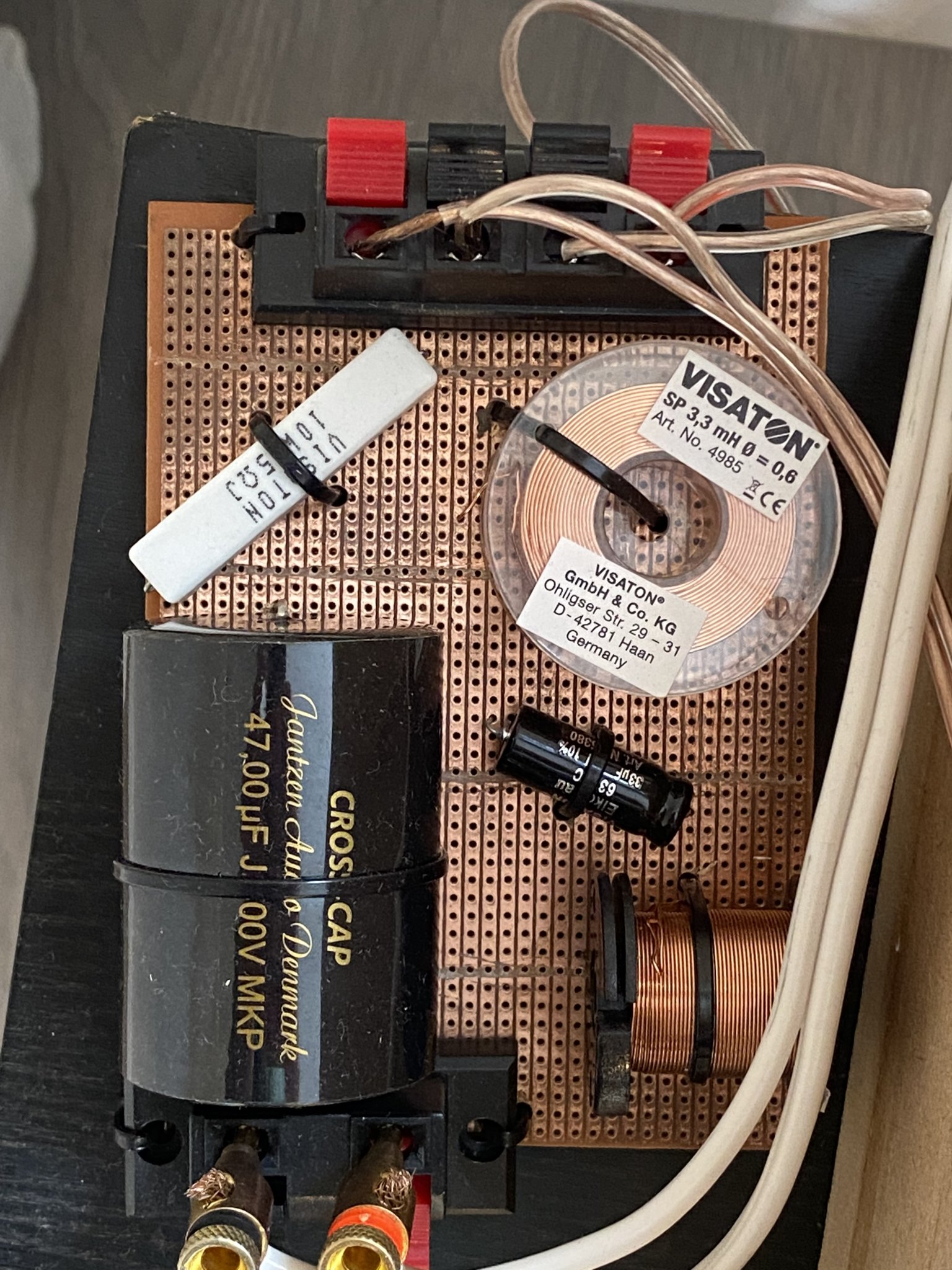

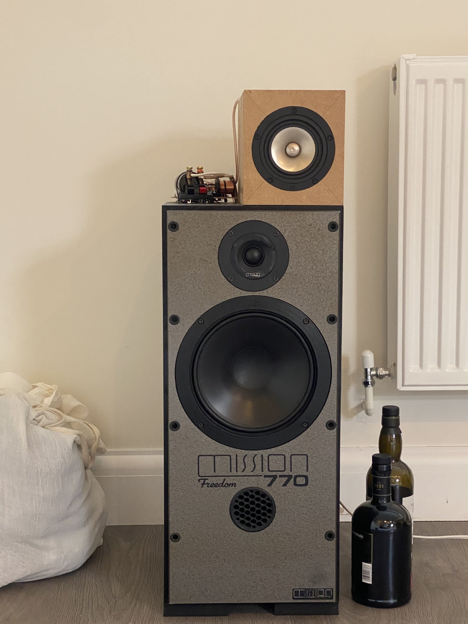

Anyhow, for now I've worked up a pair of 'prototypes' to test the WAW principle with the Pluiva and to play around with crossovers. I've just made the top part of the periscope and crossed it to my old pair of Mission 770 freedoms, which have okay low-end. Photos attached. I went for a 400hz XO (which maybe compensates for the planned distance between drivers better than a 500hz XO?), 2nd order butterworth (see screenshot).
They're sounding alright to me! Possibly a little 'boxy' in the mid range. But they're currently in a very poor sounding room, I think. My next step is to take them to a treated room in the recording studio I work at, compare them to studio monitors, and get some engineers' ears on them. If the basic concept is working well in those conditions, then I might go for a proper prototype using the bigger 12" driver and the 75L cabinet, depending on all the pending decisions above of course.
