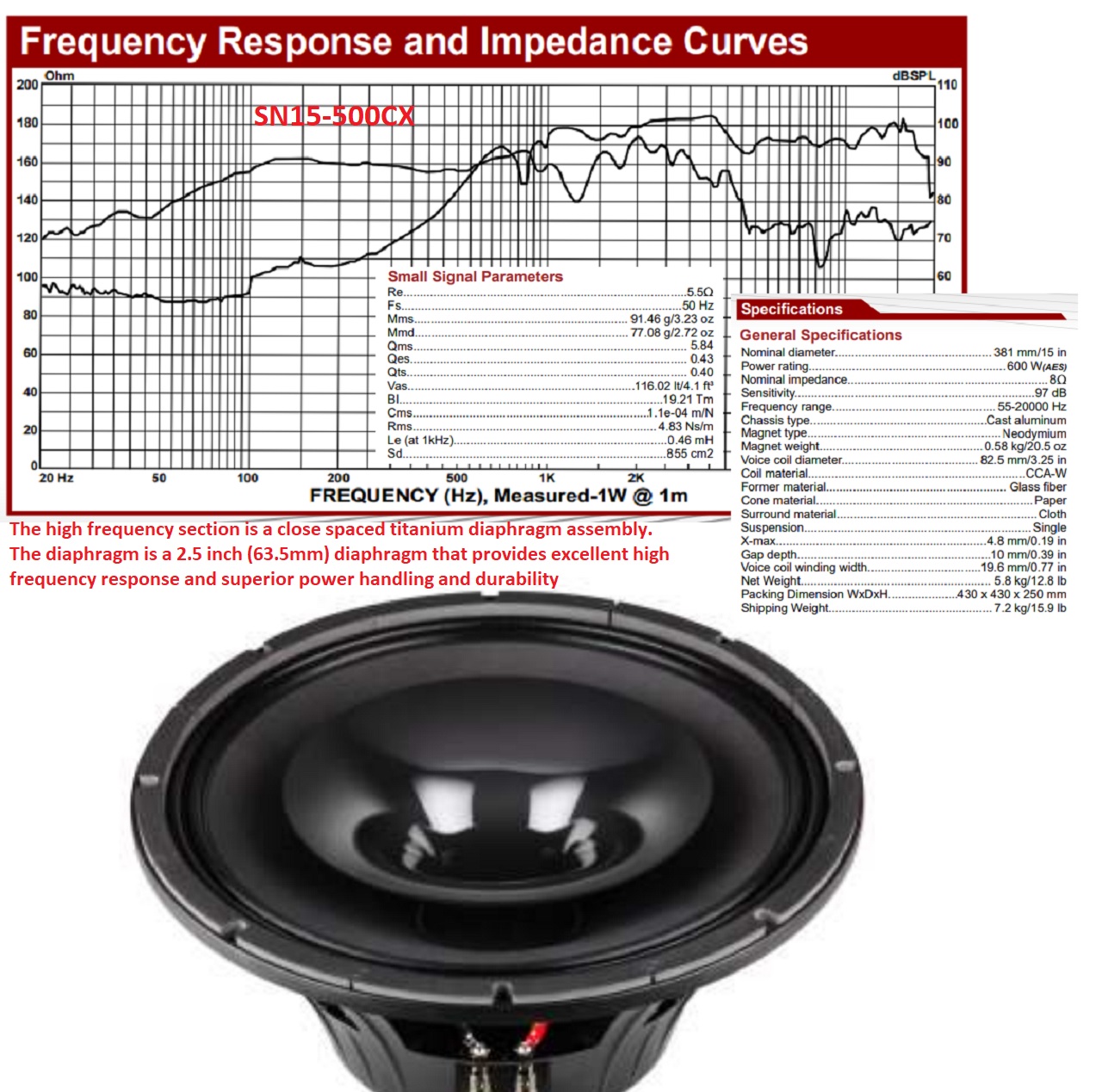

with the driver below, I think its large horn contributes to the 1K4 or so dip. That said, for $139.95 (originally $380) with compression driver at Loudspeakersplus, I'd give it a consideration. (assuming adequate driving power)

There are different quality or density to plastic horns I guess but I wasn't necessarily talking about the horn itself only but the overall design of the complete driver - Ive just seen bad reviews of these new P.Audios and it looks not very rugged like they used to be from casket to magnets etc. But I really have no idea so why not try, its not so expensive.
