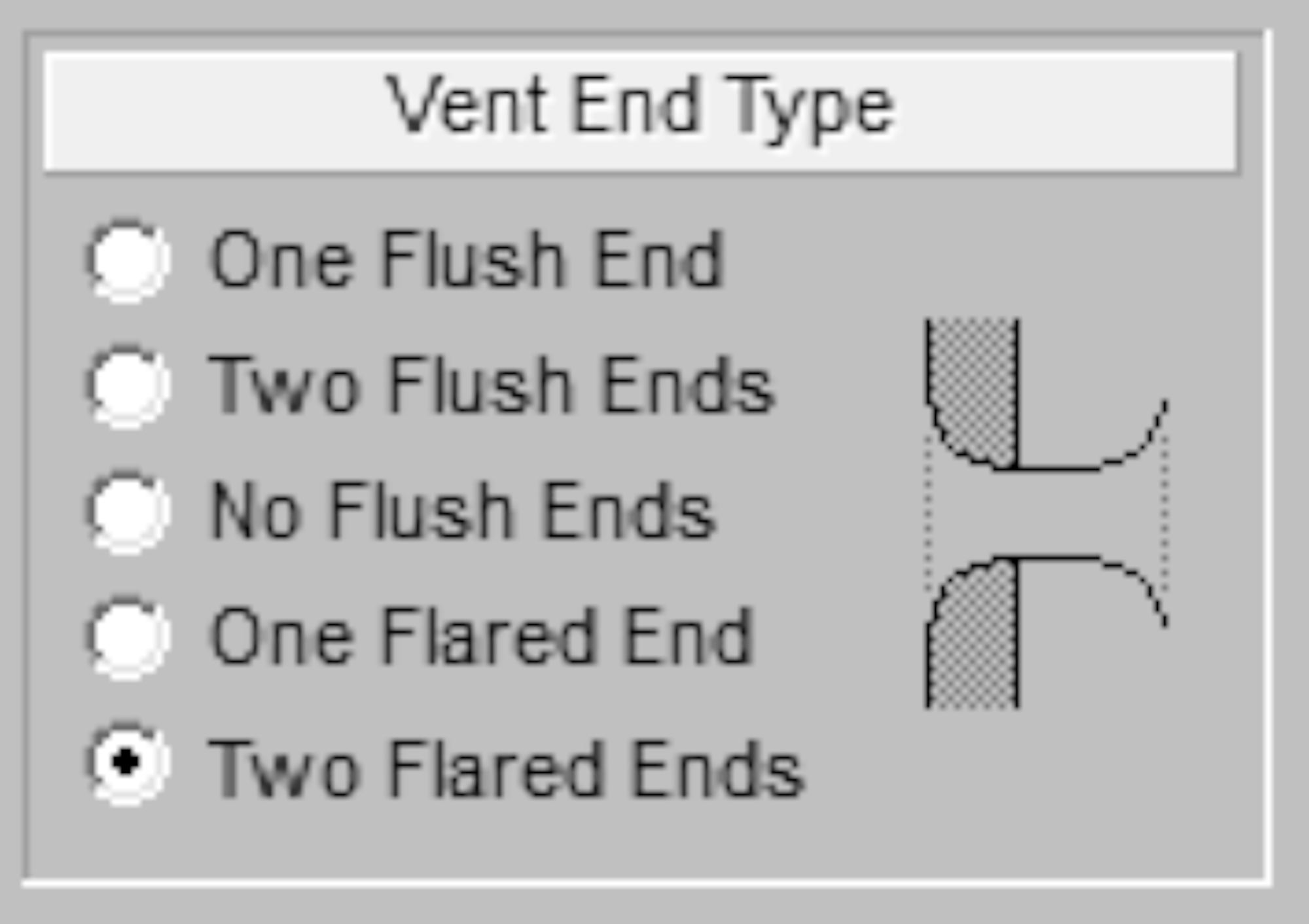

I've got myself a copy of BassBox 6 Pro
You're welcome!

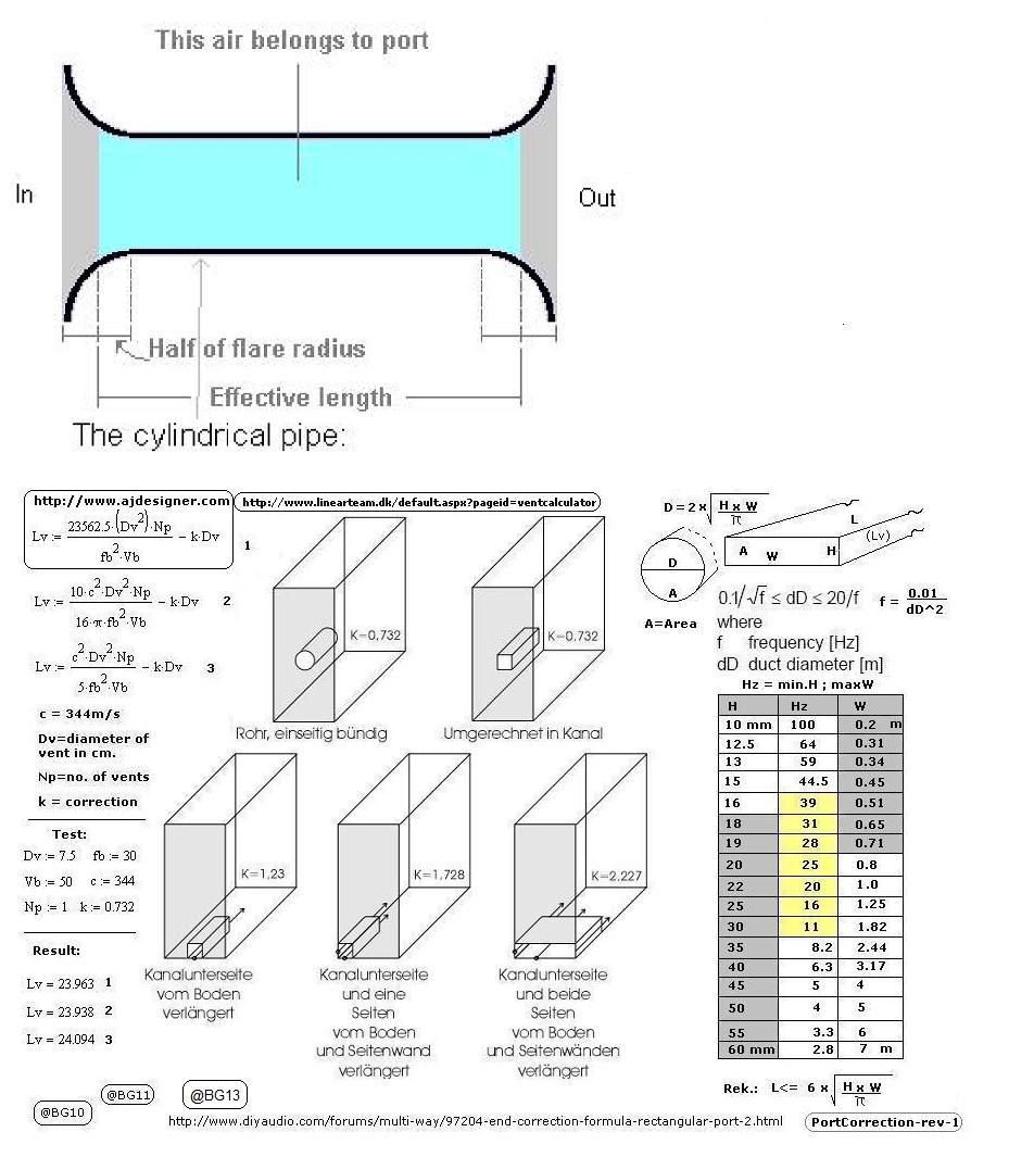

Not familiar with BB6Pro other than some folks have reported some accuracy issues.
Normally, what it's referring to is its end correction [K] with a flanged end [baffle mounted]/'free' inside = 0.732, the default for all programs AFAIK: https://www.diyaudio.com/forums/att...-dayton-port-length-effective-port-length-jpg
The beaming I was referring to (perhaps incorrectly) was related to how small the stereo imaging sweet spot was and how easily it collapsed by just shifting my head a foot or so to the left or right.
Quite correctly! Bad enough the drivers are rising on axis, but Tractrix further confines it, so once you can no longer see the full throat, you're way too far off axis and why pure WGs are much better if you can angle the horns to get a wide enough 'sweet' spot.
Not yet. But in the meantime I've got myself some nice new measuring microphone. 😀@OP did you get those celestions yet? The more I read about them the more I want it but would love to see some of axis measurement in free air.
You're welcome!
So going by the linked graphics the pictogram in the BB6P is wrong, right? Since it shows the length as measured from one end of the vent to the other. While in reality the length is supposed to be only to the middle section of the flare, right?
Correct, it's the mean diameter that sets length [-end correction].
