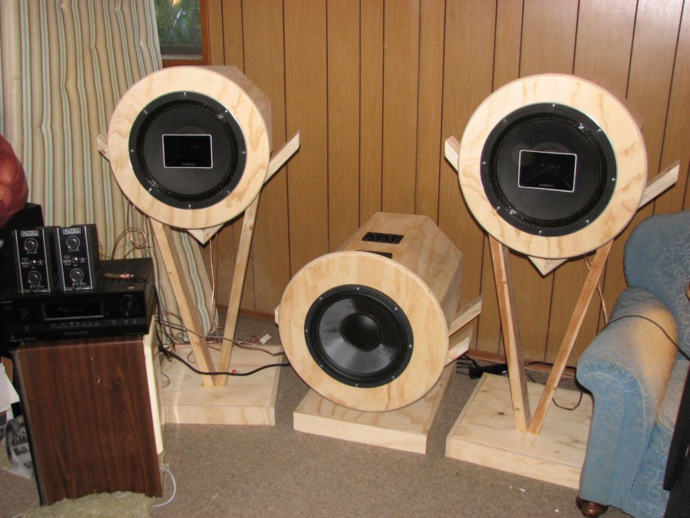

I have a feeling this might do what you need. It's the 604 8H with a helper woofer from CSS. It gives you just what you are describing as far as musical value. And, I agree with you, no matter how many things are 'wrong' about this set up, some of the so called 'better' speakers can't touch them.

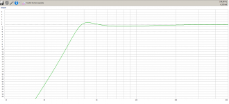

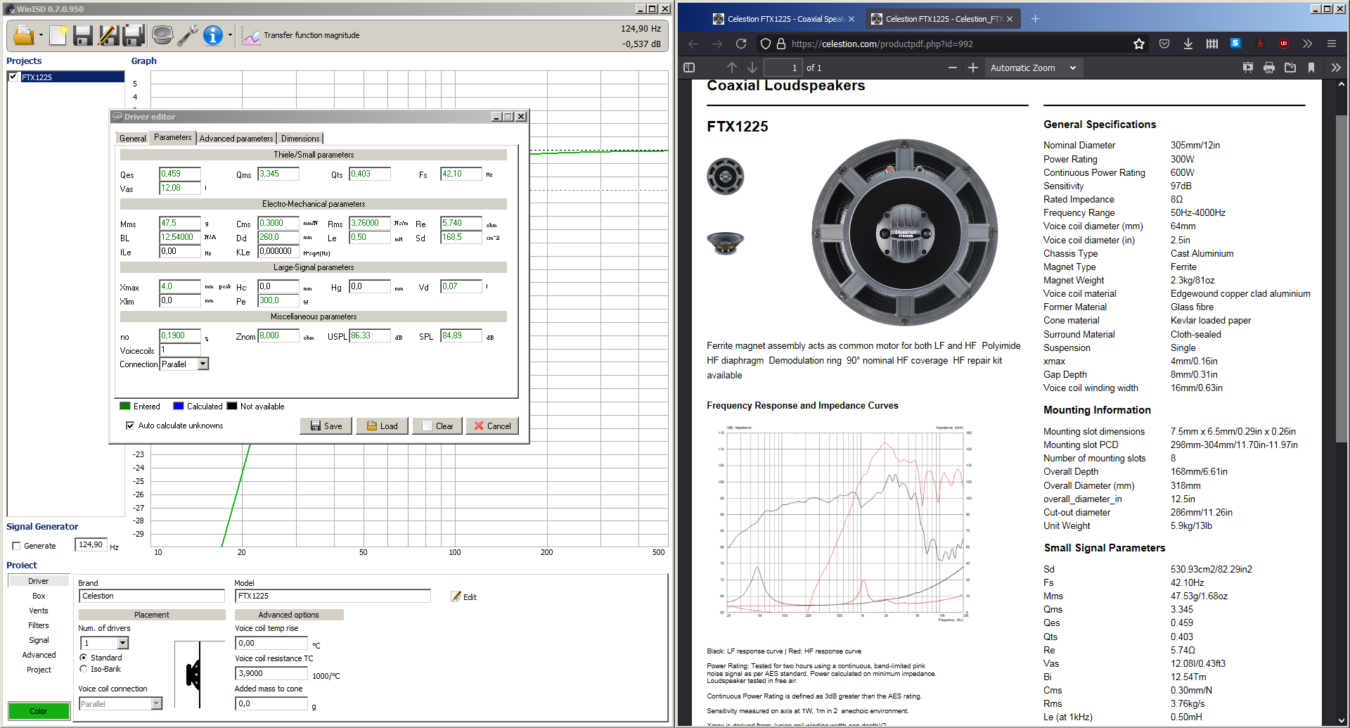

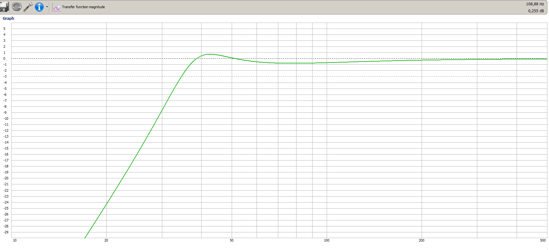

A bit under-damped for my tastes, but out away from walls it should be fine, though curious what specs you used now that I've loaded it in HR, so please post a screen shot of the WinISD driver's data.
Under damped? Shouldn't Qa=50 be fully lined cabinet and with Qa=25 I have some light stuffing inside?
Here. It's the same pre-made from loudspeakerdb like before but it checks out.

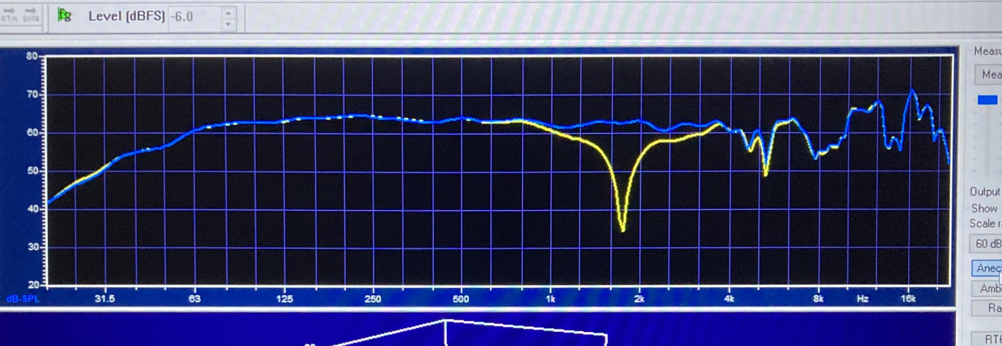

I would rather suffer the issues of a large coax than a small one. All small coax I've heard sounded shouty and never quite right - in the end the were annoying. But the small pro sound style coaxes have never convinced me.
YMMV
These do not annoy me:) Since this measurement, +10kHz been knocked down 8db
