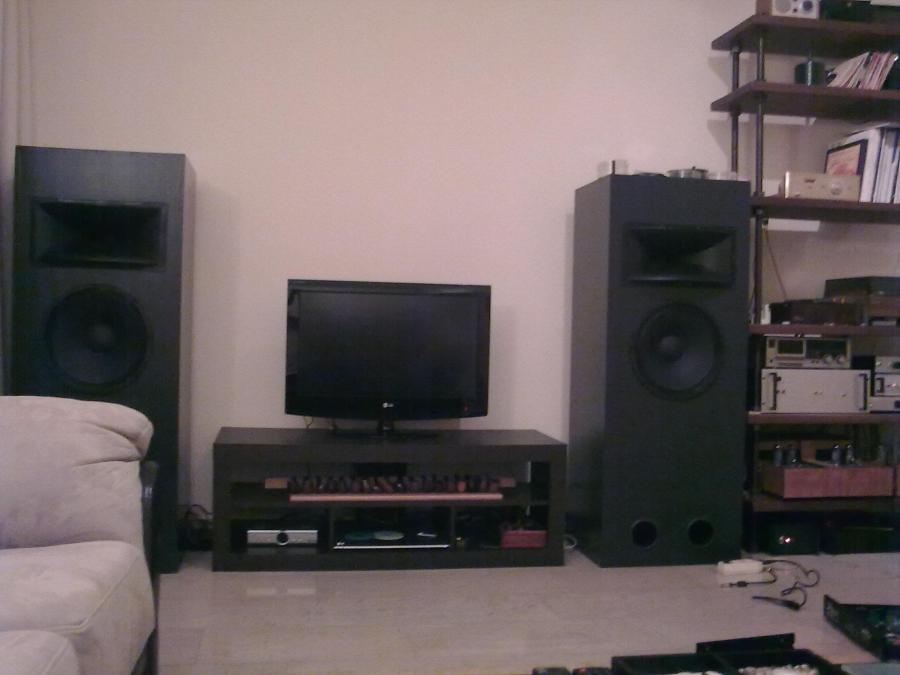

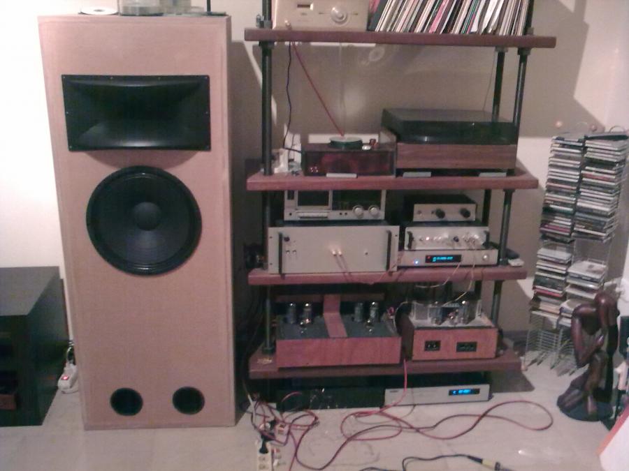

2 pics of my speakers:
heej npetrallis your links doesn't work.
the veritas look great. i have only my doubts about the mid. can it compare to the 2x10" woofers?

Sorry, i am attaching the photos again...

Thanks! now i can see them 😉 that are big speakers. kinda PA like. how do the preform in the living room? not to much/big ?

They also sound big 🙂 filling the living room perfectly.
Not very dependant of the room and giving an excellent "live" feeling.
The woofer is a real bargain, you can combine it with other mid-high frequency solutions.

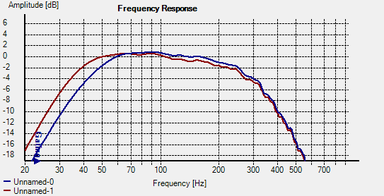

Peerless 830668 10"
I'm using the Peerless 830668 10" in a sealed 1.5cu feet cabinet. I like them a lot and I will say they are excellent value. I can't give you a valuable comparison with other setups but I think the specs speak for themselves in this case.
I use a 3-way active setup and crossover at 450Hz. The blue curve is a nearfield bass measurement that shows just how deep this woofer goes in my cabinet. The red curve is the response with an added shelving filter that I use for bass boost like a Linkwitz Transform. My Bass Boost sounds great at normal listening levels but produces big excursions at very high listening volumes on bass heavy material. That results in some distortion and on top of all windows shaking doesn't help the clarity of presentation. If you plan on playing really loud you may want to look into a 12". Adding a second woofer also adds unnecessary complications and at reasonable levels is really not needed.
